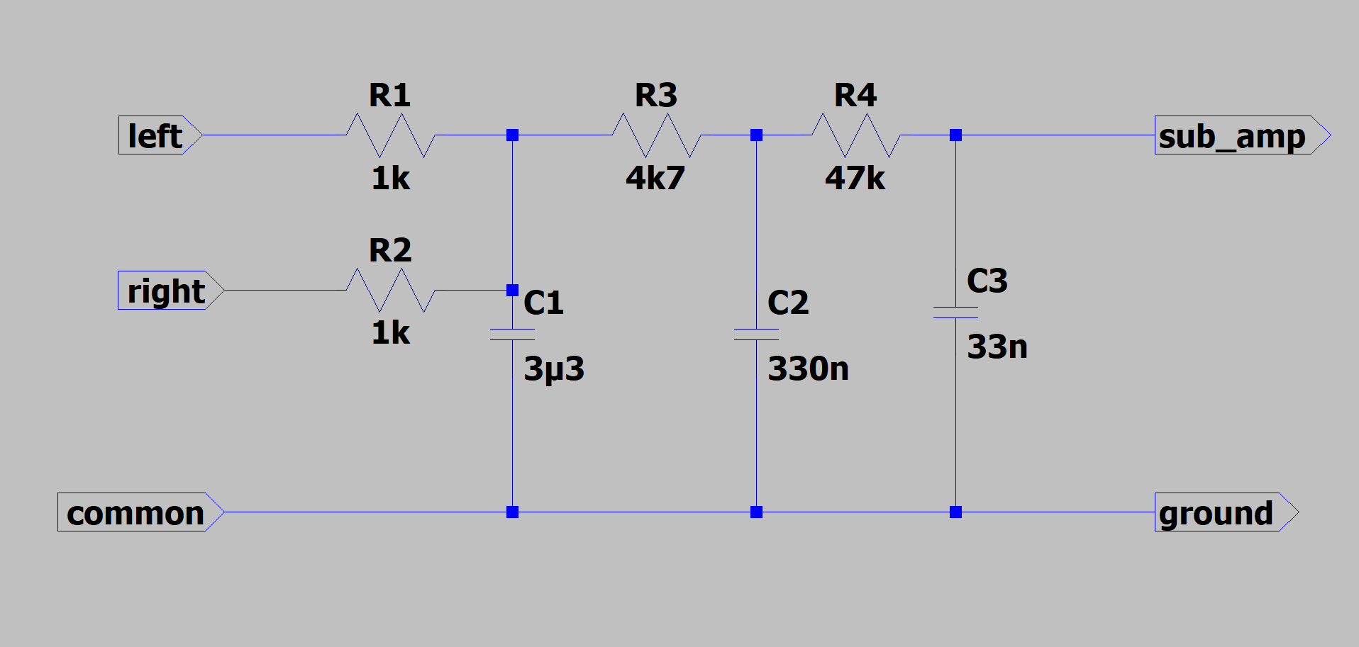

If your receiver has no preamp out, you can easily attenuate and mix speaker outs to drive a sub amp.

Two+ problems make a passive sub crossover a bad idea.
1. The sub requires a lot more gain than the rest of the band. So you would have to boost the bass big time. This is aggravated by the fact that woofers are not very efficient, so they need a lot more power and gain. This is the reverse of bi-amping, so for a 100W amp, most of the band is limited to about 10W.
2. Combining 2+ channels is a problem. If you could invert one channel, then you could run the sub in bridge mode. A 1:1 auto transformer can be used to invert one channel but transformers suitable for low frequency are huge.
3. Some people here seem to think a dual voice coil speaker looks like two resistors. No, it's more like two coils on a transformer. Connecting the two coils to two different channels is a bit better than shorting the amps together but not much better.
A summing sub filter is an easy DIY project, but you can buy them ready made, and such comes built into powered subs. If you want to build your own speaker but not the electronics, then an amp like the one in post#2 is the way to go. In the late 1960's I used about 4 resistors and 3 capacitors to make a filter from the speakers of mom's console stereo to a "Knight kit" tube amp that drove a sub that I built in high school. I wrapped it up in electrical tape with cables hanging out. It was something like, a pair of 1K resistors from each channel to a cap about 3.3uF, then a 4.7K to 0.33uF and finally 47K to 33nF and the sub amp (line) input. Each stage is 10x the impedance of the former so that you get a decent 18dB filter. You can change cap values to move the filter frequency, f=1/(2piRC).
