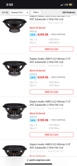

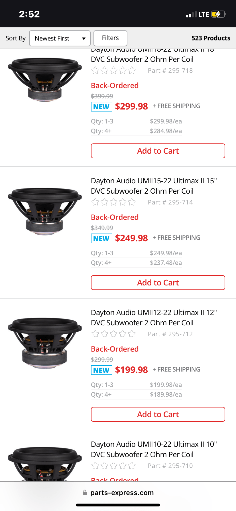

Old parameters: https://masori.de/products/ultimax-um18-22
fs is not everything. Dayton has stiffened the suspension (Vas: 212 --> 145 L) and made the cone lighter (mms: 655 --> 532 g). The motor strength has just decreased a little (BL: 23.8 --> 21.1 Tm).
Try modelling woofers with the different sets of TS parameters, to see how much the sound output really changes. Measure the parameters of your own woofer and model that one as well.

I recently fell over these data, because I had the old ones in my simulation. The new UM18-22 is a completely different driver.
Like they made the magnet gap an inch wide in the later production. The new one is on the "don't use it vented and closed only for a boom-boom system" list.
They practically made a very interesting driver a useless heap of metall. An 18" with TSP of 0.70 and an Fs in the 30's is a faulty construction with such a huge mms.
Sure, it will still move a lot of air, but not in a way someone would want it to. Did I get something wrong?

I had this chassis on the list for a project. About 5dB less in a critical region, aside from the mentioned "doesn't work for vented" problem.
Well I've bought two of these at $700aud each. Originally not knowing about the spec changes. Funnily enough, the website even still lists the old specs. So I prob have a case for refunds etc, lot of stuffing around getting it back to them though.
