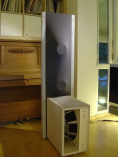

In lieu of the other question on this board about the same unit in a closed box. I was curious if this driver was suitable in a dipole box. Actively driven with a sub amp.
Something like in the attached pictures.

I mean, I'm not a fan of large xmas, I think that has plenty. Large excursion means distortion to me and lots of EQ and power. I think there are better ways ie, surface area, frame type and positioning. I have U frames myself but would be interested to know how that type you picture (what would you like to call them??😉) perform
I think they are called dipoles? Not sure 🙂

Yes it is a dipole, but different frame shapes have different names and some names vary Subwoofer Origami
It looks most like a ripole with a single driver. Not a clear name browsing through the subwoofer origami
It does, though I think they have less space behind the cone, to such an extent that a hole is made for the magnet. Also, big advantage to use two drivers opposing each other to cancel cabinet vibrations, it works, I've experimented with something similar.
I'd probably call what you have there an N frame (almost!)
