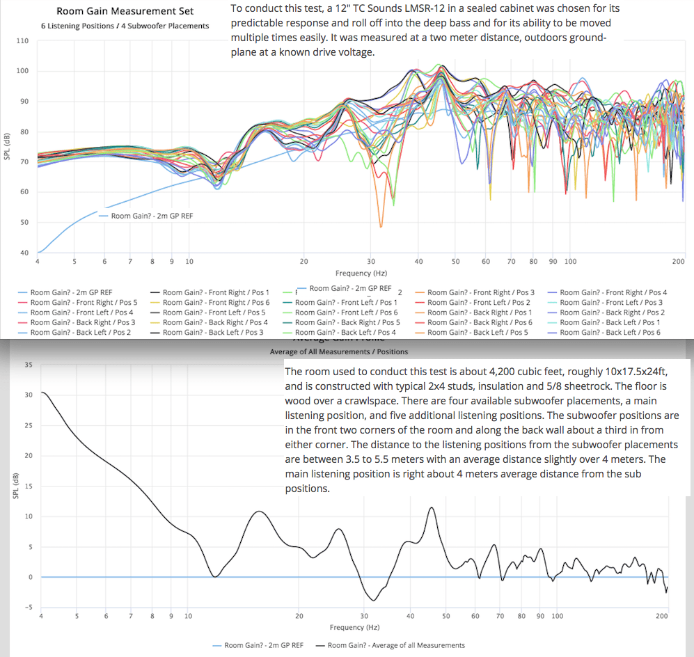

Coincidentally, in Josh Ricci's "Room Gain?" tests, a frequency range near your "low enough" suffered losses as much as -30dB compared to the outdoor 2meter reference (blue line starting at -40dB@4Hz:25-30hz would also be low enough, as I mostly listen to music and don't want to encourage unnecessary infrasonic resonances, so I'd probably roll it off sharply below there.
https://data-bass.com/#/articles/5cb5fb285389a80004c7e58a?_k=ebqbeu
Adding a second subwoofer may result in more than a 6dB gain at the listening position at some frequencies and a loss at others, depending on the room dimensions, sub placement, and listening position.Actually 105dB could work out nicely. It looks like I can get 102dB at 1m at 25hz from a single Fab12 at Xmax. So a pair should be at least +3db=105db.
Since the room response may result in gain at various low frequencies and loss at others, very easy to find response can sound half/twice as loud over a small position change.As Art pointed out recently in another thread, we perceive things a bit differently at low frequency; IIRC only 5dB can sound like half/twice as loud down there so -10dB would have sounded like a substantial loss. (EDIT: though would have been offset to some degree by room gain)
Art
Thank you, Art. Gosh that -30dB is huge! In a small room, it certainly puts distance attenuation into perspective. Thank you.Coincidentally, in Josh Ricci's "Room Gain?" tests, a frequency range near your "low enough" suffered losses as much as -30dB compared to the outdoor 2meter reference (blue line starting at -40dB@4Hz:
Art

Take care.. look at the plot shown in #6. The lower region is approximately 18dB/oct, whereas room gain is theoretically 12. What you might have there is a helmholz resonance, which would drop back to nothing towards zero Hz because it isn't sealed.. as explained here..so instead to trying to calculate I've tended to tentitively apply figures gleaned from tables for room size and gain at different frequencies.
There is no "room gain" because there isn't any in a real room. A car has a very low mode, a sort of Helmholtz resonance which is a factor in a small car, but even that vanishes in a van. In any room in a home there is no "room gain" so if REW has this then its wrong. But I seriously doubt that he would make that mistake. It's a myth and experts know this.
Very useful, thanks again Allen. And thank you for putting it so kindly, too. I've heard room gain stated as a fact since quite early days in my audio hobby (probably from around when the internet started to host forums and websites). So it is upsetting to realise that I've been naive about the effect for this long; I'll no doubt have perpetuated it several times over the years myself..
Though it is also quite easy to accept, since I've rarely been able to measure (in my own rooms) the amount of room gain that was supposedly expected. To be fair there often was less attenuation due to distance than expected, so an apparent net gain. But I now realise this would simply have been unevenness from room modes.
Getting back to room modes then...
Looking at Art's chart, there is (to my eye) a trend that follows the outdoor reference over my intended frequency range (and above), it really only loses correlation towards infrasonic frequencies, outside of my range. The correlation is quite sloppy because the modes are so big that they clearly dominate, but smoothing from multiple subs would presumably also bring things somewhat closer to the trend. Whether distance-related attenuation would then be (relatively) more apparent I don't know, but I'd guess perhaps not by 'very' much because of the distributed nature of the subwoofers. There would also be one or two more of them to somewhat increase available SPL, and one or more might also be placed closer to the listening position.
So I think this means I'm still content with the SPL available from my chosen drivers, albeit for slightly different reasons. I'm also happier with their (12") size; they look good but seemed quite modestly sized (for subwoofers), but now I'm envisioning multiples, any larger would seem excessive for my requirements.
