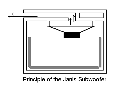

Interesting analysis of subwoofer requirements for matching electrostatic loudspeaker "speed"... 😀
I've lived for 20+ years with a pair of the original MartinLogan CLS (Curvilinear Line Source) full-range electostatic loudspeaker (MartinLogan | CLS) and the best subwoofer complement that I found was the Janis W1 + Janis Interphase crossover+power-amplifier. A large part of the reason why the Janis W1 was able to present bass frequencies with a similar sonic "speed" characteristic to that of the MartinLogan CLS was the fact that the Janis W1 was a slot-loaded woofer (see attached diagram), which magnifies the effective velocity of the woofer output by the ratio of the woofer surface area divided by the area of the subwoofer slot (see Nelson Pass's slot-loaded subwoofer project The Slot Loaded Open Baffle Project Article By Nelson Pass). Nelson Pass's slot-loaded open-baffle subwoofer design has the additional advantage of eliminating the inherent resonances of the enclosed cabinet of the Janis W1. Wicked cool work by Mr. Pass... 😎
The Nelson Pass slot-loaded subwoofer is very amenable to DIY construction (some MDF and simple power-tools), so you could experiment with tailoring an implementation to your specific needs. 😉

That looks a lot like the DeathBox from Decware. It's even 'tunable'.
I'm using one right now until my other big ones are done.
Amazing what it puts out, have been using it for some years now.
It is "fast" but SQ isn't high in my opinion. But this can be because of the low budget drivers (that I've put in isobaric configuration).
Apparently the DBII has a lot more SQ to it. (no experience with it)

True, the speed-of-sound is consistent in a given room, but that's not what we're talking about... 😉
The "sonic" speed of the subwoofer is critical when attempting to assemble a full-range audio system employing single-panel electrostatic loudspeakers. Enclosure resonances in a subwoofer (which are absent in open-baffle dipole electronstatic loudspeaker) can be very quickly identified within this context; the sonic footprint of a subwoofer enclosure presents a very different ("slower") sonic characteristic from that of the electronstatic panels interfacing with the listening room. The slot-loaded Janis W1 12-inch woofer fires into a 2"x12" slot and the pressure generated flows out the front through a horizontal slot. The rear wave of the woofers is dissipated/absorbed within the enclosure.
The purpose here, as with an AMT (air-motion transformer) driver, is to have the air velocity at the output to be much faster than the velocity at the driving surface, in this case the subwoofer cone.
The motional energy imparted to the moving air is proportional to the mass of the air times the velocity squared. The "squared" part means that if you increase the velocity of the moving air by forcing the moving air through a slot that is less than the surface-area of the driver. This raises the efficiency of the speaker quite a bit, and it improves the transient response as the apparent mass of the air moved is higher in relation to the cone mass of the drivers (hence, the effective "speed" of the subwoofer rises accordingly).
The way this is accomplished is by "squeezing" the air through an opening narrower than the surface of the moving diaphragm of the driver. The air pushed by the cone has to exit out the front of the loudspeaker through a slot opening whose surface area is only about one third that of the cone driver, and so it goes out about two-to-three times faster than the velocity of the cone.
