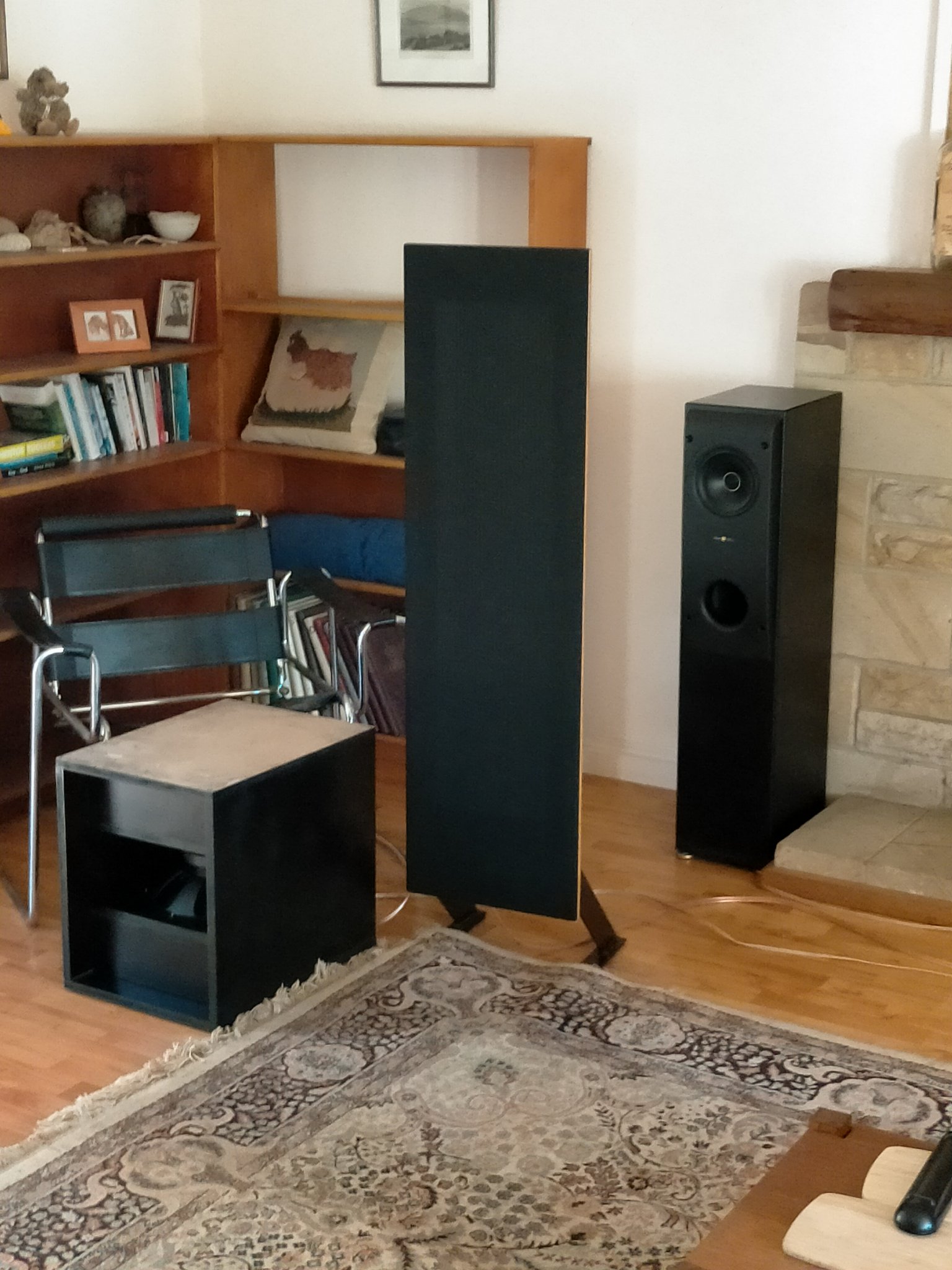

I built a pair of Dipole Woofer 3's slightly modified (not in dimensions) for ease of construction and practical shape/finish/use. Cutting sheet for 18mm MDF 2400x1200 and construction photos available by email.
They are yet to have top veneer and grill cloth frames but photo shows neat size (KEFs in background are retired). They use a pair of 12" OB woofers (BIANCO-120B150) per channel. Very inexpensive approximately $500US all up including materials.

I think I'd flip those woofers 90 degrees so the cones aren't sagging. And, ultimately, you'd want to high-pass the main speakers to reduce their workload and improve distortion.
I'd shoot for a 80Hz symmetrical crossover between the two. I've had my MMG/Linkwitz setup like this for many years.
Also, that wagner filter doesn't have the proper equalization for those Linkwitz woofers.

Thanks for your feedback.
Yes I'd like to highpass the Maggies but had to can the decision. I'm using a Schiit Freya+ and a pair of Vidars with balanced connections. To get an active filter using balanced connections to go in between would cost thousands. I'm not capable of designing my own but could build it. I suppose I could do two pairs of passive filters in front of the LRS's and subwoofers.
The boxes were rotated so I could have the base plate rather than side removable for driver installation and it is a more room friendly shape (occasional coffee tables or seats!) I ran the design past the SB Audience Marketing Manager and he didn't have any concerns, and as many (KEF) brands have floor firing subs thought it wouldn't be an issue.

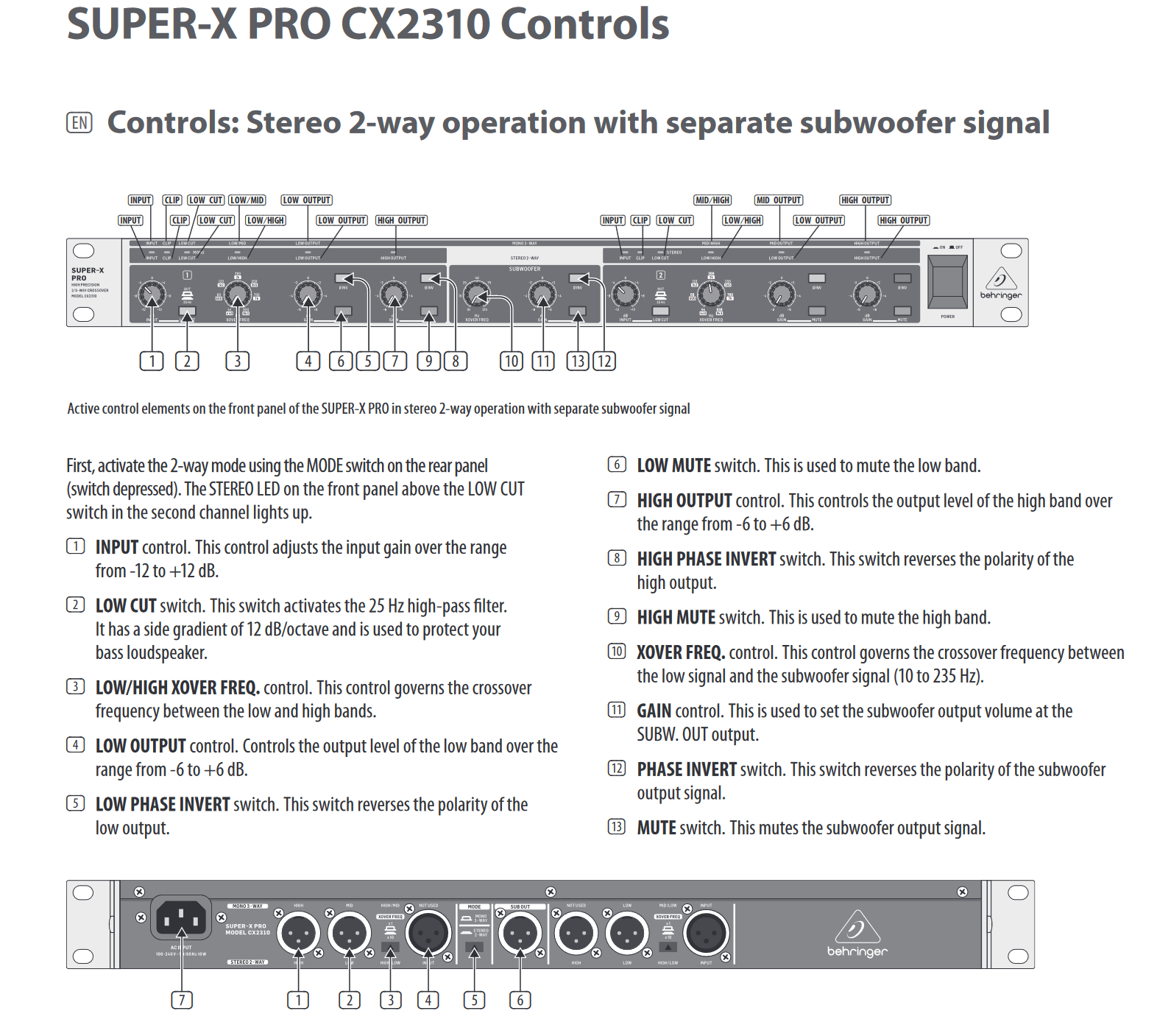

Nice. Linkwitz-Riley filters with 24 dB/octave:
Yes I'd like to highpass the Maggies ...... to get an active filter using balanced connections to go in between would cost ....
$109 on sale. 😵
That Behringer is a good choice vs. some others I checked out before going with the Marchand XM9. I looked at the Behringer's schematic and it also uses the state-variable 24dB/oct filter topology as the Marchand. And it's just an L-R, 4th-order 24dB/oct. Period. No 12 or 18dB so there's no phase shift happening at the xover freq. They kept it simple. It uses 1% resistors which is very good. It has a +/- 15V split supply for the op amps - also smart. It does use old op-amps having high DC residual output voltage up to 6mV so unfortunately there are five electrolytic caps in each Hi and Lo signal path leg there for inter-stage DC blocking. The Marchand is nice b/c the standard op amps used have low DC offset so no coupling caps at all, plus they are faster and much lower noise. They are all mounted in 8-pin DIP sockets so you can roll other op amps - which I did, several times over the years whenever I learned of a new favorite type. I had Phil not include the standard XM9 switching supply and installed an Acopian +/-15V linear. I had a few other changes to his original design for which I sent him parts. IOW, my XM9 is customized and pricey but the goal was transparency = the rest of the chain, if possible.
All in all the Behringer looks decent. Hard to believe the price!
