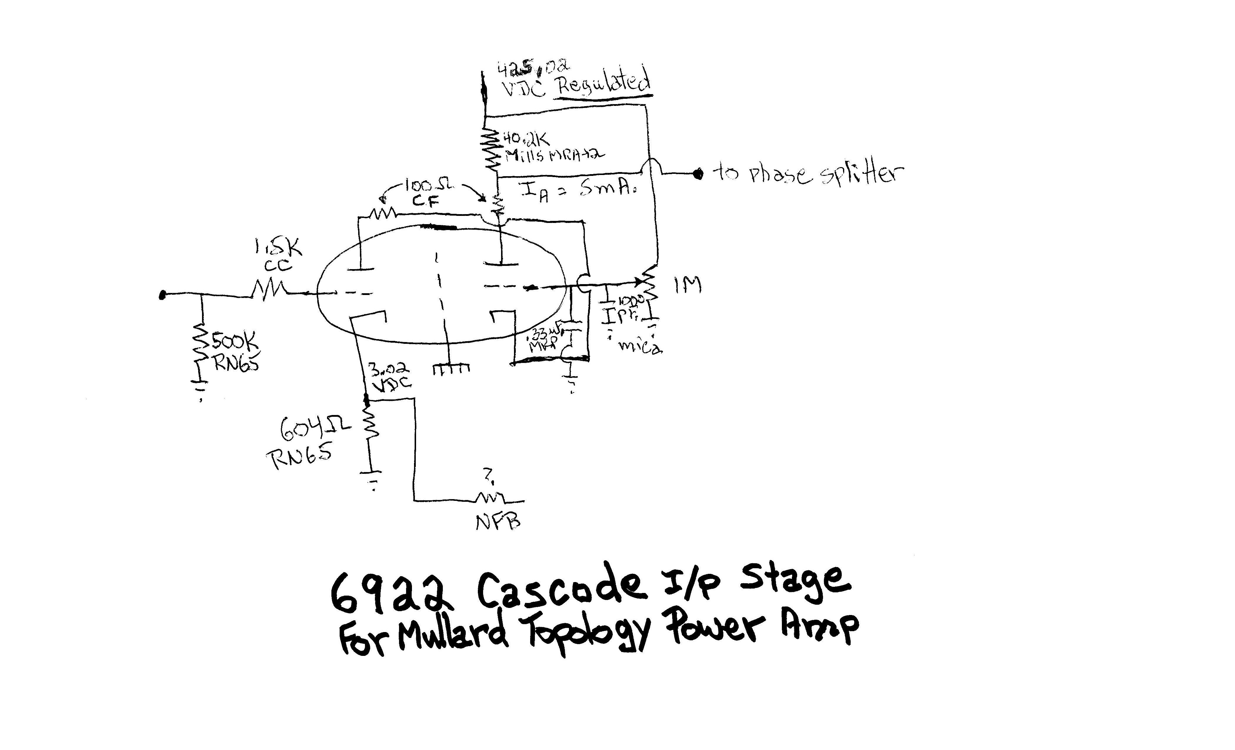

A specific situation where I would favor a ferrite bead over a carbon composition resistor is at the grid of a cascode's "upper" triode. That grid is supposed to be at AC ground. Cement a tiny bead that surrounds, but doesn't touch, the grid's socket lug, to the socket body.
I've posted, on several occasions, a 6922 cascode voltage gain block, with paralleled caps. (1 RF and 1 audio) forming the "upper" grid connection to ground. Add the ferrite bead, if the caps. fail to suppress parasitic oscillation.

Funnily enough a 6DJ8 cascode is the input stage of this amp - the lower grid does in fact have a stopper (though not marked on the schematic but found in the real implementation), but the upper grid has no stopper with a pretty long lead.

For Ss/Gs, I'm again uploading my "hen scratch" 6922 cascode schematic.
