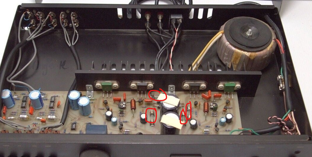

Thank you for your reply, I have already the schematic but can't find the bias setting that I've heard is very high.Maybe this schematic will help:

Mick, would you be able to explain how the bias is adjusted on this amp? I have one but am not familiar with the process.
To set the bias current you need to either break the power supply circuit to each channel and insert an ammeter in series, or use a suitable low value resistor and measure the volt drop across tht and calculate the required volt drop using ohms law.
The circuit shows no suitable resistors are used and breaking the circuit, while easy, isn't for the inexperienced.
I see 4 fuses on the board. These could be supply rail fuses and if so then you could remove one per channel and insert a meter in its place or better still (safer for the amp) replace the fuse with a 1 ohm resistor and then measure the volt drop across that resistor and set the bias accordingly.
You would have to look what each fuse does. Are they DC rail fuses (which is what you want) or are they from the transformer to the rectifier (no good) or speaker fuses (no good). If DC rail fuses then they would go to the Drain of one of the FET's in one of the channels. Two fuses per channel, one for plus and one for minus rail. If its like that its easy to do.
If rail fuses you would have to turn the bias to zero on each channel, note the current flowing (using ohms law and the test 1 ohm resistor) and then add 100 ma to it.
If the fuses are shared and one fuse protects the plus rail to both channels (and same for the minus rail) then its still easily doable.
Identify what the fuses do and go from there.
