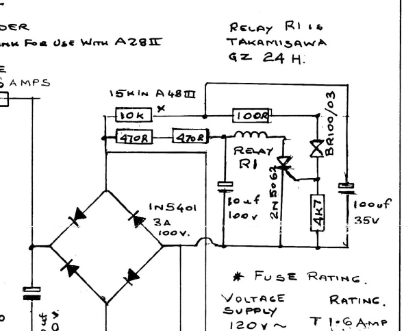

I have a Sugden A28 II amp. (external heat sink on the back). I know nothing about amplifiers. I bought it new about 30 odd years ago. I really like the amp, but it has some issues. I was hoping to get some insight/advice from the learned members.
Problems:
1) When I turn the amp on, I get a loud "whooomp" sound from the speakers. (Vandersteen 3C signatures, if that matters) Am I damaging my speakers? What can i do to eliminate that sound???
2) I get a crackling noise as i turn the volume knob.....only while moving the knob.
3) Turn the selector knob to aux (where I have the CD player) CD player off. Tuner on......turn up volume...you can faintly hear the tuner. Not a problem, just wondering if that indicates an issue that should be fixed.
4) At thirty plus years old, should I replace anything in the amp while I have it into the shop to address the above issues? ( i have been reading people in the forum who talk about replacing capacitors and such)
Any advice/insight most appreciated. I want to have some idea what i am talking about when I take the unit in for repair.

It is single-supply all the way through. It is sure to WHOOOMP at turn-on. There is a disconnect relay to the speaker but I *think* this is to mute the turn-OFF thump (so maybe it is worse, except muted).
I would however beware using any small/soft-woofer loudspeakers unless I could see how far the cones are moving at turn-on. Many old speakers were hefty and stiff, were not troubled by turn-on thump.
Old pots scratch. Normal.
Simple selector switches WILL bleed unselected inputs. Basic physics. D.Self has several advanced switching systems to reduce bleed-over. The usual no-cost "fix" was to turn-off unused tuners, CDs, TVs, etc.
Those Vandersteens are eXpensive?? I would seriously consider a fresher more-polite amplifier just to protect the speaker investment.

Going by symptoms 1) and 2), it sounds like the amp could use a recapping. The coupling cap at the volume pot is likely to be leaky, and more of them may be dried out, throwing off the time constants that would be keeping the amp from emitting too much of a turn-on thump. If there is a relay I would imagine that the turn-on delay has gone to zero.
The 100µ/35V would be my #1 suspect. The triac (2N5062) might also be shorted.
Just let us know if you need help picking replacement caps. I hope this amp isn't full of axials.

I owned the same Amp, sold it 1 year ago.
Before, I replace all electrolytic caps, 30 year old !
Read carefully previous caps specs (ESR/RDS), voltage, pitch, height,...
Another point to take care concerns the PCB itself, very thin tracks that could be damaged by overheating.
Alps pot need some magical flux and back to work silently, no more crackles.
Front source selector squared buttons are pushing onboard switches.
Those switches need some "grease", they are heat sensible too 🙂
