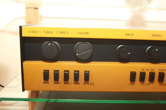

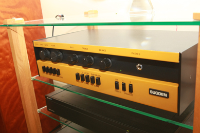

Hi Michel, yes a schematic would be brilliant! The finished amp looks like this, with third party buttons. I guessed the DC offset from an A48 schematic (not ideal!).
The front was hard, but a Rotring stencil on matt primer followed by clear lacquer seemed to work! I missed out the A88 bit though! The new PSU caps are a bit oversized, but it is what I had left over from another project. I used elna for the pre, and some Nichicon for the power amp. It sounds really great, but a bit modern for the vintage! I'm working on a very old sugden preamp now, and I think that vishay sprague capacitors suit the original sound better. I'd be happy to buy genuine buttons, but the nextel coating tends to go all gloopy with time?
My teenagers are so keen on the amp they have temporarily stolen it for the bass, despite the slightly more modern sound! Shall I post my email address here for the schematic?

I am restoring my A88 after 30 years of owning it from new and refinishing the case is included in the overhaul.
My restored Sugden A88
I have restored my Sugden A88. It has to be the best one left operating on a daily basis – unless you know better? See it here:

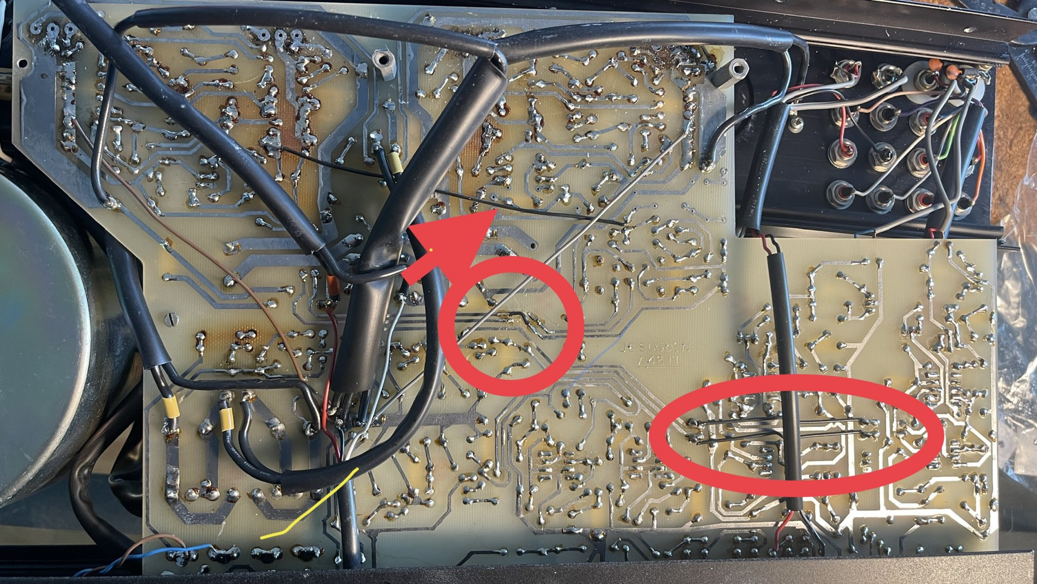

Sugden a48mk3
Hi Michel, Mario from Montreal here
Sorry to highjack this thread although I think it could help others. I just wanted to catch you in a more recent venue. I have read many times the 10 pages thread on Sudden P28 etc… Good man.
I’m not a technician, but I rebuilt an entire 303 (with instructions)
But this is about the Sudden a48mk3 and I have the schematics, which I can't read fast.
Purchased it used and it seemed fine, recognized the Sudden sound which I seek, but set up wouldn’t allow image evaluation. At home I still enjoyed it but at critical listening, not much of an image… Right side of heatsink is hotter (not much), left side is cold. I dig in to measure voltage at 4.7k pot, got some on right Chanel, nothing on left. Idle current on fuse holders (w/o fuse) shows about 200, adjustable with pot 220k, but left Chanel starts at about 100ma and fall to 60ma before stabilizing.
I get a short between heatsink and left 2sb776 metal plate. I got all output transistors out and all tested fine. I got them back in and destroyed them all but one. Smoke! (yes, isolator pads where the milky type after all). I ordered those 896/776 from eBay, (fingers crossed) https://www.ebay.ca/itm/383630556261asI spent a day searching for replacements for these to no definite avail. Anyone found replacements for those in this day in age?
I also ordered:
2- BD140
4- BD139g
4- BC549b (in case)
2- 470uf 10v
2- 470uf 25v
2- 220uf 100v
(RUBYCON)
AND mica pads
BUT HERE IS WHAT I NEED (Ithink)
Looking at the print side, I suspect signal was redirected (in mono?) to be driven by the right side amplifier, in order to sell the unit (I’m not calling him back)…. Some suspicious black wiring and one print cut off job can be seen on my picture.
Now I could spend days to years figuring out the circuit and fix this, or maybe you could help.
I also call to any member who could just happen to have a pic of the a48mk3 print side which would put me out of my misery in no time. I have one for the a28, but that doesn’t help me
Thank you for any help (je suis prêt a te dedomager)

After further investigation…
1- the stereo/bridge mono switch was on bridge mono (please tell me that’s not it)… would that allow sound coming from both speakers if connected normally, but cutting voltage on the left amp at the measuring point?… and give 60ma to the idle current on left?
2-the two bottom right parallel wires (photo) are connected on the right to two resistors of which ends are not connected to anything else. Seems in the original design
3- For similar reasons, the top long wire and the lifted two tracks with a small z shape wire seem legit as well.
still would like confirmation
looks like left 2sd776 was short, and switching to bridge mode magically made the amp play on left so it could be sold (?) Or it was acquired from a bridge mono set up and everybody was ignorant of that fact… ? I would really appreciate your help on this before I install components and fire it up.
cheers to everyone
