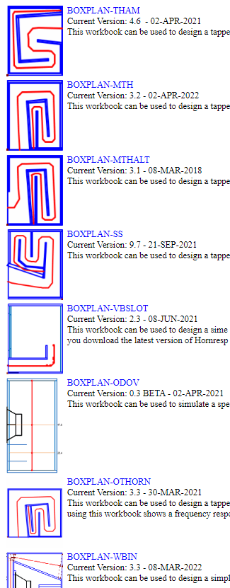

Ok, the site below maintained by LORDSANSUI have many many "cookbooks" in the form of parametric CAD designer templates where you can export the data to HORNRESP and model the 3D view of your cabinet inside FREECAD. it have a little bit of a steep learning curve, but once you get the hang of it
you will feel home.
https://freeloudspeakerplan.rf.gd/
another similar aproach is Brian Steele tempates also
see the site below.
https://www.diysubwoofers.org/sheets/

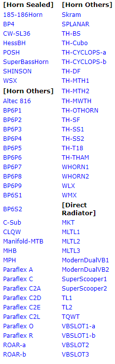

I probably should have mentioned that I've been using Lord Sansui's website. So far I have gotten the best results with the MTB Manifold, C-sub and Splanar designs. The problem I have is that I don't know whether a design is only a few tweaks away from being ideal, or if it not the kind of design that will suit my woofer, regardless of how I tweak the original design. I was hoping someone mya be abke to look at the specs and say "that looks like a good fit for design x".Ok, the site below maintained by LORDSANSUI have many many "cookbooks" in the form of parametric CAD designer templates where you can export the data to HORNRESP and model the 3D view of your cabinet inside FREECAD. it have a little bit of a steep learning curve, but once you get the hang of it

Unfortunately there is no best fit design for a driver. You can adjust all designs to a particular driver.
Other than the conventional law statement pick 2 from 3 I would suggest:
If you need more output and can accept narrow bandwidth you go for high order designs. They will achieve the range from 40Hz to 120hz.
If you need wider bandwidth go for direct radiator and its variant.
If you wanna a trade of from both, go Sealed Chamber with Horn.
Some designs might give you flatter response then others.
As you saw with MTD-Manifold, some designs are easier to build them others, access panel is not something I like but maybe others like. In this sense you can count with FreeCAD how many panels a particular design have.
Some designs waste more internal space them others, panels, folding, bracing and so on, so acoustically you have less real volume to use.
If your driver is old and the cone is not reinforced, avoid use high compression ratio on it if the design you choose have this indication. It may reduces life or increase distortion.
