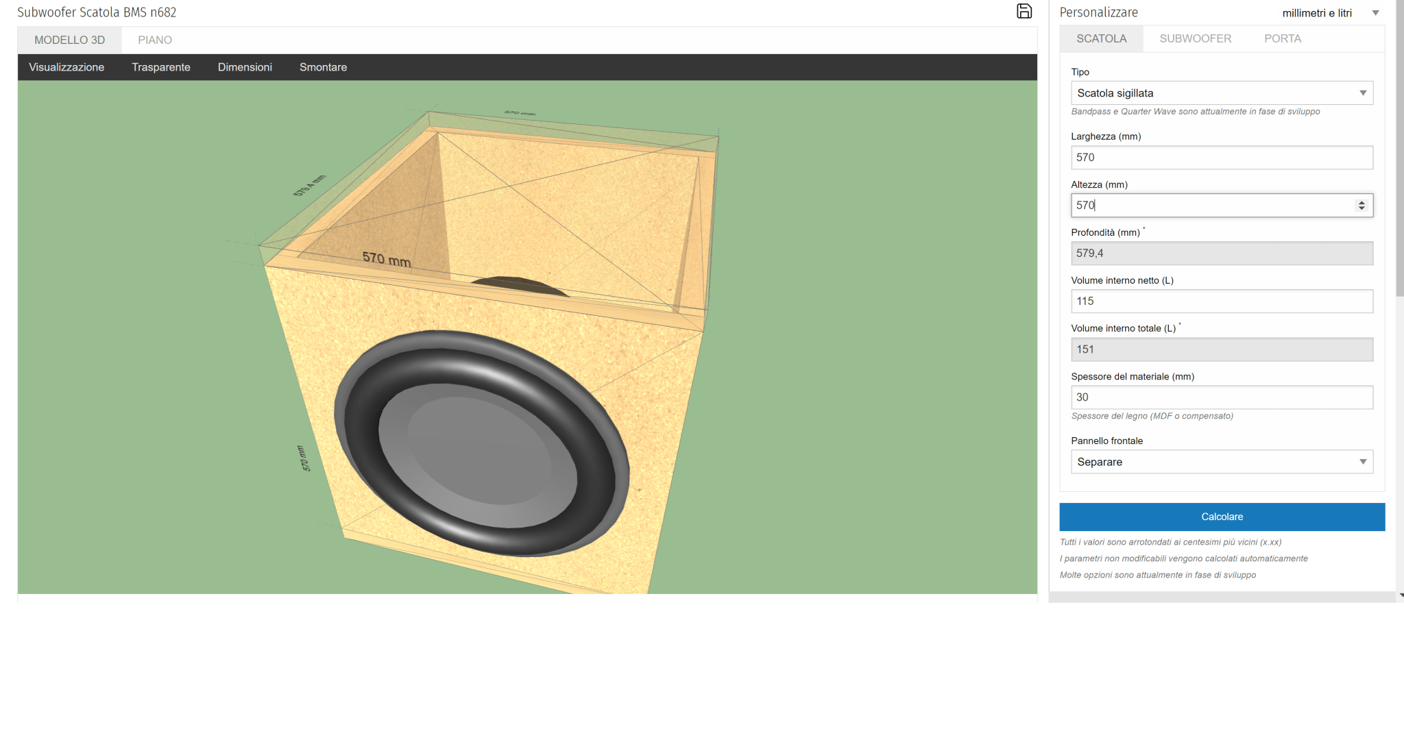

What did you individually calculate adds 30 liters to the net volume to equal 130 gross?100 liters net will be about 130 gross.

My bet is the volume of the exterior box walls and of the baffle is close to 30L.

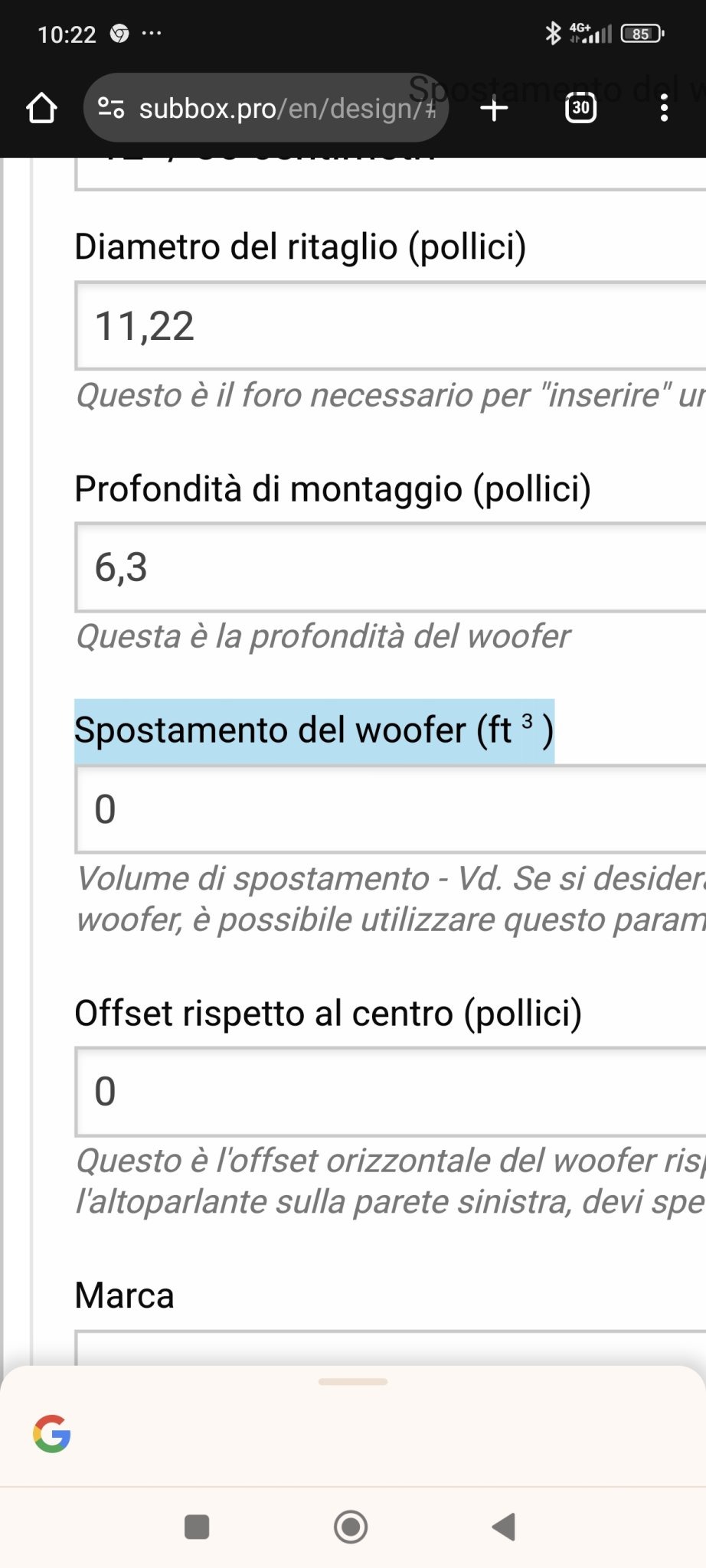

you are right. It is not bassbox, but subbox.pro online. Since I am not an expert I think I messed up a bit. There is an entry to add in the program that calculates the volume of the driver. But I do not know where to get it. I report the wording:Non ho usato Bassbox.

it says: woofer movement.
I couldn't get subbox.pro to work properly, so have no idea how it calculates driver volume.There is an entry to add in the program that calculates the volume of the driver.
The volume occupied by the driver can be a negative number if mounted with the magnet outside the box.
The BMS 18N862 spec sheet does not indicate the volume of the driver, so I suggested the volume of a similar size driver, the B&C18SW115 (10.5 liters):

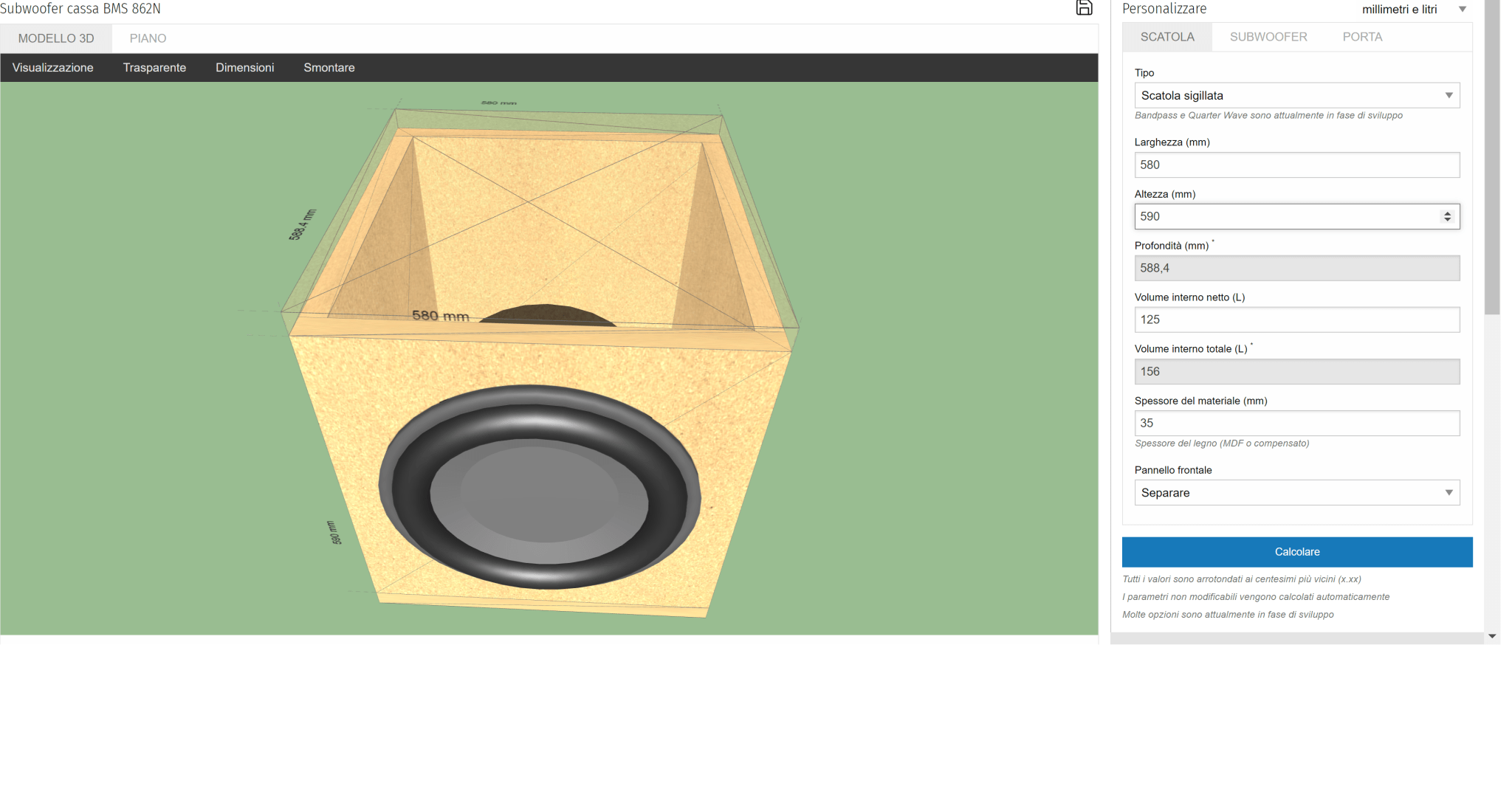

The BMS 18N862 certainly does not occupy 31 liters (156 total internal volume - 125 net internal volume=31).
Anyway, the box should be braced, which occupies some volume in addition to the driver.

So if I make a classic sealed box (with the internal magnet) of 140 liters gross I should have approximately 120/125 liters net. I would say that for my room it is too much. but for the driver it is perfect.
