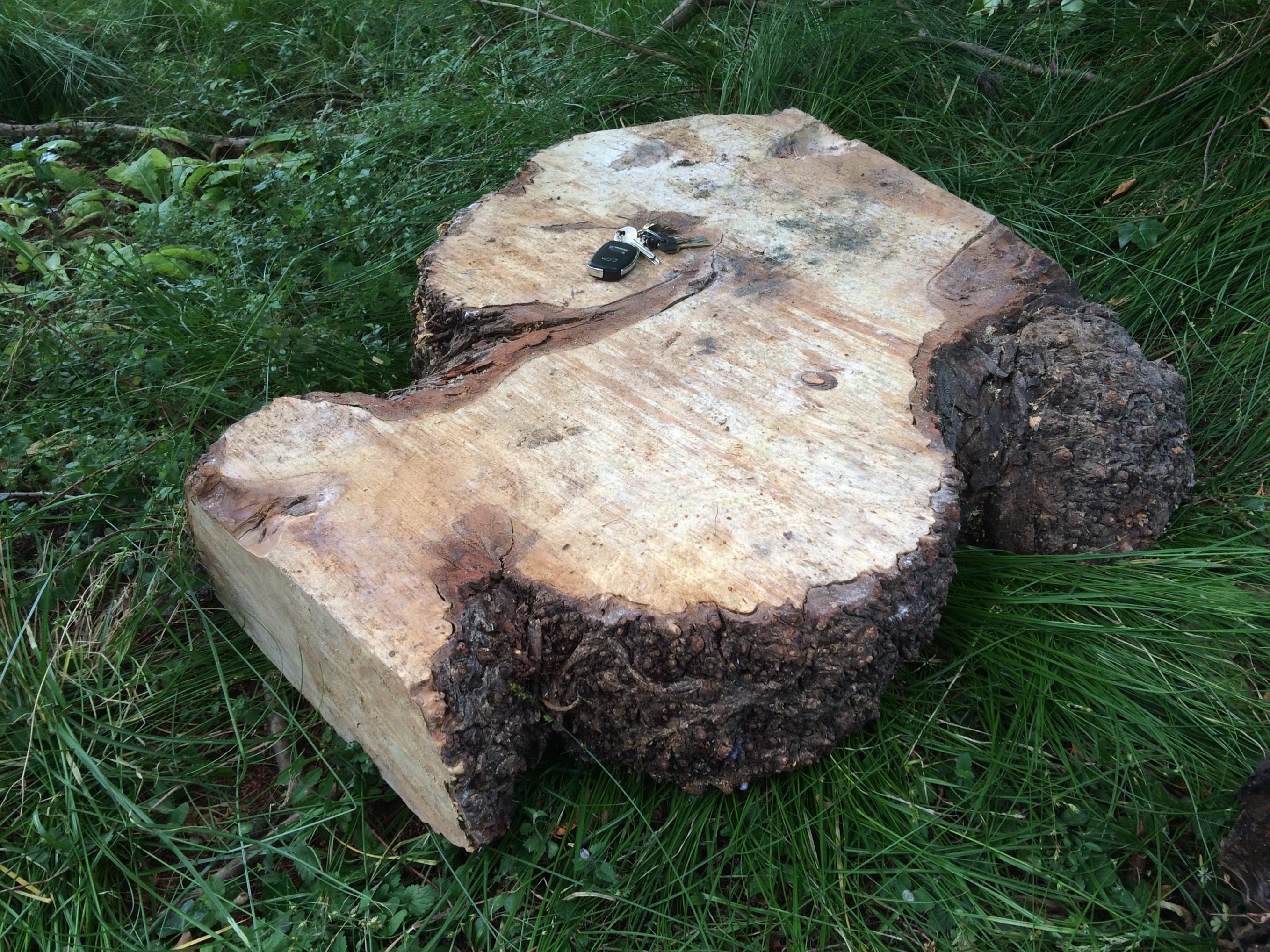

I just got hold of large dry slab of chestnut with sone interesting patterns. I have been looking into what turntables I could use to create a solid wood plinth within a very limited budget.

Its around 8 inches but hope to make 2 plinths. A mate has a Thorens TD150 that is in desperate need of new plinth. He only wants wood round the edge unlike what I would like to do so we will end up 2 very different looking turntables.
Hopefully going to make a jig to split it with chain saw then mill each piece smooth. (car keys on wood as size context)

The wood will be trimmed to a practical size and shape. It would be interesting to still have the odd dip wheres theres a burr or some other natural features of the wood.

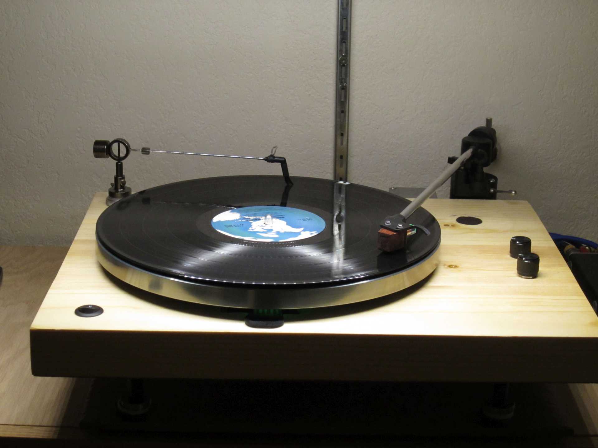

Hi, I used two layers of laminated pine boards. The planks were designed for use in something line a table top. I glued them together and then dis the cutting. I had previously used a number of other woods sandwiched together and looking back all seemed to work approximately the same. I suspect it has to do with the choice of drive / motor system. Any vibration would be transmitted through the plinth. When I checked the level on a scope it was well below the groove noise on a very quiet section of a test LP. I attached a photo. The arm is mounted on a sub platform of similar construction at the rear of the plinth. I originally had a more standard sized one (thus the black spot covering the hole near the arm mount). The sub platform is cork isolated from the bottom of the plinth and is adjustable in horizontal directions so that I could obtain the correct overhang. The plinth itself is on adjustable feet with sorbathane pads. The shelf is wall mounted on a brick wall.
Your choice of wood is upscale from what I did so please keep us updated on how it goes.
