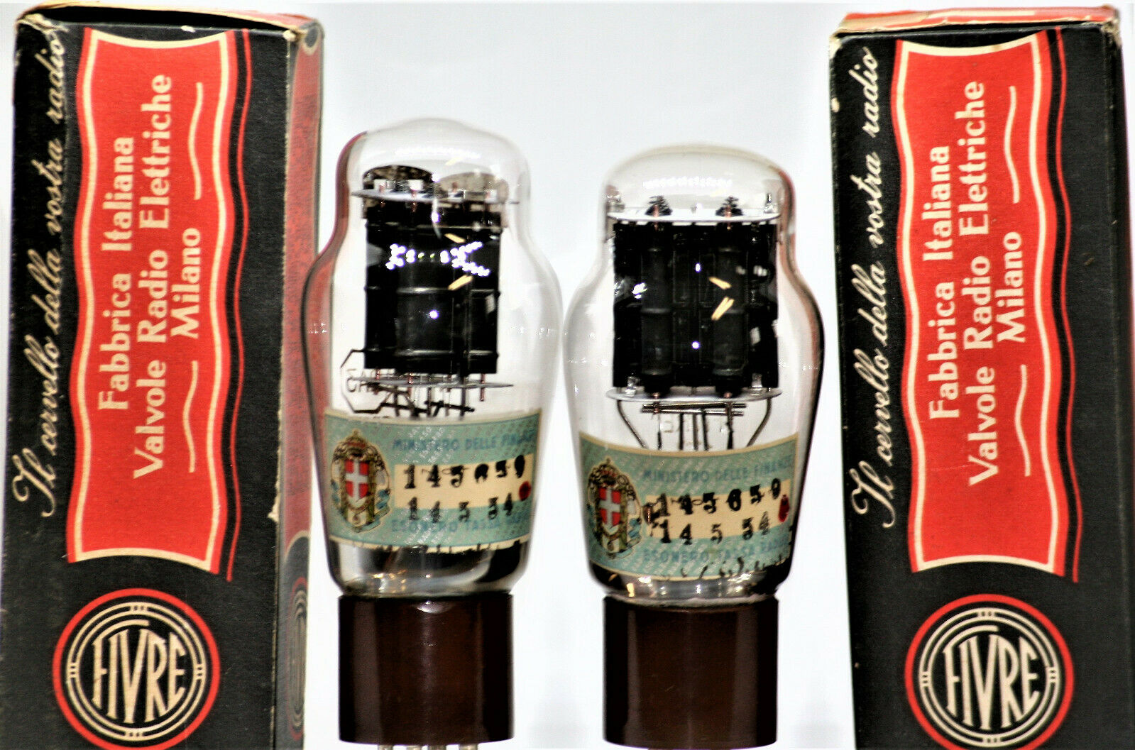

This amp is in fact a power amp incl. a pre. So swap the first amp stage, that helps.
Mostly the tubes and iron make the sound. Get some good NOS 2A3 and the same NOS 6SN7/CV1988 (the best!) for this amp and you'll get rid of thin sounding chinese tubes.
Btw, every excellent tube amp shouldn't sound like a bad tube radio. Instead it should sound like a super transistor amp. And thats what they going to sound, if build with the best parts. That makes the difference. Your reference should not be a cheap consumer amps sound, but a very much refined transistor amp without all their inherent design flaws. Thats what a good tube amp can sound like.
