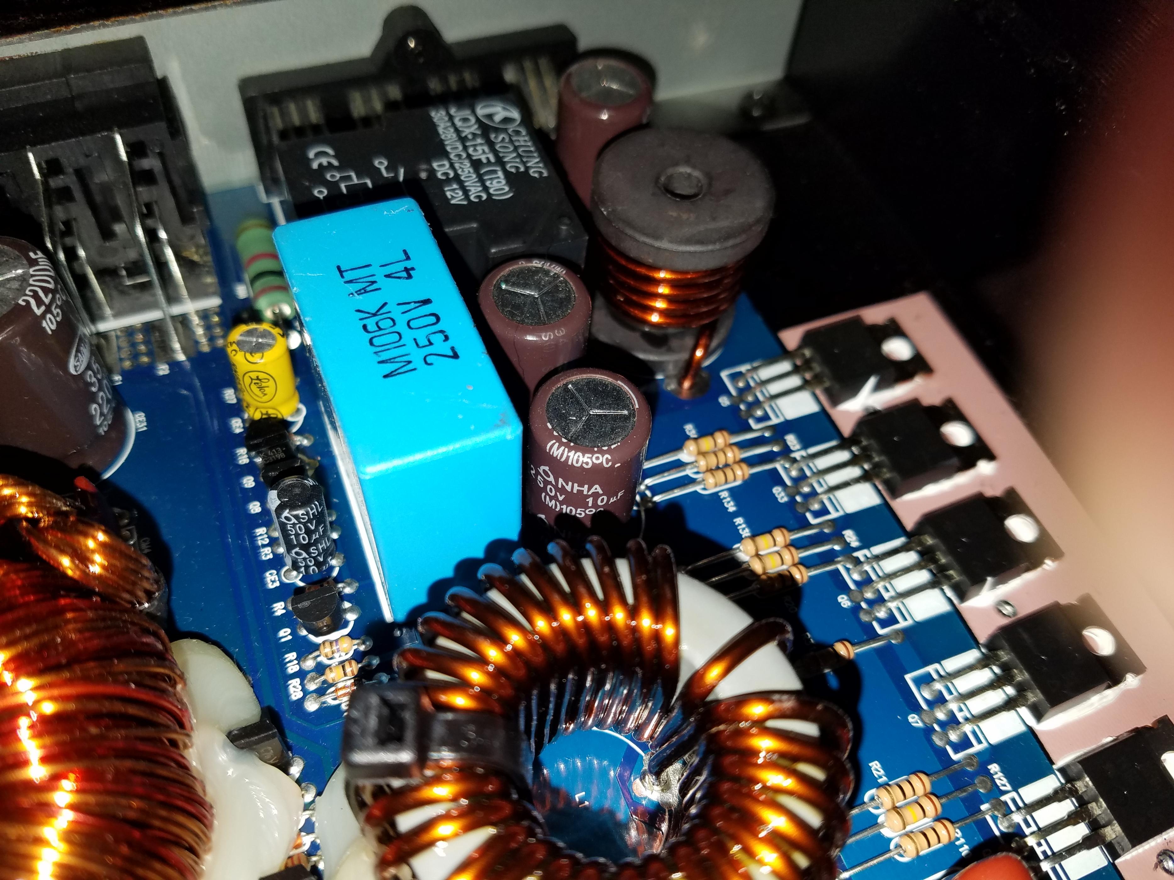

I dont have a schematic for this amp. Any reason why this resistor would burn through. the audi outputs and powersupply fets are all testing okay in the circuit.
it doesn't read short in circuit but it is definitely damaged from short or resistor igniting and burning next to it. the resistor was nowhere to be found.
I can see a few pics online and they are hard to make out but the yellow is definitely identifiable and some pics have the violet as the middle band. I think you are right perry about it being a 47 ohm resistor but 2 or 3 watt.

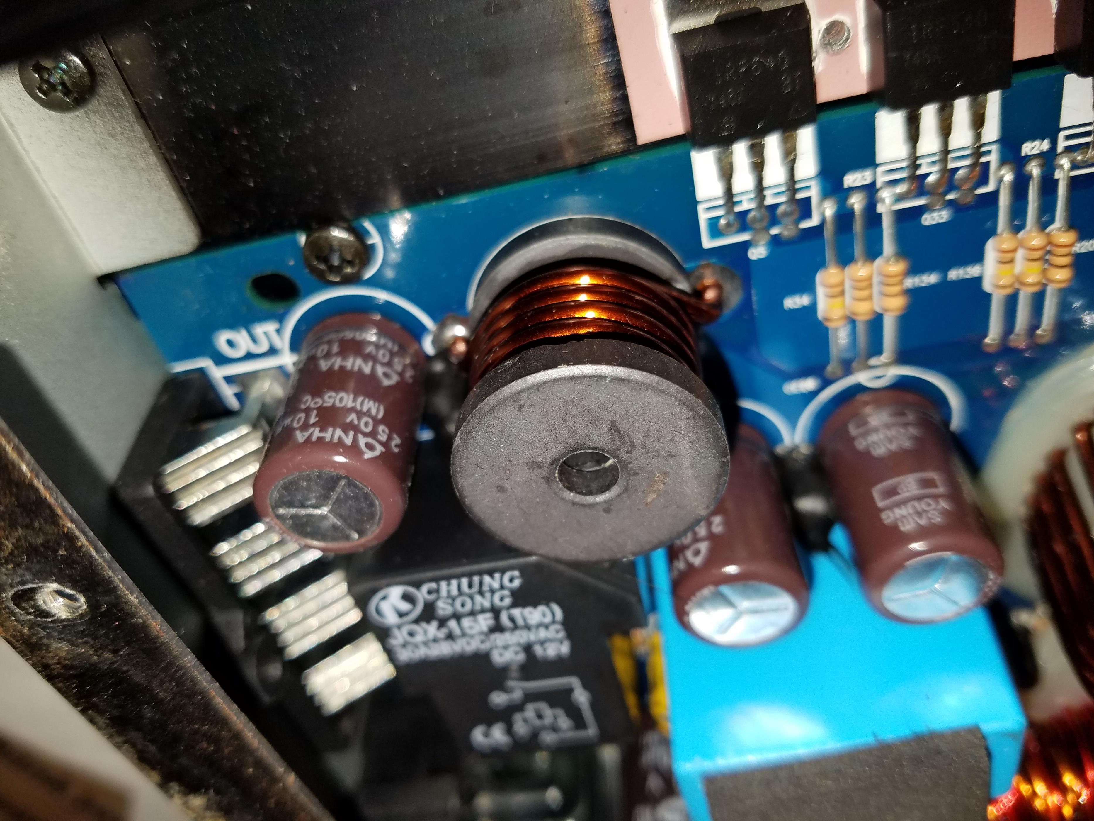

Greetings RockfordFIx, i have an ongoing thread with a similar amp (SAE-1000D) and i dont want to start a new thread, could you tell me the values of your output capacitors you have on your board CE6, CE26 and CE29 (near the relay) and post a detail pic of that area? thanks.
