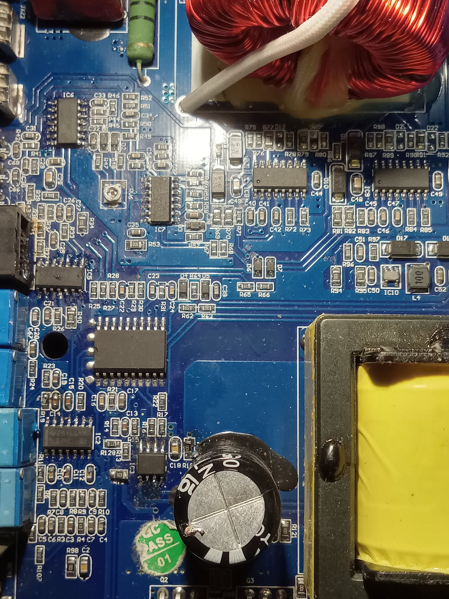

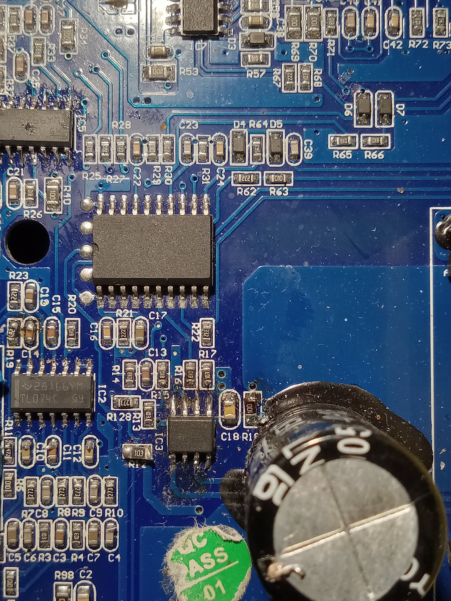

I got a sundown sfb 2000d off of ebay. When I opened it up it had no power supply fets and 3 original output fets and 1 4115. The 4427 and gate resistors were blown also. I replaced the 4427 and the gates. Also replaced all the tl074cs. The power supply is up and running. On the output I'm not getting any switching and the clip light stays on. Nothing is getting hot. I probed the tl074cs and pin 4 I got +15.39 but on pin 11 I only get -12.05. Do I need 15 volts on both to get drive? Or is there something else I should be checking?

No idea what the microprocessor is. The driver ics are 20957s I think. Everything is marked out. And I haven't been able to find the regulators yet

Which terminals on the output driver IC connect to ground?
Does this amp have ±rail voltage or only positive rail voltage?
Pins 4,5,8,9 and 12. Hopefully they are not shorted because if they are the Irs20957s I couldn't find any. And I think it has positive and negative rails. Not sure. I saw this in the tutorial somewhere but can't remember where.
If pin 9 is grounded, it likely has only positive rails.
For the 20957:
What's the DC voltage on pins 1 and 2?
Do you see a square wave on pin 3?
For the 20957:
