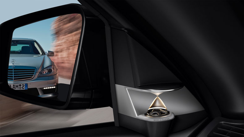

VTC Paraline at the throat of a synergy horn (It's the long skinny lens in the center)
Sausalito Audio Works lens in a Bang & Olufse Beolab 5
SAW lens in an Audi A8
If anyone curious how these work, they basically take the wavefront off of the driver at the base, and then they reflect it 90 degrees.
IMHO, the primary advantage of the SAW lens and the Paraline is that it allows you to get very very very narrow directivity, without using a looooooooooong waveguide or horn.
For instance, according to the docs, one of the Paralines has the directivity of a horn that's over a meter deep - but the Paraline is about 1" deep!

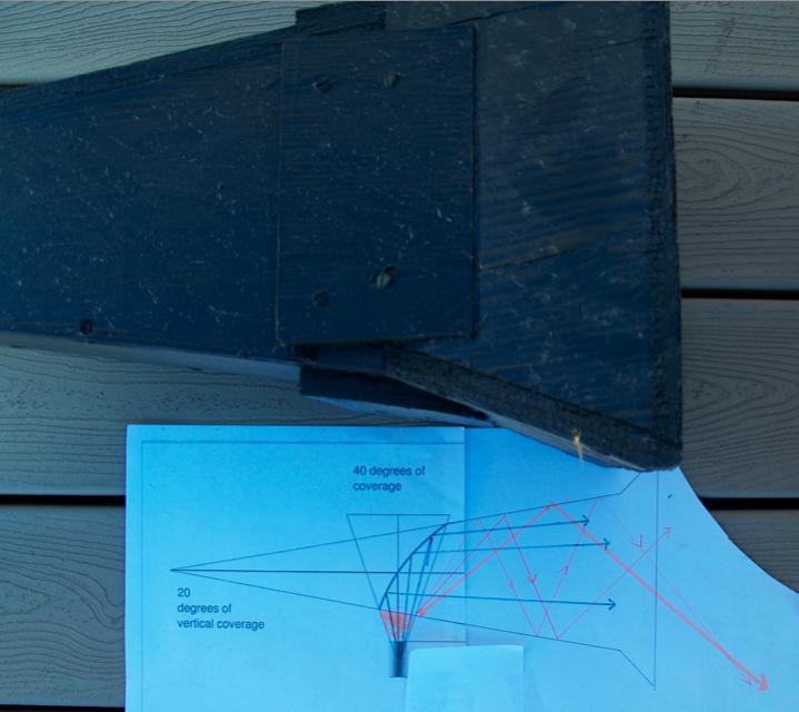

I took a stab at modeling one of these in Xara, using the dimensions from the patent.
If you'd like to make your own, here's how you could replicate this:
- First, figure out what vertical coverage you want. The vertical coverage will determine if the driver has a strong forward lobe, or a pattern that's closer to a conventional driver. There are a couple of advantages to using a narrow pattern. First, it raises the on-axis SPL by focusing the energy into a narrower angle. Very much like a horn. Second, and more important, it improves the vertical directivity. (You can see this in the measurements of the B&O speakers.) The vertical directivity is improved because a speaker on a flat baffle will begin to 'beam' as frequency rises. The reflector in this lens assembly equalizes the pathlength, and that improves vertical directivity.
In my pic above, I used the exact same vertical coverage as the patent - twenty degrees. - Second, figure out the angle of the triangle that passes through your driver. It's not clear to me what this signifies - perhaps something to do with the direcitivity of the driver at the apex? I simply used what's in the patent - forty degrees. If I had to hazard a guess, I would think that compression drivers would have a narrower angle than conventional radiators, and ribbons would have the widest angle of all. This is because a compression driver has very narrow directivity at the driver exit, conventional drivers are wider, and ribbons are widest of all.
Again, just a guess. I used 40 degrees. - Third, you need to figure out where the two triangles intersect. From looking at the patent, there is a right triangle that's formed where the center of the driver's diaphragm reflects at 90 degrees off of the reflector.
You can see it in my pic as a red square in the bottom right. The edges of that square are equal.
In order for everything to work, the pathlengths have to be equalized quite accurately. If not, you'll get comb filtering and limited bandwidth.
So if you're going to try and build one of these, I'd measure those two distances quite carefully. If there's a tweeter at the apex, I'll bet that an error on the order of a fraction of an inch would make a measurable difference in the response.
- Fourth, you need to figure out the height of the triangle that determines the vertical coverage of the device.
In the pic above, I used a height of 15cm. This height was dictated by the project that I am working on - I am going to build a synergy horn similar to the VTC paraline.
For your project, the height of the device would largely depend on your crossover point.
If there is a formula to determine the height of the triangle, I am not aware of what it is.
Here are some guesses, which might be helpful for you:
#1 - in the SAW waveguide, the height of the triangle seems to be dictated by the crossover point. For instance, in a horn, the directivity is constrained when the wavelength is equal to or smaller than the diameter of the horn or waveguide. IE, if a horn or waveguide has a mouth that's 8cm in diameter, it will constrain directivity down to 4,250 hz. Looking at the Beolab 5, we see something similar; the directivity is constrained by the aluminum discs above and below the driver.
The dimensions of the paraline are simpler to calculate; it's plain ol' horn math and I'll get to that in a future post.

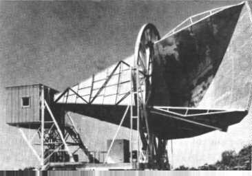

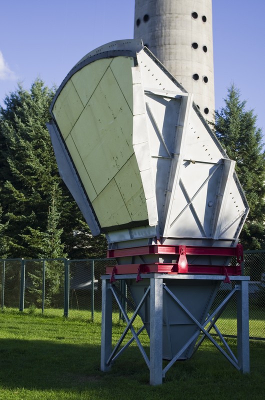

Hi Patrick (john), all
Speaker Dave has posted a couple pictures of the microwave horn / reflector that inspired the Paraline.
That microwave horn / reflector worked vary well and was the backbone of our cross country telephone system for a long time and lead to the discovery of our cosmic background radiation.
The problem when applied to acoustics is that unlike microwave, one is dealing with a variable wavelength signal and “how a reflector works” is partly dependant on how large it is. In the reflection based system, one has to have a reflector many many wavelengths across before it starts to be something like what we think of as a mirror (the same at different frequencies).
Being sort of a horn guy I guess, I wanted to find a solution that was compatible with horn loading as well so that kind of steered my direction.
The Paraline only uses the path length and natural point source radiation of the driver pressure and is free from the variable reflector issue.

Here's a drawing of an underdash horn, using the same reflector assembly that's in the paraline and in the SAW lens.
Here's an explanation of what's going on in the picture:
- The red triangle defines the forward angle, and is 20 degrees, just like the paraline patent
- The yellow triangle is the 'initial' wavefront, off of the compression driver
- The blue rectangle is the footprint of the horn. Basically it's there to define how much space we have for the horn. In this case, it's 5" by 15"
- The dark blue line is probably the most important curve in the whole horn. This is the reflector, which is designed to bend the wavefront. One thing which isn't obvious, but is very important, is that the wavefront is flat. This is a big deal in car audio, because it 'drags' the image towards the center. This might not be obvious, but flattening the wavefront drags the image towards the center because it creates a time delay. (it basically delays the center of the wavefront, and since the horns are cross-fired in a car, it 'drags' the speaker backwards. Basically drags the image towards the left.
- The black circles are simply there to reduce diffraction. Each circle reduces diffraction at the mouth of the horn.

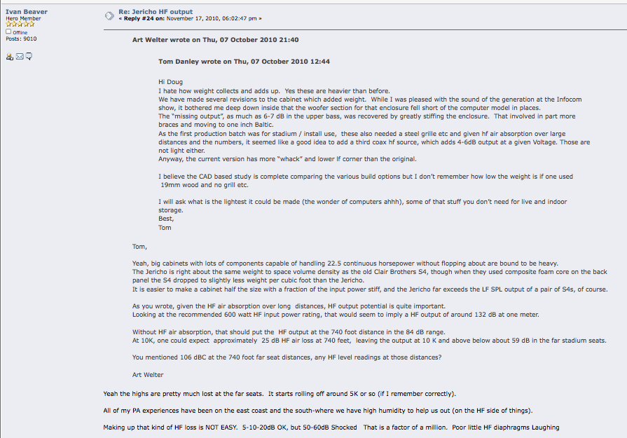

I couldn’t hear a whisper (or twinkle ;^) of cymbals (8K +) in the J2 video, but plenty of high mids, the steel drum sound was certainly ringy!
12 HF drivers per cabinet seems a bit light on the VHF for 900 feet.
Upping that to 64 HF drivers you finally got around to fixing the problem I brought up (and Ivan Beaver acknowledged) 10/7/10, and now you won’t show me how ;^) ?

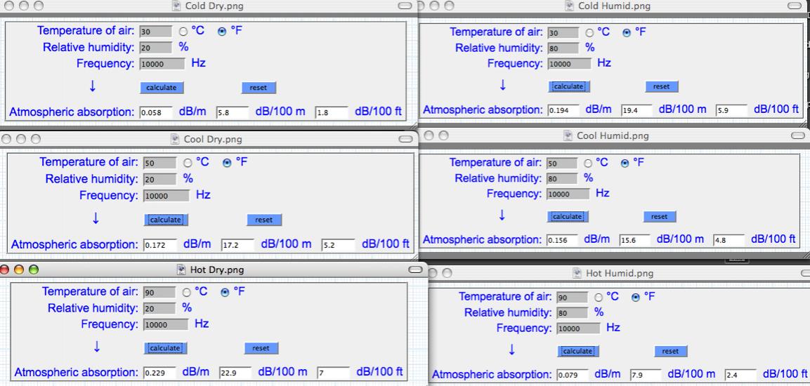

This guy has the best collection of audio calculators:
Calculation method of absorption of sound by the atmosphere air damping dissipation absorbtion - Attenuation of sound during propagation outdoors outdoor - sengpielaudio Sengpiel Berlin
Hot and humid environments have less HF atmospheric absorption than dry, the opposite is true when the environment is cold. Somewhere in the middle temperature range both are pretty bad.
In the high desert of New Mexico outdoor concert season we see temperatures in the 90’s and relative humidity in the 20s, we need two to four times the HF horsepower from my native Minnesota, which could be 90 degrees with 80+ relative humidity.
With summer temperature often ranging as much as 50 degrees during day to night here, some drastic EQ changes sometimes need to be made, the crisp clear sound in the early morning quickly turns to mud once the sun shines.
Then the thermal gradients start to happen, even with a single point source they can point the sound in a different direction than the cabinets..
Perhaps you should make temperature/humidity/thermal gradient angle adjustment actuators optional on your stadium installs :^).
I don’t miss the Minnesota humidity, but I miss the HF, have the double whammy of age and absorption going on here :^(.
