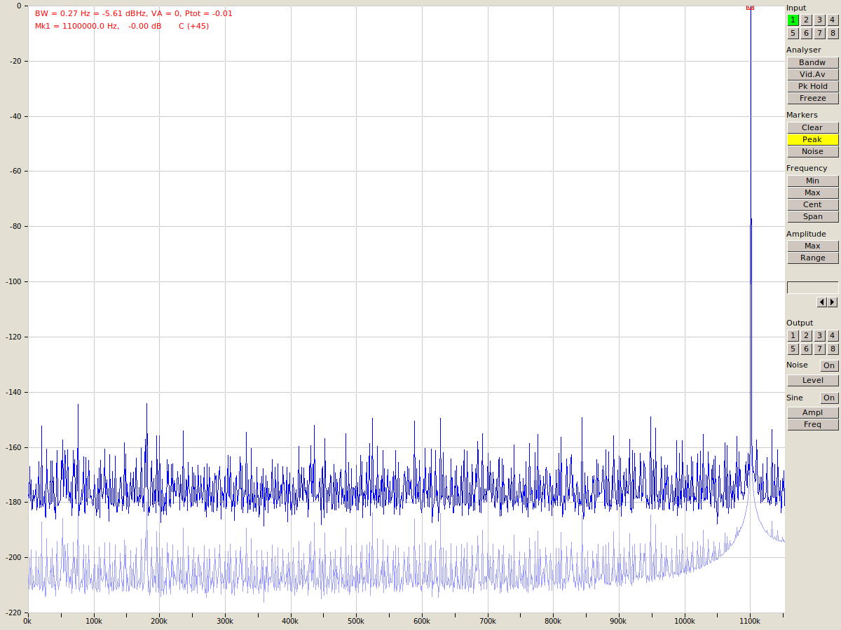

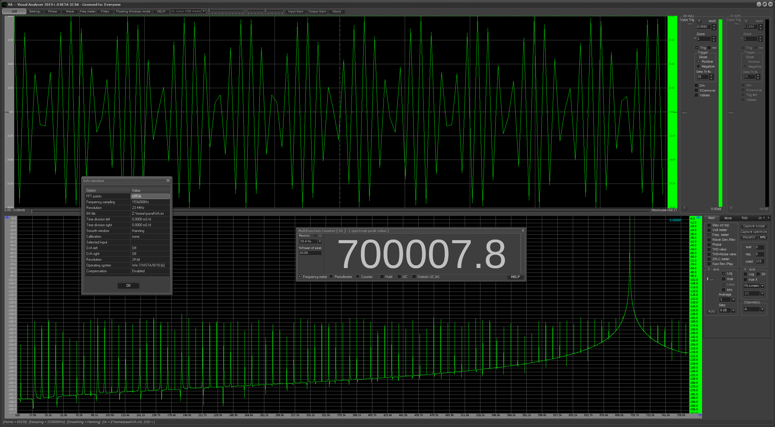

After a few patches the RPI4 USB audio class 2 gadget supports the maximum 1024bytes packets size in USB2 microframe (i.e. 8000 x 1024 bytes = 65Mbits/s duplex throughput) now. Good opportunity to test how common software analyzers deal with high samplerates.
Tested in linux which accepts any samplerate reported by the USB audio device. I configured the gadget to use 1536kHz/24bit/1ch (36.9Mbits/s), with sox generating 700kHz sine signal on the RPi. The USB host was capturing from the USB gadget and analyzing .
Arta in wine - fixed samplerate at 192kHz, not working
REW - not tested yet but definitely will require low-latency garbage collector of the latest java.
Audacity - while it accepts files with any samplerate (I have tested 10MHz files), its soundcard backend is limited by portaudio samplerate range, probably could be changed and recompiled. Stock version not working.
VisualAnalyzer in wine - did not offer the device samplerate, but could be configured at any samplerate. Would require some work (from its author as it is not open source) but its potential is quite good. Screenshot taken.
jaaa - a simple open source FFT analyzer in linux, works OK. Unfortunately only 128k FFT length which is quite little. But this could be changed in the source code. Screenshot taken.

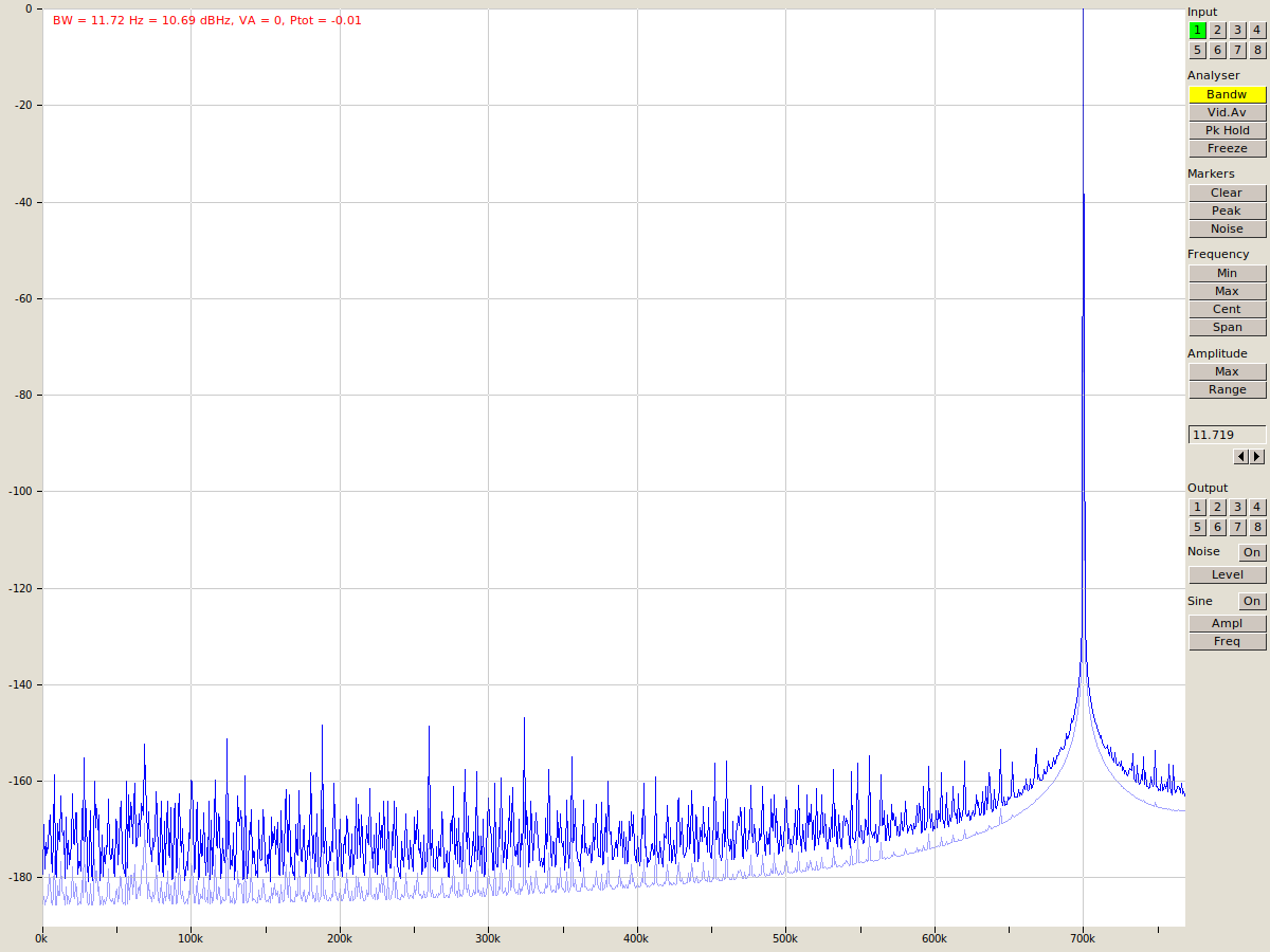

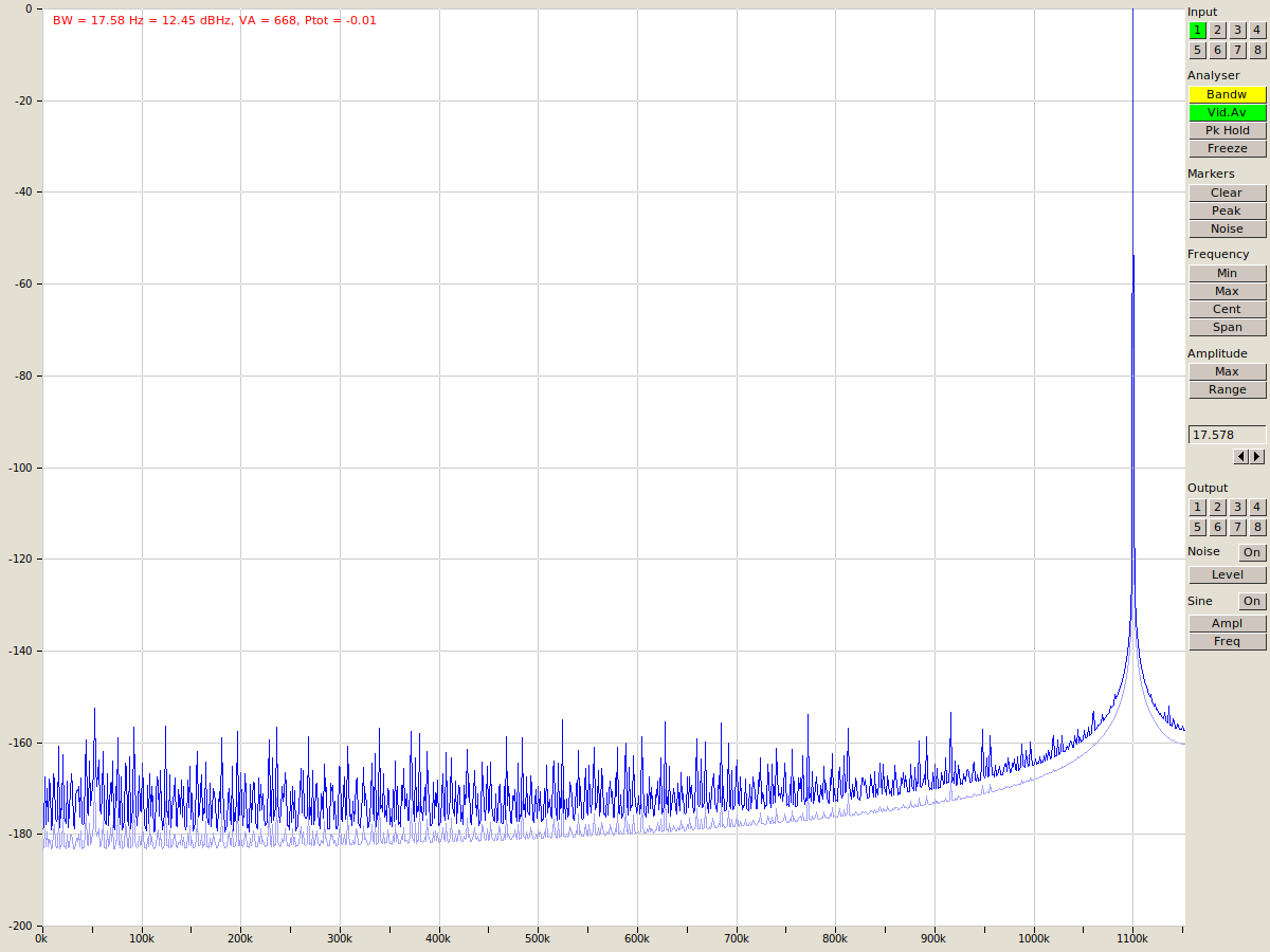

Max FFT length increased to 8M, min. amplitude lowered to -220dB. The analyzer takes about 30% of one core. Fundamental determined exactly at 1100000.0Hz. Completely stable operation on both sides, no buffer xruns.

Code:
sox -V -r 2304000 -n -b 24 -c 1 -t alsa hw:2 synth 100000 sine 1100k
sox: SoX v14.4.2
Input File : '' (null)
Channels : 1
Sample Rate : 2.304e+06
Precision : 32-bit
Output File : 'hw:2' (alsa)
Channels : 1
Precision : 24-bit
Sample Encoding: 24-bit Signed Integer PCM
Endian Type : little
Reverse Nibbles: no
Reverse Bits : no
sox INFO sox: effects chain: input 2.304e+06Hz 1 channels
sox INFO sox: effects chain: synth 2.304e+06Hz 1 channels
sox INFO sox: effects chain: output 2.304e+06Hz 1 channels
Code:
Capture:
Status: Running
Interface = 2
Altset = 1
Packet Size = 864
Momentary freq = 2304000 Hz (0x120.0000)
Interface 2
Altset 1
Format: S24_3LE
Channels: 1
Endpoint: 1 IN (ASYNC)
Rates: 2304000
Data packet interval: 125 us
Code:
access: MMAP_INTERLEAVED
format: S24_3LE
subformat: STD
channels: 1
rate: 2304000 (2304000/1)
period_size: 100000
buffer_size: 200000

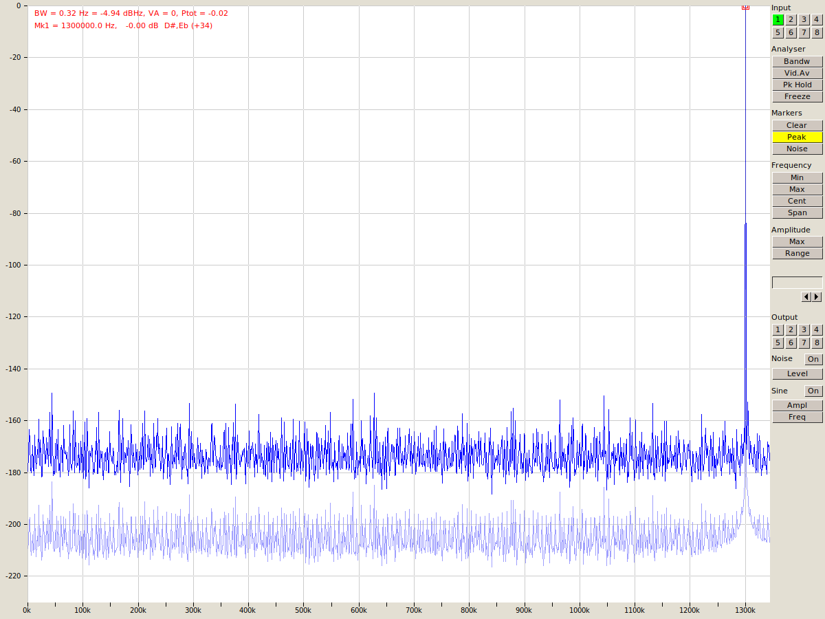

Finally the usable maximum available - 14 x 192kHz = 2.688MHz. Spectrum for sine at 1.3MHz 0dBFS. Packet size 1008 is getting close to maximum 1024.
Now just getting the DAC/ADC
Code:
Capture:
Status: Running
Interface = 2
Altset = 1
Packet Size = 1008
Momentary freq = 2688000 Hz (0x150.0000)
Interface 2
Altset 1
Format: S24_3LE
Channels: 1
Rates: 2688000

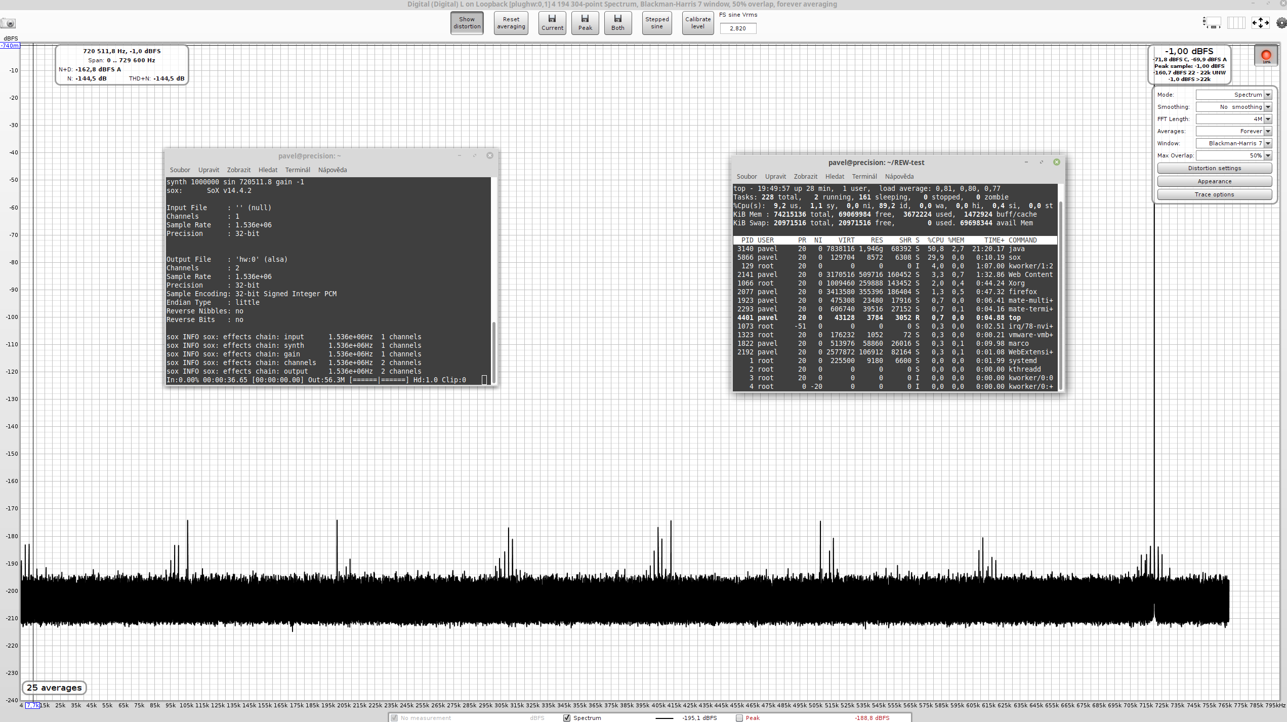

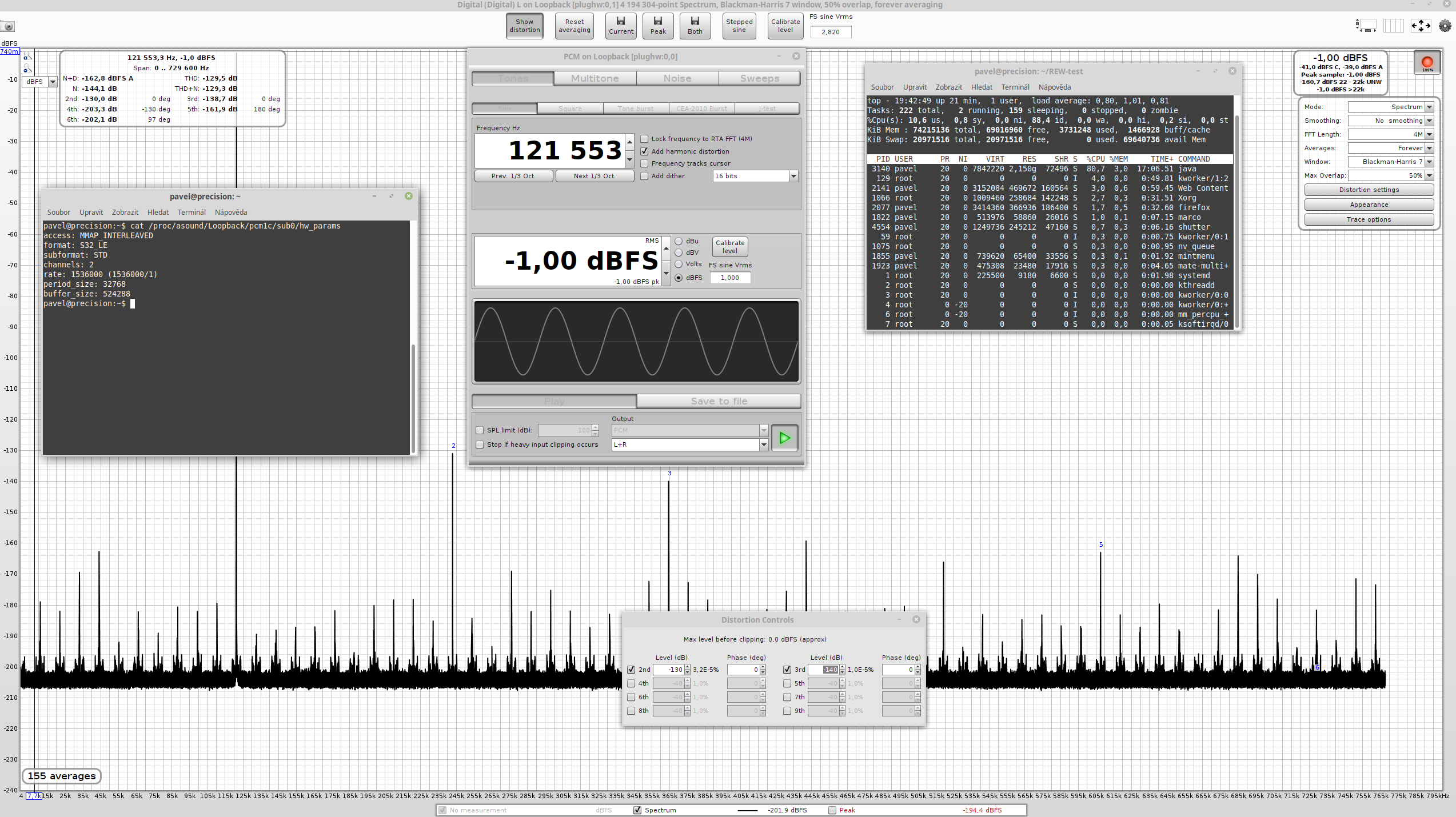

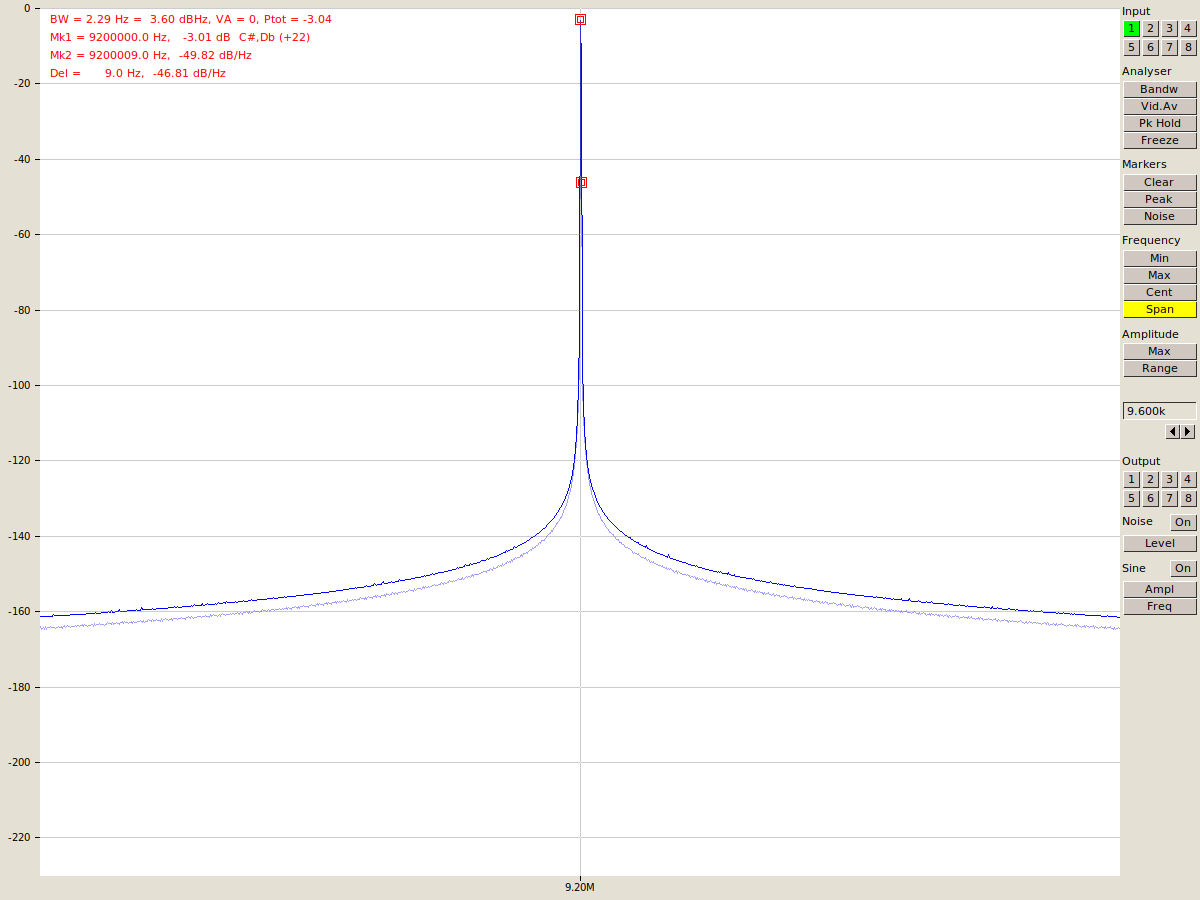

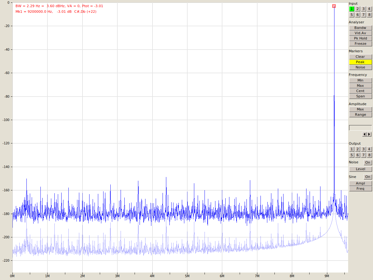

Recompiled kernel, raising the max. samplerate of the loopback device snd-aloop to 19.2MHz by changing one parameter. Also max buffer size raised to 2MB for timing safety.
At samplerate 19.2MHz single-threaded sox does not keep up with generating sine signal, I had to pre-generate 32bit wav at 19.2MHz samplerate, 9.2MHz sine tone -3dB. 1 minute of signal takes 4GB on drive, bitrate 614Mbps. The test really requires SSD drives.
I used aplay for playback for good control of buffer/period sizes. aplay plays perfectly at that rate, absolutely stable. Using whole the available 2MB of buffer, period size 256kB. This means the player feeds data to the playback device every 262144/(19200000*4) = 3ms.Yet aplay takes 3% of an old xeon core.
Jaaa capturing from the loopback device holds the flag. At 130% CPU it manages to analyze 8M FFT (bin width 2.29Hz) with no hiccups, UI operable with slight sub-second delayed reactions.
The first screenshot is complete spectrum.
The second screenshot shows maximum frequency zoom with span 9.6kHz and center frequency 9.2MHz. The two markers are 9Hz apart, I could not place them closer with my mouse.
Current PC hardware (my workstation is 8yrs old) offers huge performance if the software is written properly.

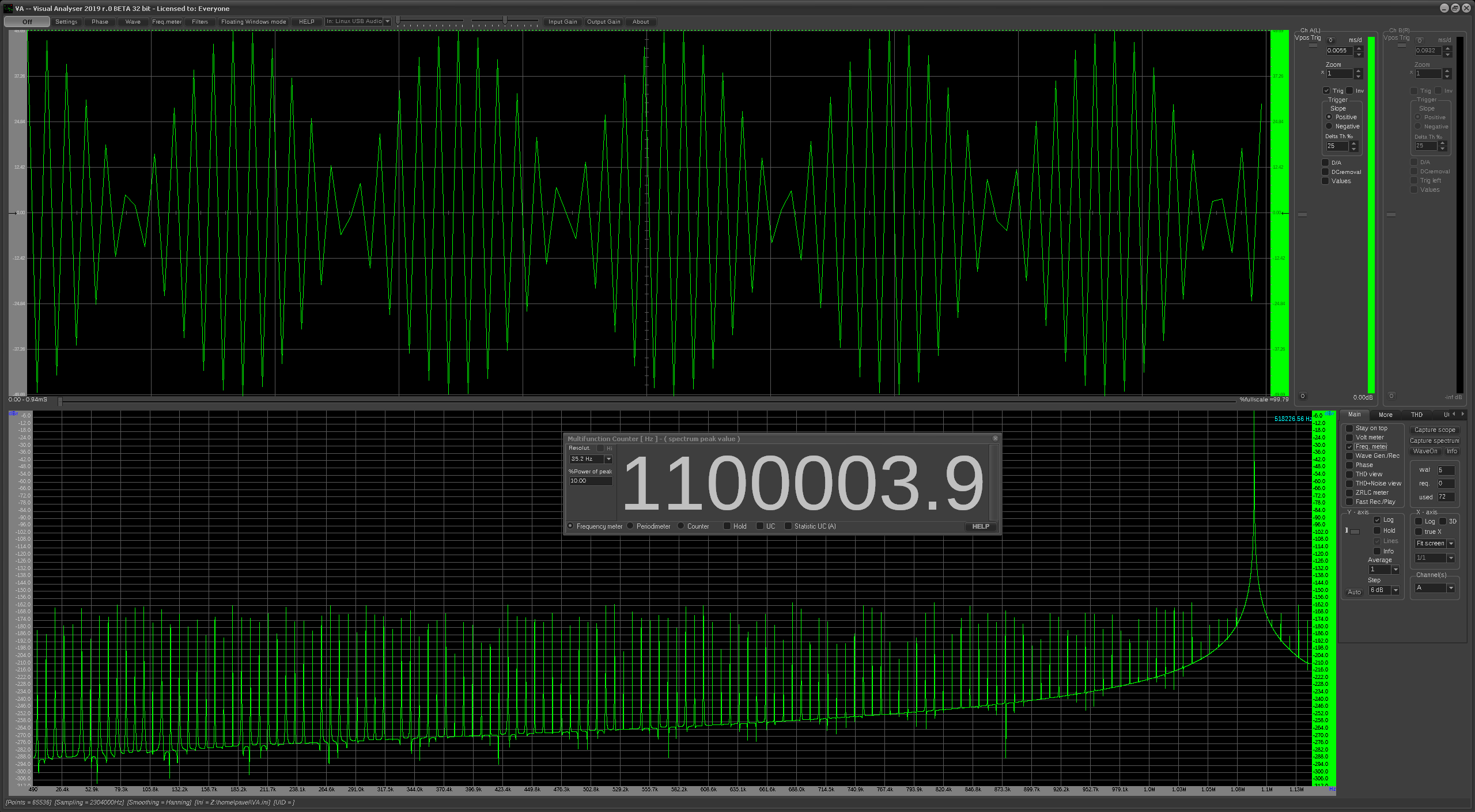

REW shows that multiplatform java can provide great performance, if the project is designed and implemented correctly. John Mulcahy has kindly built a trial version with increased limits of samplerate to 1,536kHz, FFT to 4M, buffers to 512k. HW-accellerated graphics in OpenGL drops the display process load to virtually zero. That allowed testing REW efficiency and performance in my modified linux alsa loopback.
1,536kHz samplerate, signal generated by REW generator with two extra distortions enabled (H2@-130dB, H3@-140dB), FFT 4M, display resolution 2560x1440. Generated frequency set to one decimal place 121,533.3Hz (the input field displays just the integer part), FFT measured it precisely. The added distortions measured correctly. All of that operating completely stable (notice the 155 averages) with load of 90% of single CPU core.
The second screenshot confirms the precision of REW 4M FFT with an external signal generator - SoX generating 720,511.8Hz (close to the Nyquist's 768kHz) - again REW measures the fundamental precisely. CPU load of 60% for the java of the analyzer is an excellent figure. Please notice how efficient REW is - 60% REW + 30% C-coded sox = 90%, the same load when REW generated the sine signal itself + it was adding the two requested distortions.
John only raised the limits and increased buffers of his standard REW release, I did not do any tweaks to the linux audio subsystem, no elevated priorities or real-time processes. REW was running on stock open-source OpenJDK1.8 included in Ubuntu 18.04.
IMO REW has a great potential for near-future high-samplerate devices. And the only truly multiplatform project I know about.
