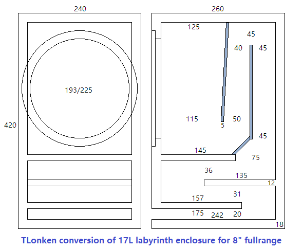

Here is the 17L 1.5m TLonken 8" Supravox that I hastily assembled 11/24-25, amidst Covid tests and mushrooming lockdowns just before my escape. The inexpensive ready-made 1.8mm MDF cab came with a 3-fold "line" ending in a slot. I added two verical plywood dividers (edged with gasket foam) plus a narrow slanted bridge to the existing labyrinth. (Egg-crate-foamed but not yet glued down.) The other unit left unchanged for comparison. A quick listen: got the bass I needed out of the TL; the netting diffused very high frequency a little but would not serve to protect the whizzer. Then I was out'a there!

Thanks everyone for the "Onken" discussion -- please continue. When I worked on my first original DIY (HeilEve 7L 1m TL) I did peruse the online archive of historical French "Onken", as well as use the Onken online calculator to design/reconcile/justify the folded, long single-slot "labyrinth" cab that is ubiquitous in China. The origin of Onken seems obscure and convoluted. Although first documented in the West in the French designs, the word itself is Japanese for "audio research (lab)" and presumably referred to a specific well-respected research center. In any event, the single loaded slot design has always been more popular in Europe (e.g. JMReynaud, ELAC) than the US, except for subwoofers.
I do hope someone will take the trouble to simulate or measure a series of cabs extending from the single loaded slot without fold, then adding folds, to encompass approximately tapered lines terminating in the loaded slot port (i.e. TLonken). I lack the tools and experience for doing so, except of course I listen and compare as the line grows incrementally. (I did find a site with a large systematic variety of CAD cabs just like this but had trouble downloading the associated spreadsheets.)
As for nomenclature, all the ones in use seem confusing or easily confused with each other. And in China, "labyrinth" the catch-all term used to refer to complex folded horn (such as my Fidelio Lowther PM2A) but now cover slot-loaded too, sometimes (very inconsistently) labelled N, M, Z-or-7.
May I ask, at what aspect ratio does a BR become MLTL instead of "reflex" (technical definition of phase-inverting resonance)? And when does cavity become a "line"? A tapered line joining a loaded slot port is what, technically?

A tapered line joining a slot vent is a mass-loaded line. You should be able to do away with the slot for much the same results by increasing the taper ratio.
There isn't a hard & fast rule as Dave says; technically you can define the transition from a vented box to an MLQW as the point at which the eigenmodes alter tuning (either Fb or the alignment shape) away from what you would obtain under pure cavity resonance assumptions. In outright terms, most MLTLs fall into that mid-ground rather than having tuning purely defined by standing waves.

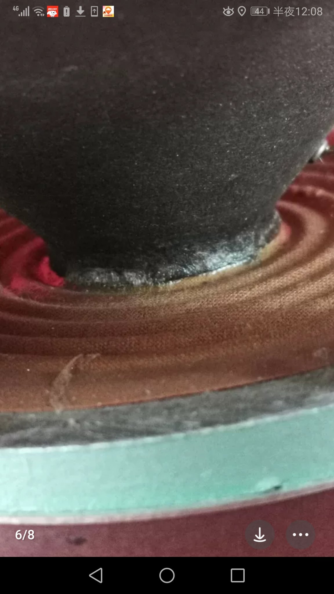

Nice. Check the suspension with some light behind to see if there is any weak point, I repaired mine as it was too dry (my ones are even older versions).
Appreciated, I'll check once I'm reunited with them post-fever/quarantine. The seller may have added glue to the base of cone?

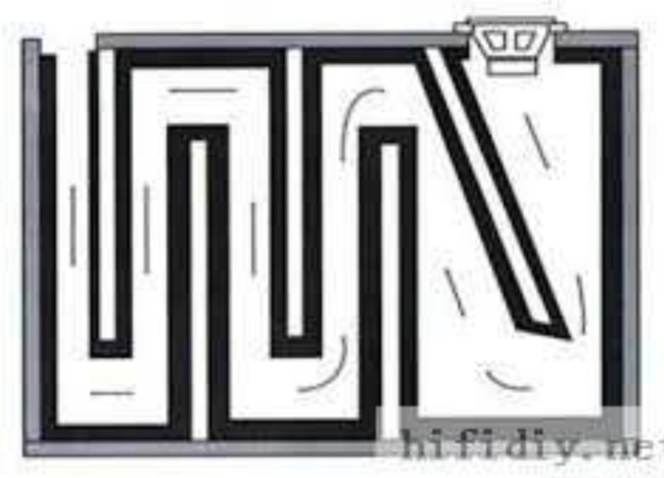

A member of China's bbs.hifidiy.net made a pair of labyrinths out of dresser cabinets, using the design below he found online. Another member reported that the drawing actually came from a book that he once owned, published in 1958 translated from Russian. Coincidentally, my 1.3m "remodel-in-place" TLonken follows the exact same folds.
库里科夫斯基,业余无线电新技术,人民邮电出版社 1958 (Khurikovski? Amateur radio new techniques, People's Telegraph Pub.)

Belated drawing of the thread-title TLonken, 17L 1.5m-line converted from a very inexpensive but solidly-built (18mm MDF), ready-made labyrinth cabinet. Measurements are inexact and certainly non-optimal. The TLonken has served as a testing platform for "high-powered" (low Qts) 8-inch fullrange drivers including: Supravox, Lowther PM6A, Isred/MKHIFI drum-paper, and Fostex F200A....
