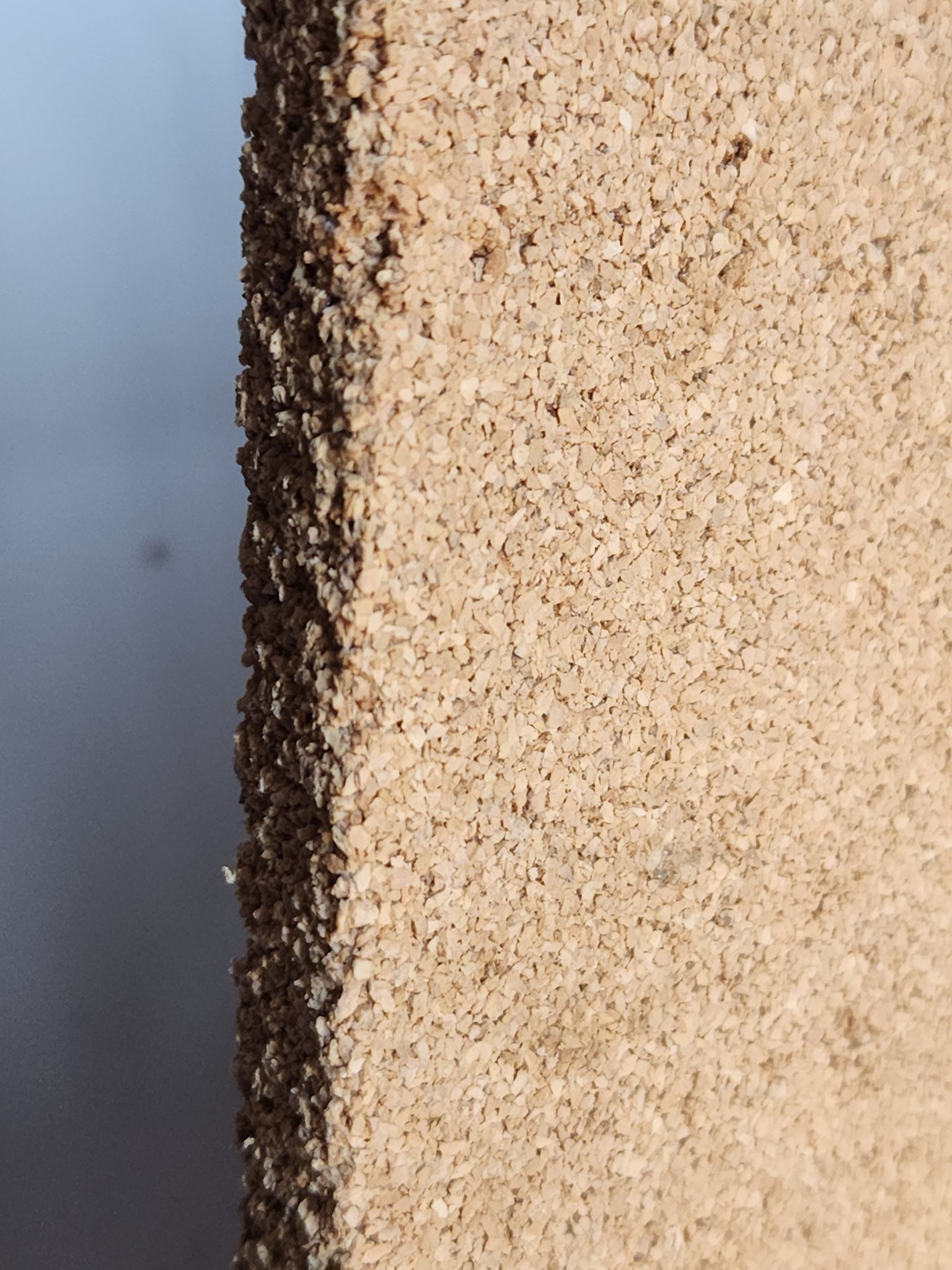

When my workbench was finished, my wife suggested this quarter inch cork. It's pretty dense, and dimensionally stable without any adhesive. I thought it would last 6 months per side and then would need to be replaced. After 4 years it's still going strong, and I really like it. Easy to clean up. Once I used cheap adhesive shelf paper to pull off a thin layer and it turned out like new.
It handles heavier equipment really well.

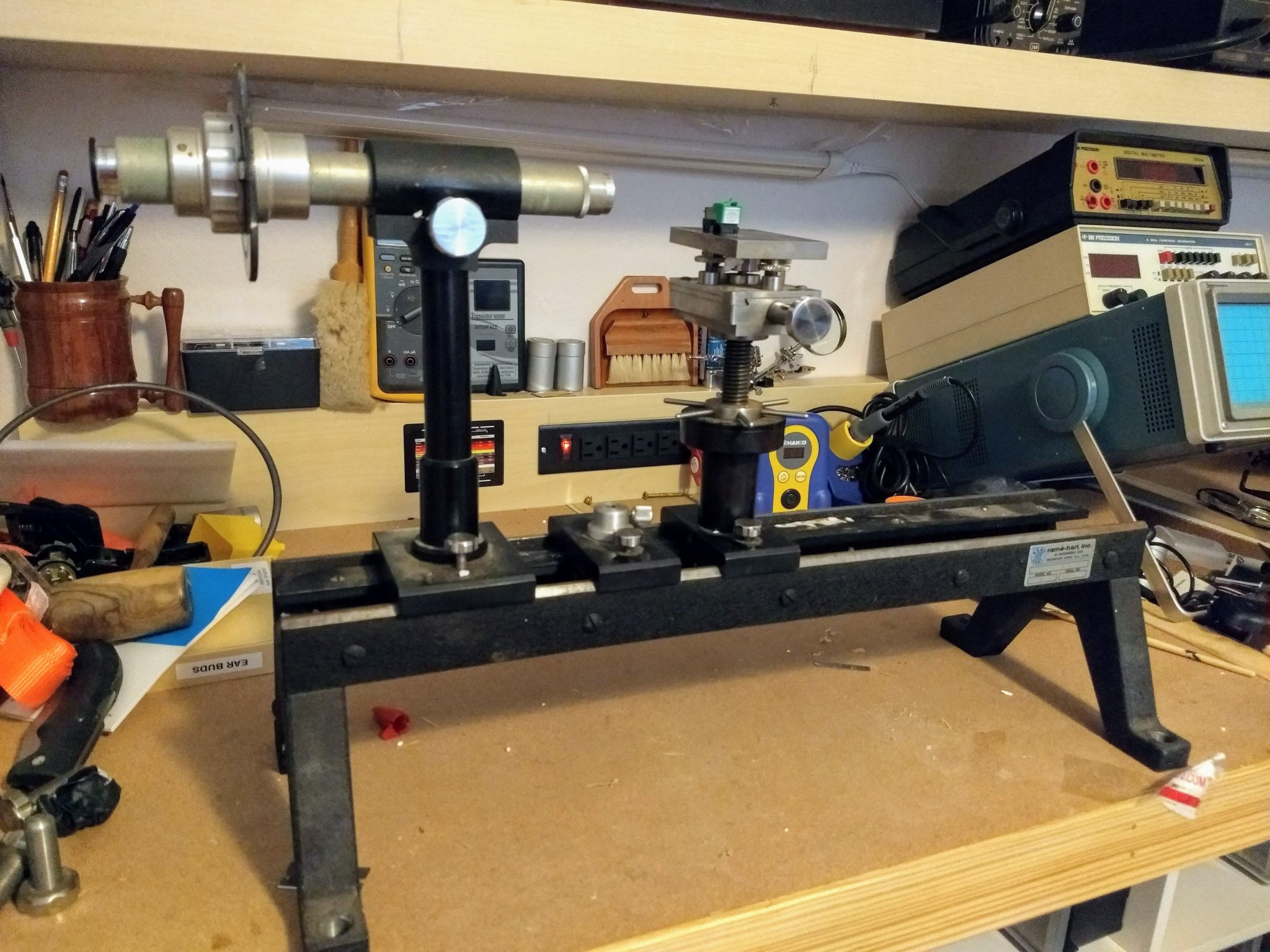

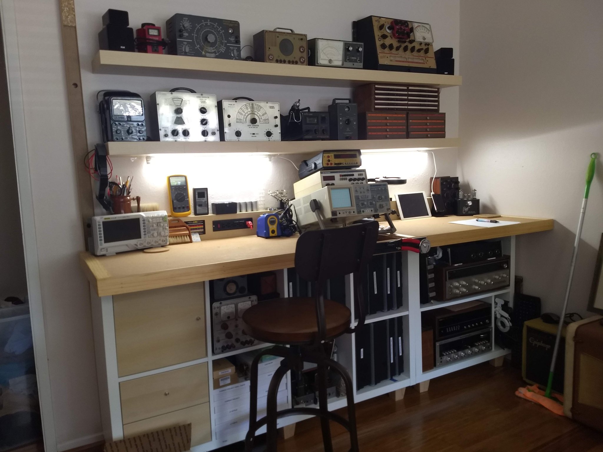

Looking at the benches in the photos, for that type of work, I am either on the dining room table or an old solid wood door, so:
Mostly just painted wood.
Plain cardboard for sanding tasks.
Quilting cutting boards/mats when needed. I have a couple sizes, I generally also got one for the wife when I got mine (I compete with sewing projects for the dining room table - edit, being kicked off the table right now 🙂 ).
My "work-bench" is a motor-oil soaked, horribly welding scarred, and uneven set of 3.5-4" slabs my grandfather cut. (My dad gave away the steel welding table, and I left most of the welding stuff for my step-mom to sell).
