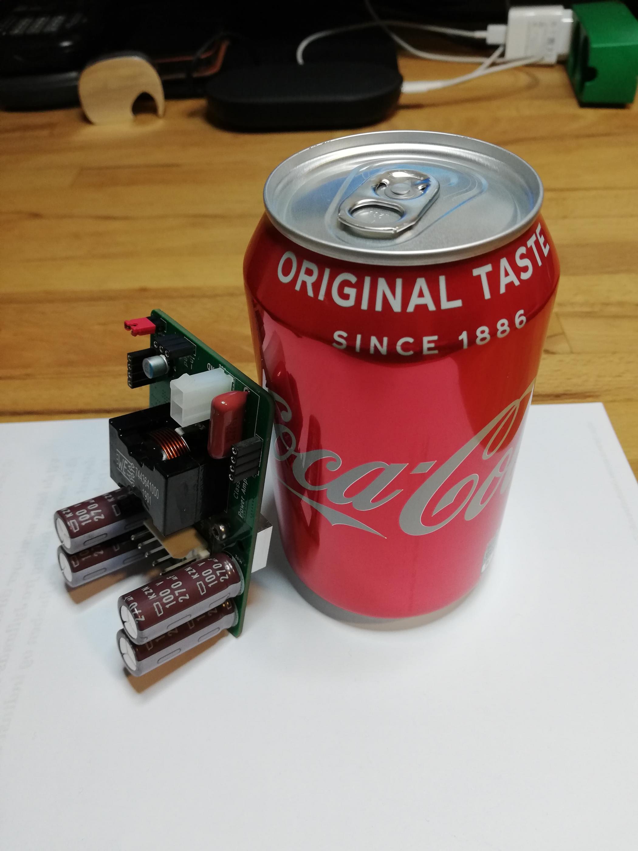

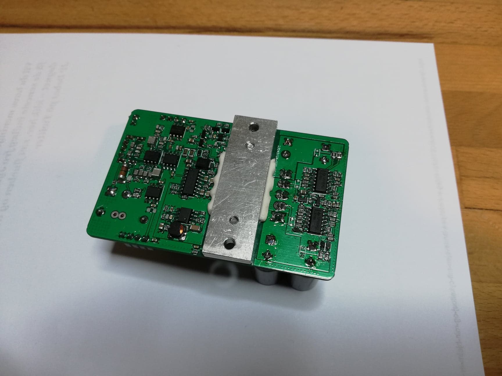

Hey you great Guys
We are a bunch of boys who developed a new class D amplifier module originally intended for personal use.
But due to pretty high costs, we thought maybe we should make a batch, and share the module with others to lower the costs pr. module.
Anyways here are a few high lights of the module:
It is a self-oscillating class D amplifier with brand new twin feedback loop technology.
The output MOSFETs are IRF Direct FETs smd mount types with very low induction.
Output power is 1 X 450 Watts @ 4 Ohm @ +- 60V supply.
Calculated Zout @ 1KHz = 9µOhms
Gain 25 dB
Noise 25 µV
Phase shift from input to output 0,0 Dgr throughout the audioband.
What I would like to know is:
Would it make sense to combine a kit with i.e. a complete powersupply?
What kind of powersupply would be the preferred one:
A somewhat costly custom switch mode power supply?
A standard cheaper SMPS form third party?
A linear supply with custom toroids and PCB for capacitance and regulators for +-12V?
No supply at all?
The input impedance of class D amplifiers are often pretty low, as the impedance is a choise between noise and impedance.
Thus a buffer can be necessary to ease the load on a preamplifier or a DAC.
We´ve thought of three different types, which could be options:
An unbalanced push pull unity gain buffer with discrete technology and no negative feedback, and fully DC coupled operated with servo circuits.
A Balanced buffer with op-amps OPA1612
A buffer with footprints for cross overs, to fit an active speaker.
You can then choose filtertype, slope and frequency on your own, formulas provided though.
The buffer PCB will fit onto the connectors on the amplifier board, so no soldering is required.
The THD measurement below is done under less than ideal conditions i.e with a lab supply, not capable of any more power than shown, and long leads etc.
The module on the pictures is a hand soldered prototype, the final layout will not be changed very much though.
We will very much appreciate your opinion, ideas or thoughts.
And of course questions are most welcome.

Hi Kurt,
Good initiative! You state 450W in 8 Ohm with a +/-60V power supply. +/-60V should allow 450W in 4 Ohm only (SE configuration), am I right? If bridged, it would be some 900W in 8 Ohm.
Oh damned you are sharp :)
Sorry for the mistake.
Of course it is at 4 Ohms.
Anyways it is also fully stable at 2 Ohms, and it is a half bridge design, which makes it bridgeable.
Do you have any considerations regarding powersupply?

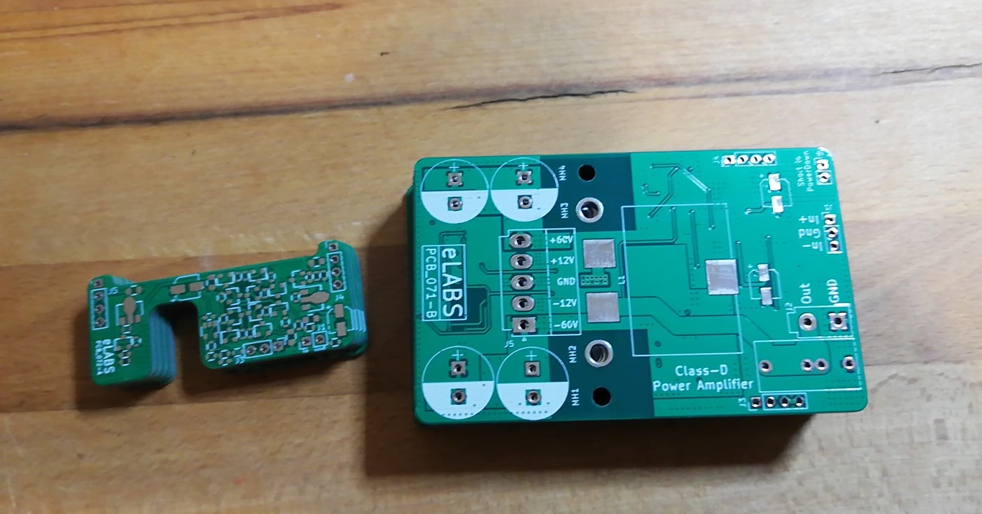

Thank´s a lot for your ideas.
The AFE´s we´ve considered, and for the time being are prototyping, are small non solder PCB´s that fits into the boards connections, and then have its own set of input connectors.
You can have a look at the PCB design in the picture. The buffer is on the left side.
Yet it might be looking different when devellopment is completed
