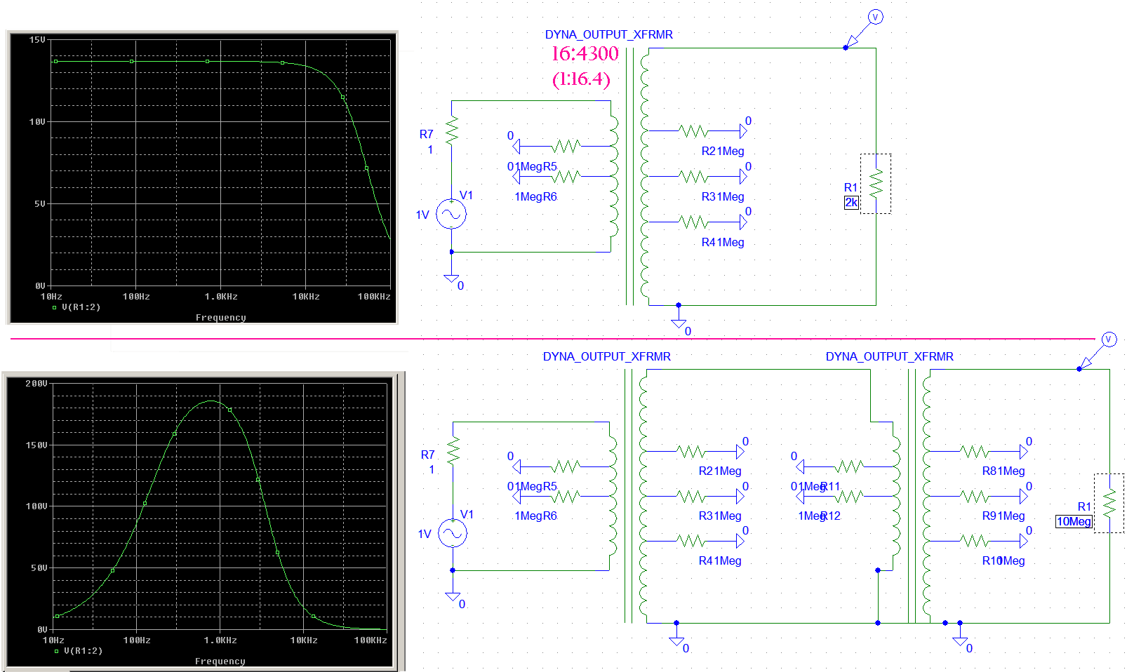

It is pretty sure to be short in highs or lows or both. Transformers do not "have an impedance" but frequency response and impedance go together in transformers and getting far off optimum will suck.
I asked my Idiot. The only well-modeled transformer in its poor selection is a beast, with many taps for the Idiot to whine about, but the Zs and ratios are not too-too-far-off, and we want the trend not the banker's answer.
Dyna OT run backward, fed from 1 Ohm and loaded with a bit less than nominal plate-size Z, gives the expected wide flat response with a loaded gain of 13.7 (16.4 unloaded).
Two of these in cascode, the I and Cs are wrong. We do get a higher step-up ratio but only mid-band (proving this was a balanced design favoring neither highs nor lows). The -3dB bandwidth is like 200Hz to 2kHz, bad pocket AM radio response.

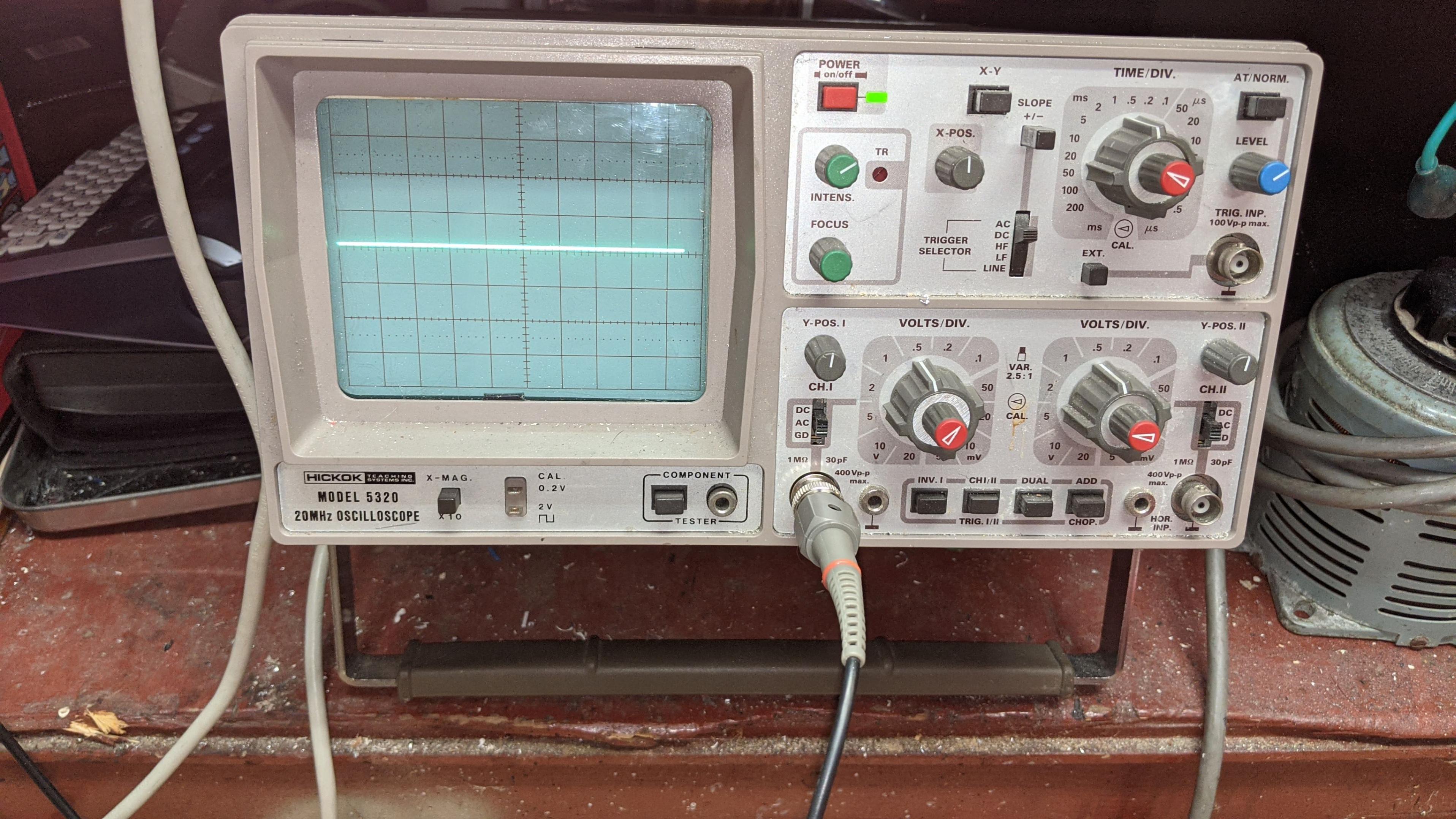

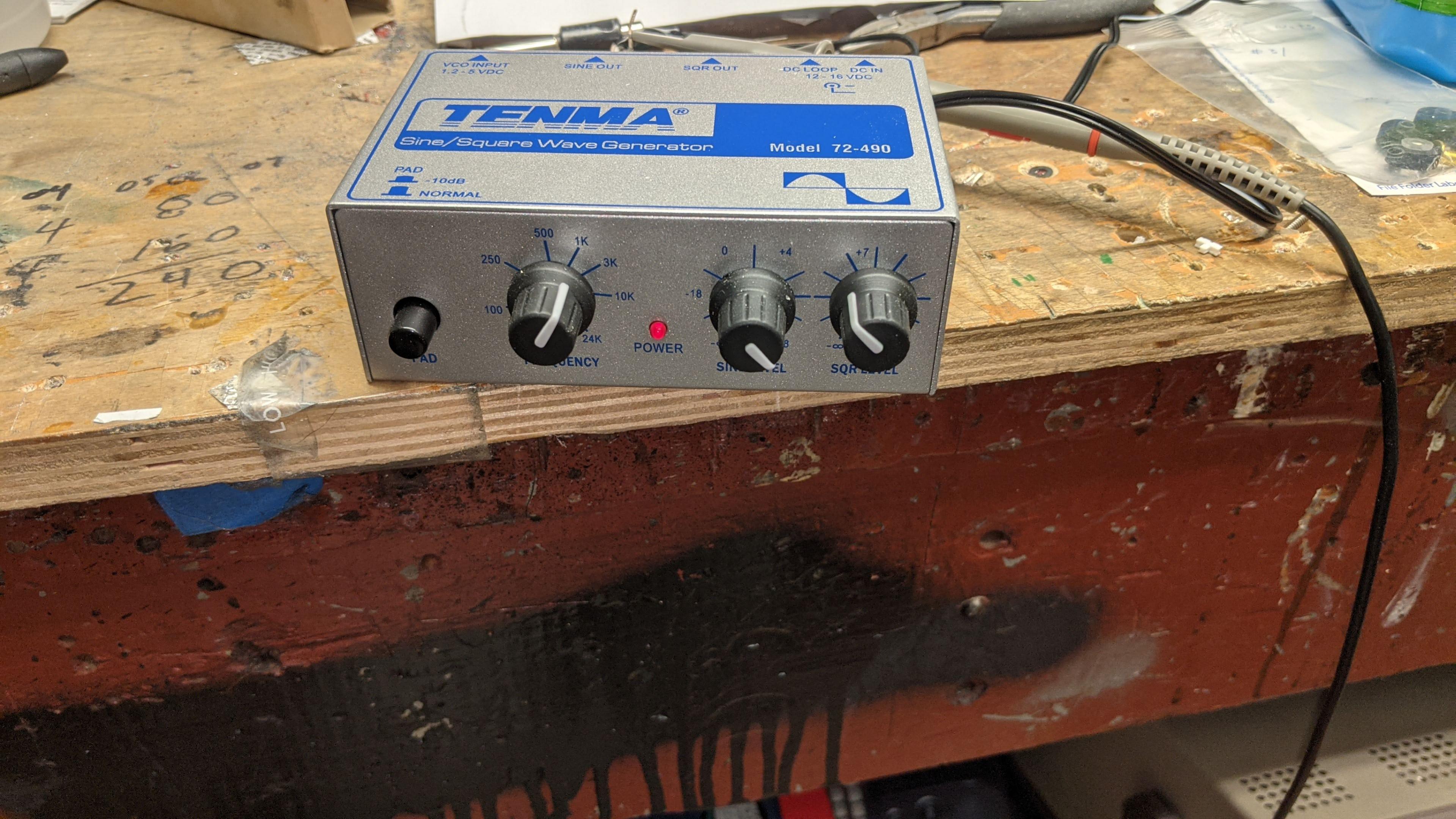

OK. Thanks. I do have an oscilloscope as well as two DMVs. When I try and measure the output of the basic frequency generator I get just a flat line on the oscilloscope and not the sine wave I expect. When hooked up to either DMV, I get 0.00mV. I'm not sure what I am doing wrong here.
