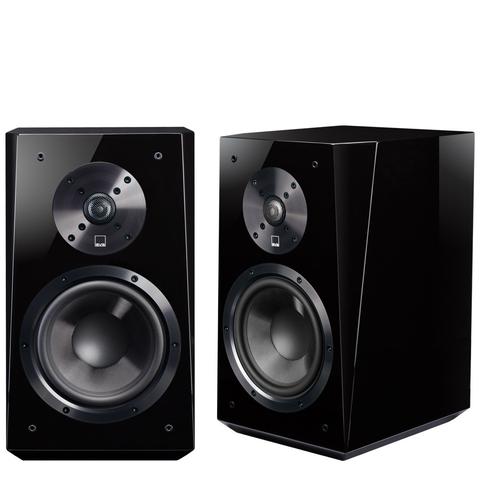

Wih the popularity of small speakers together with such positive reviews of the SVS Ultra Bookshelf I was wondering why I hadn’t seen any attempts to clone ?
Can anybody identify the drivers? Are they Peerless drivers in disguise?

I gather that they take a paper cone driver and 'paint' it with some surface treatment. Whether this is something the manufacturer of the driver does or it's exclusive to them I don't know. The tweeter looks like they've taken something off the shelf and added some plastic thingy, call it a phase plug in ignorance.
They are basically the DA25BG08-06, and either 830990 6.5" glass fiber, or 830991 5.25" version. My guess is the 830991, due to the size.

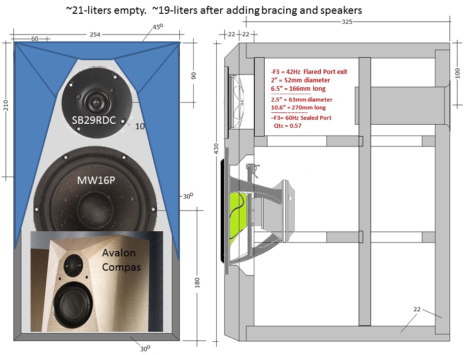

Kalasan thread....You can build a standard vertical baffle and put screw height adjusters under the front to create slanted-baffle T-M time alignment at different distances.
Consider building the Kalasan with the $70 lower cost (almost identical SPL) SB29RDC-4 dome tweeter plus passive L-R-C components which can meet ~ $275/speaker budget. Two cabinets discussed: slanted baffle; pyramid. There is a crossover for the 4-ohm MW16P-4, and a crossover for the 8-ohm MW16P-8.
World Famous Designer Jochim Gerhard developed the Kalasan.
measurements post# 699
crossover circuits post# 700
photos post# 801 762 746

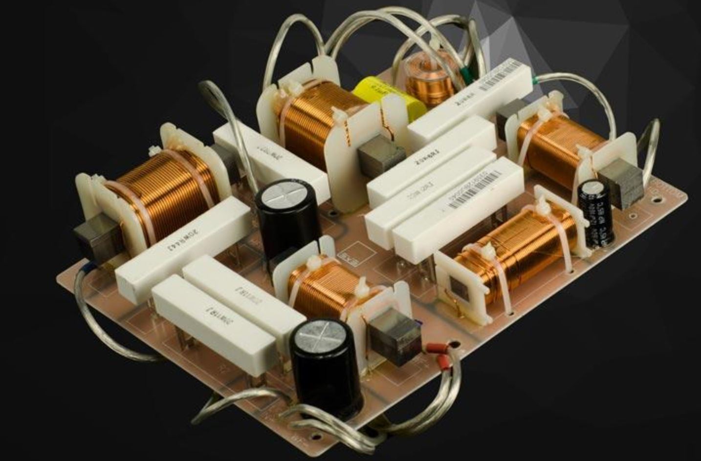

SVS Ultra Bookshelf 2kHz crossover has 18 passive components. One film capacitor(tweeter?), 3 other electrolytic capacitors for cost and size control.
guess:
Tweeter: LR2(CL) + RLC impedance filter + LPAD(R+R)
Woofer: BW3(LCL + series R on C) + RLC impedance filter + RL baffle step?
guess:
My guess is they have a damped third order on the woofer (4), and the 2nd coil has a resistor (1) across it, followed by an LCR notch (4, 2 resistors for power handling or maybe a split LCR + CR kind of circuit with the same cap) centered in the 800-900Hz range for FR, not impedance. A lot of the woven cones tend to exhibit FR resonances in this area. It's likely the FR breakup is tamed by the damped 3rd order. If it's not a damped 3rd order, then it has a damped second order and an RL global BSC filter, but you would lose the benefits of the third order asymmetric setup.
The tweeter has to either be damped second order for phase alignment, or use a 3 resistor L-pad for shaping, or have it's own global RL BSC filter. Otherwise, I cannot figure out why so many resistors. There is definitely a resonance notch LCR. Without the second global BSC filter, I have no idea what the 3rd coil is for.

I don't think that is the crossover for the Ultra Bookshelf. You can see it here @6:20. It is actually a very simple crossover.
This looks like it has been improved, by Dennis Murphy (anyone see Dennis's New improved crossover?)
see post #411 crossover (?) - simple to clone.

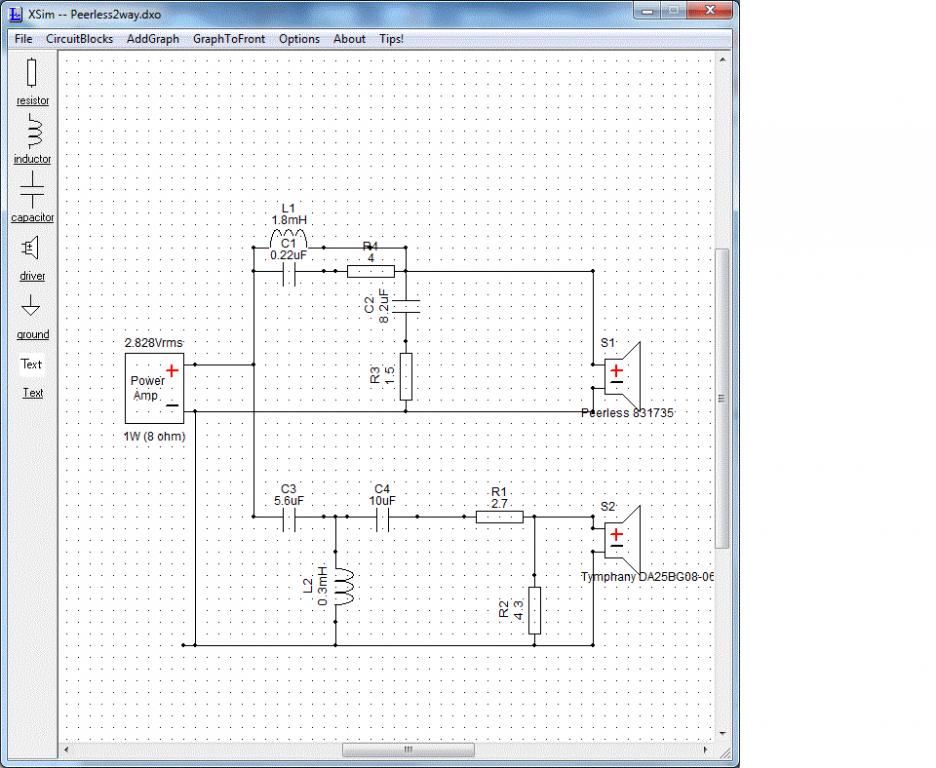

Here's a diy speaker -Glenmore from PE, using the SVS (per Dennis Murphy) tweeter.
The Glenmore crossover has a L-pad on the tweeter to attenuate the tweeter.
You could use this on the SVS crossover.
GlenMore-Peerless 2 way 831735 woofer and new Tymphany DA25BG08-06 tweeter -
Techtalk Speaker Building, Audio, Video Discussion Forum
http://techtalk.parts-express.com/filedata/fetch?id=1192356&d=1434132280

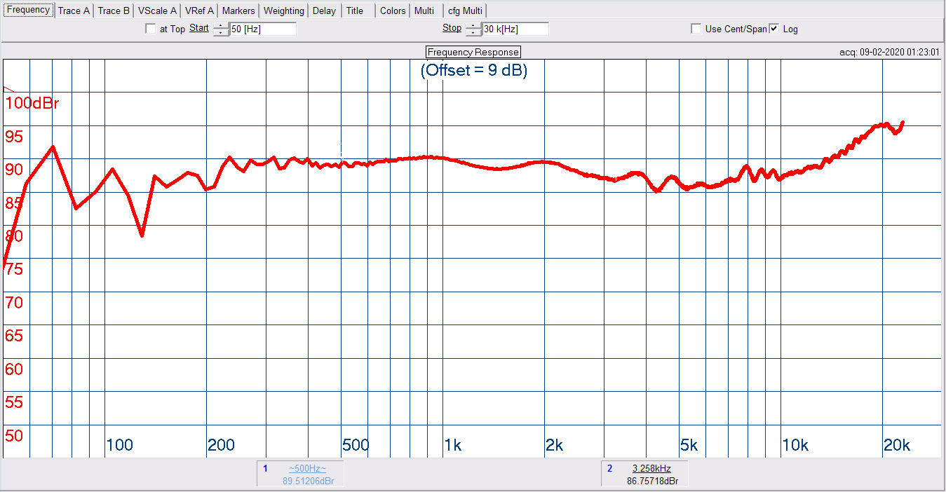

SVS Ultra Bookshelf Speaker Review | Page 21 | Audio Science Review (ASR) Forum
The graph posted shows the SVS Ultra (orig) with no l-pad.
https://www.audiosciencereview.com/forum/index.php?attachments/svs-stock-on-axis-png.82200/
