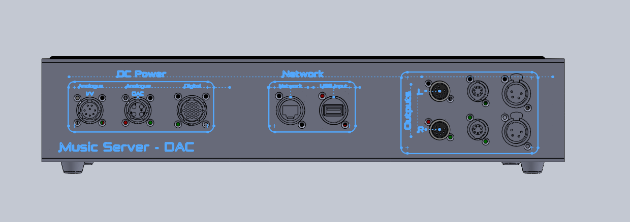

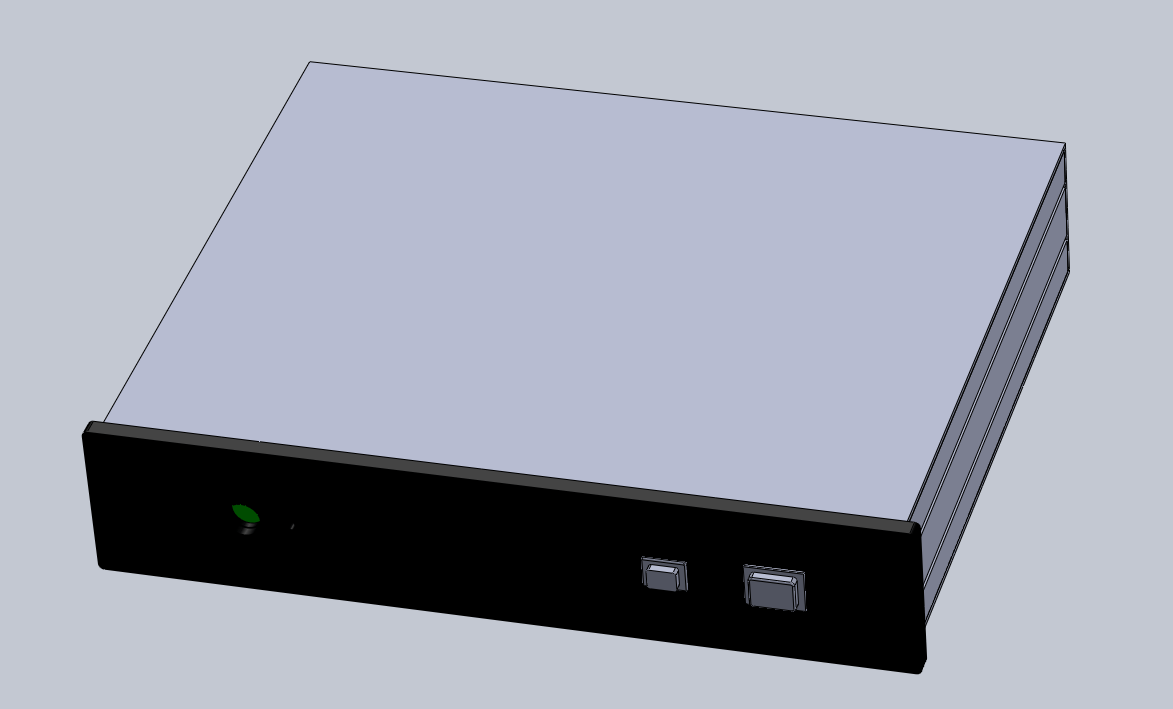

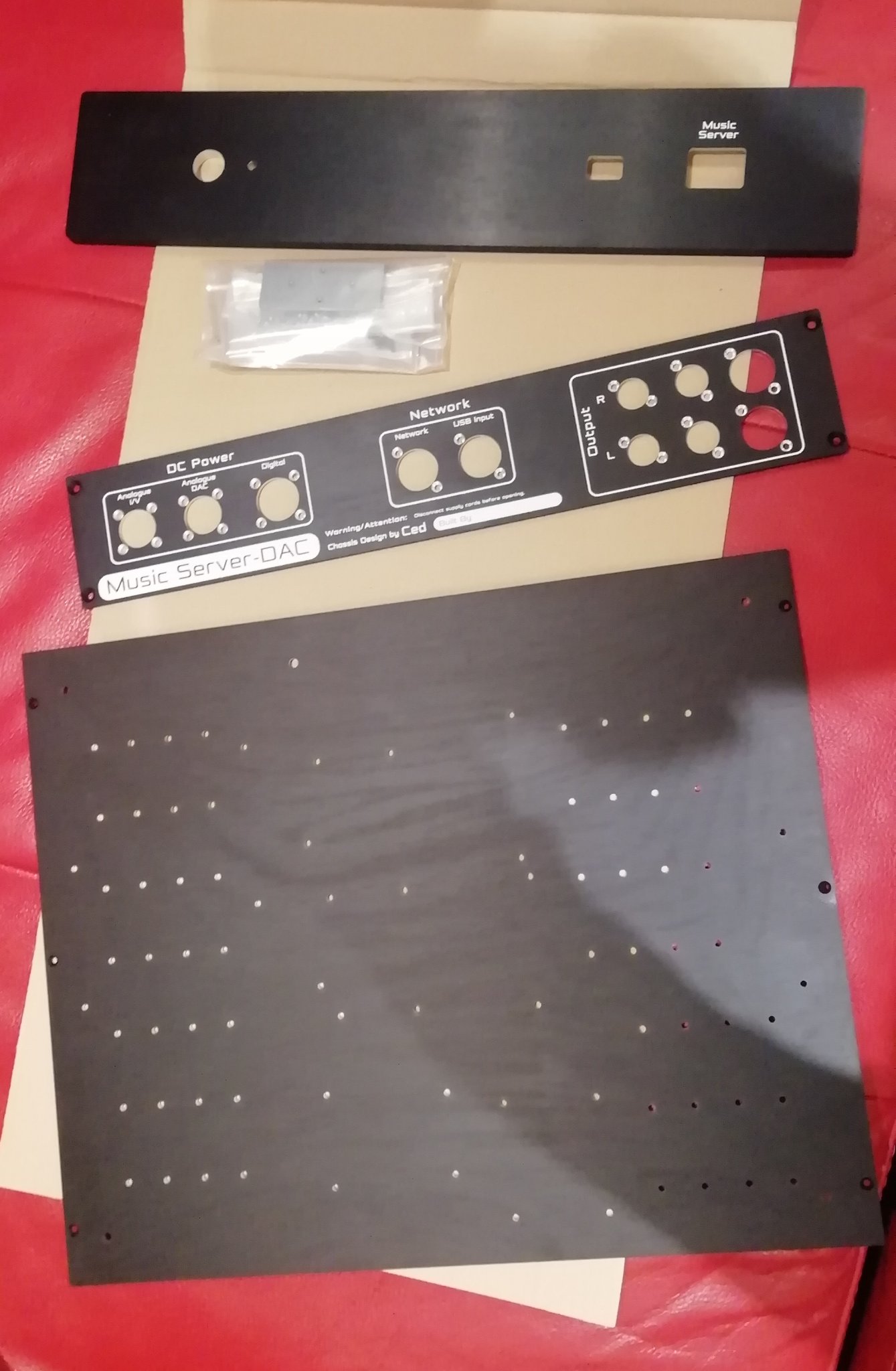

The design plan is:
2 proper Modushop Chassis; 1 for PSUs, 1 for DAC/Music server
DAC:
PSU

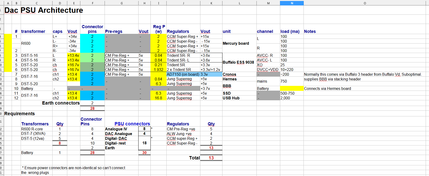

8 Transformers
12 seperate supplies
3 umbilical connectors betweeen PSU and DAC:
So thought Id share the design and build journey, a sort of last salutory swan song to the Twisted Pear digital products. Hope you enjoy, (and it all works out as planned!).

The design plan is:

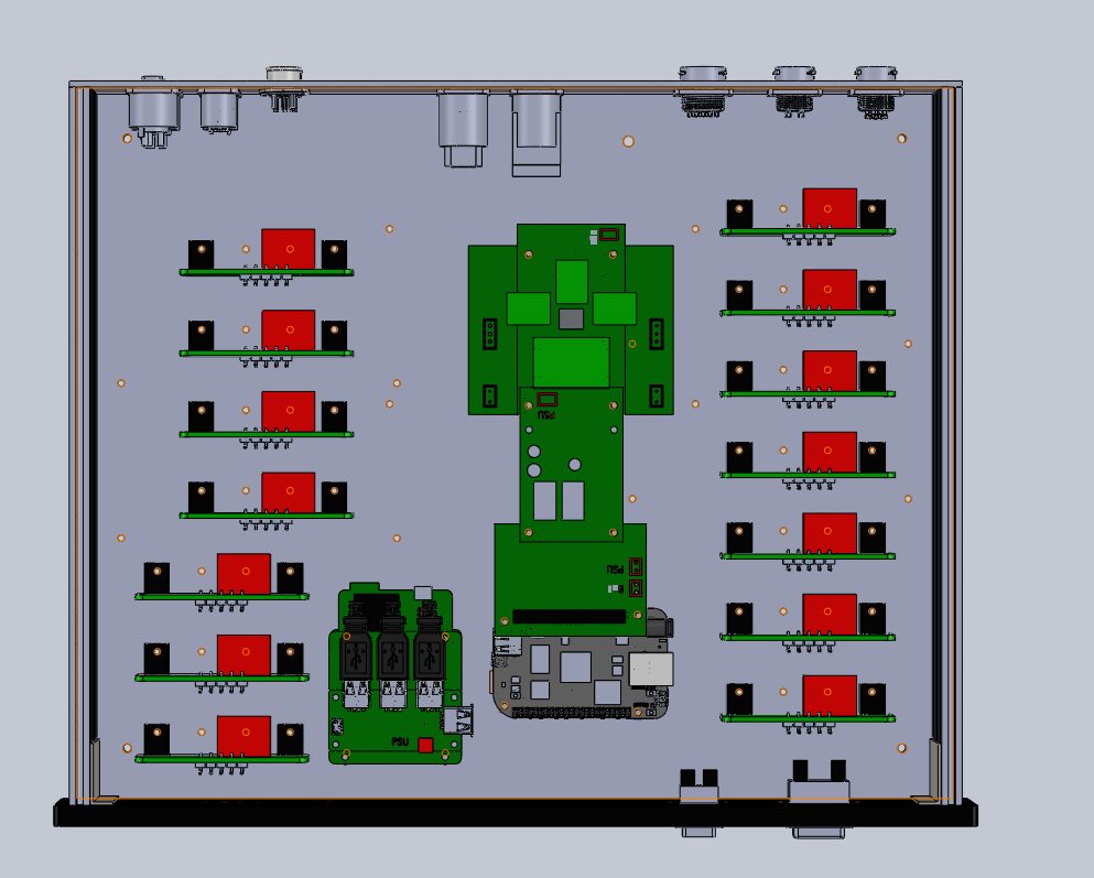

DAC:
- Music served by my old BeagleBoneBlack,
- Music library stored on onboard SSD
- Source clocking using my old Hermes and Cronus.
- USB hub to allow connecting more storage to the BBB.
- Buffalo 9038
- Mercury IV
- Option on Analaogue output filter, something like 6 pole.
14 x cascoded regulators, 1 for every board in the DAC unit
PSU
8 Transformers

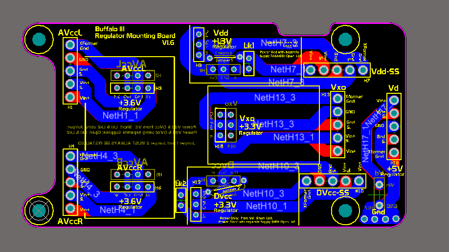

What might be of interest is the daughter board Ive designed for the Buffalo. Sent to fab house yesterday so will be a few days before boards arrive.
One issue is, the Buffalo is designed for a single DC supply via Vd. The tridents tap off this via power and ground planes on the buffalo. Now if you're providing isolated supplies to the buffalo, 4 in my case as recommended by Franco, there is a problem in terms of wiring harnesses.
I've designed for independent supplies, all the way back to the transformers, for:
So I've prototyped this daughter board:
- AVccR
- AVccL
- Vxo
- The digital rest (Vd, DVcc, Vdd)
