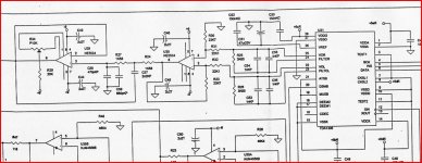

So here just to show what I mean is a simple op-amp swap of the sort that crops up on diyAudio all the time.
The circuit shown was designed for the NE5534 with no external compensation used on the op-amp. A typical scenario then, where everyone has their own ideas and favourites on what to fit. What could possibly go wrong... a double sided PCB with large ground planes with extensive decoupling and local regulators it is a model of impeccable layout.
The opamp we are replacing is U30 that sums the output of the DAC. The two scope traces show the substituted op-amp as the top trace and the original as the lower trace. The scope was on the output of U30
The first picture is of the OPA604 FET opamp, one of my personal favourites. Straight away it is obvious that something is not right... the trace is "thicker", a classic effect of very high frequency instability. This was playing a 1khz track at around -40 db. The frequency of oscillation was around 1.8 Mhz and around 0.6 volts peak to peak.
Second shot is the AD797 op-amp. Here the track played is 1 khz at 0db. As can be seen the op-amp is oscillating like crazy. To see just how crazy look at the next shot.
Third shot is the player in stop mode leaving just the oscillation. It's around 1.4Mhz but at a whopping 6 volts peak to peak.
Fourth shot is the output of the op-amp with a 5pf cap across R33... clean with just a small amount of HF hash from the DAC itself that the following stage (the low pass filter) removes.

Here are some guidelines from another post. Do just ONE of these things and you are likely to have problems. As noted above, the faster the op-amp, the more careful you need to be.
Happy 'op-amping'!
1. run a non-unity gain stable opamp at unity gain
2. run a decompensated opamp without a comp cap, or too small a comp cap for the gain setting
3. fail to fit an isolation resistor (usually about 50 Ohms) in series with the output when driving a real world load - like a cable for example, or a capacitive load.
4. fail to ensure that the junction of the feedback network is located physically very close to the op-amp feedback input pin (usually the inverting input)
5. fail to locate the input filter as physically close as possible to the op-amp input (usually the non-inverting input)
6. fail to decouple the supply rails adequately and close to the opamp supply pins
7. you use an opamp not characterized for wide band audio usage that has an inadequate slew rate
8. Fitting the comp cap across the wrong pins in an uncomensated op-amp (i.e 1-5 instead of 1-8 and vice-a-versa)
9. Failing to scope your physical design out . . . always follow Mooly's example
