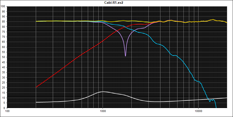

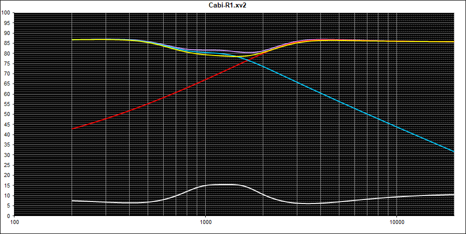

I though it would be useful to illustrate to what extent what I said above is the case. Attached is the response of my main speakers, a pretty standard 2-way with Scan Speak 18W/8545 midwoofer and Seas T25C003 (modded) tweeter. Next is the same crossover with ideal drivers (i.e. basically 8 and 6 ohm resistors, the respective nominal impedances of the drivers). In the real system the drivers have the same polarity; note how in the ideal case there isn't much of a notch with either polarity, rather a wide "valley", and, if anything, the reverse response (purple) is actually higher than the in-phase one.
