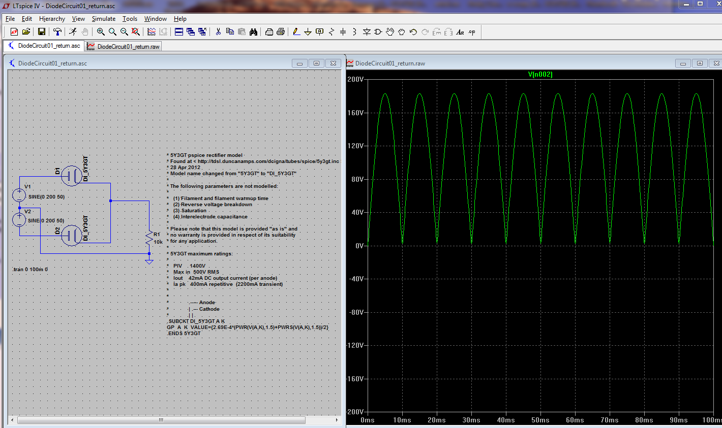

Continuing story
When trying to get this simple rectifier circuit running, I am stumbling across a very frustrating problem:
LTspice is complaining about floating nodes.
Both diodes have floating anode and cathode nodes in this circuit. Whatever I do like
anodes and cathodes grounding via high ohmig resistances, nothing helps.
What am I doing wrong?
Joe.
Joe.

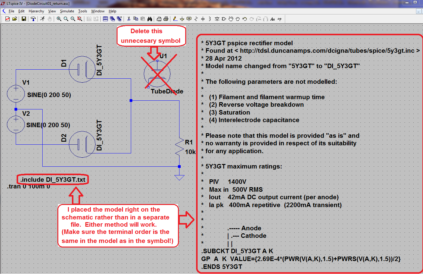

The file you posted doesn't include the diode symbol, but are you sure it only has 2 nodes? Is there a third one still present in the symbol?
Sorry sawreyrw here it is. In the circuitdiagram only.
They do not allow to upload the asy file....
Joe
Diode symbol file is atch. Change name from "TubeDiode.txt" to "TubeDiode.asy". (Downloading the file and changing the name probably takes more effort than simply creating a new symbol from the "triode" symbol, as explained in my first response.)
JoeAlders' file "DiodeCircuit.asc" has an extra instance of the TubeDiode symbol. See atch image. I don't know the details of his "DI_5Y3GT.txt" model so I grabbed one of the models on the 'net, placed it directly on the schematic, and changed the model name. With those changes, the file simulates. See atch screenshot and *.asc files.
Dale
Dale
