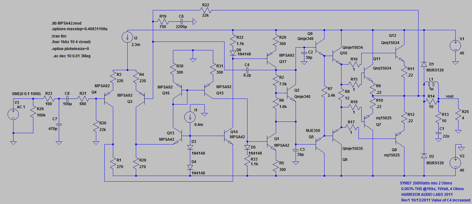

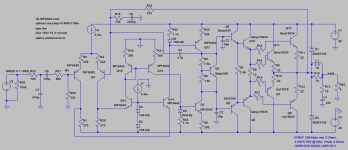

SYMEF T2 Schematic
Schematic link for V 2024: https://www.pcbway.com/project/shareproject/SYMEF_Audio_Power_Amplifier_8bb70aa8.html

![619027d1496242203-symef-amplifier-symefscht1.jpg](https://www.diyaudio.com/forums/attachments/solid-state/619027d1496242203-symef-amplifier-symefscht1.jpg)

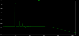

The forum software only allows a limited number of file extensions and 'asc' is not one of them. To post the LTspice file, rename it first - change foo.asc to foo.asc.txt or foo.txt before you upload it. Those downloading it does the opposite before using the file.
Alternately, you can zip the file and then post it.
Here it is. Have fun.please send asc file

Notice: Due to a software glitch, this post by AndrewT is being reposted by me.
Post:

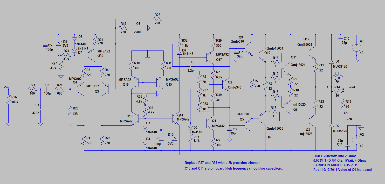

R1 & R28 don't work. The Vdrop with Iq=1.15mA is far too low.
C8 seems to interfere with audio quality.
R8 with Iq~100mA seems good, but R7 with Iq~1mA seems wrong.
Which part of this schematic is loosely based on BA-3?

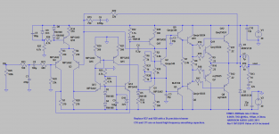

buffer and power supply

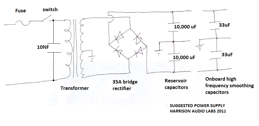

This amplifier can be used with the suggested buffer here http://www.passdiy.com/pdf/B1 Buffer Preamp.pdf or your favorite buffer. The suggested power supply is attached. But feel free to put in your own touch.
Thanks!
I have spare pcb for symasym,
I think that I will use it to build your amp
of course with a few modifications, like reverse input transistors, etc...

Hi Andrew T. did everything work out ?
The amplifier can easily be adapted to use jfets for the input stage.
A Jfet and a cascode should be a good thing to add.
And I don't think Hafler or anyone can patent any of this... fortunately.
Thanks Carlmart,A Jfet and a cascode should be a good thing to add.
The first part of the amplifier (Before VAS) can operate on lower rails lets say +-15V DC thus the cascode may not be necessary.
However I did not notice any advantage over the current design though I stand to be corrected.
Yes this maybe one flavor.
