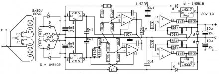

If you like experimenting I have another circuit, just an idea, never tryed it.
The noname C's are perhaps nessesairy to came down the comparators ??
Have fun,
Mona

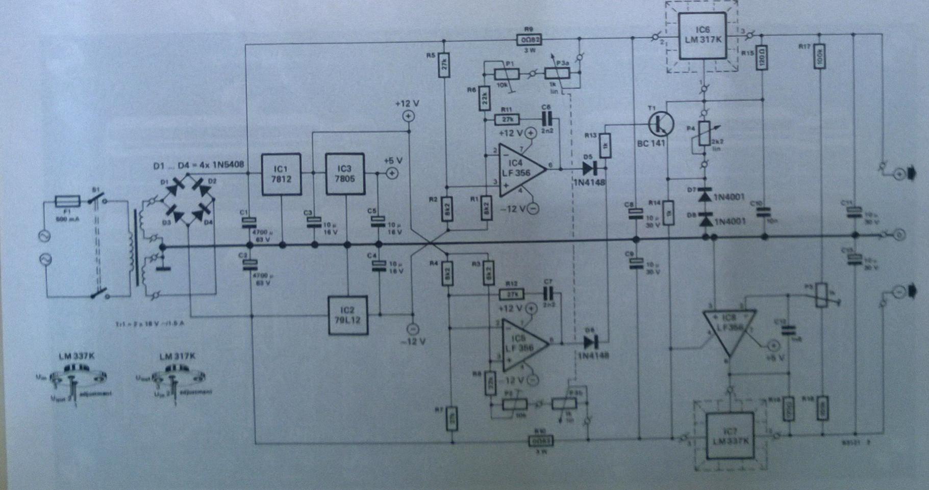

Hi Ketje. That circuit looks a bit like an old Elektor-schematic from my collection (attached, hope it's OK with copyrights).
I don't see how your version works. Do you think that the comparators will work linearly? - or will they just cut voltage completely when activated?
Also not sure how the voltage regulation will work.
Looks very interesting though.

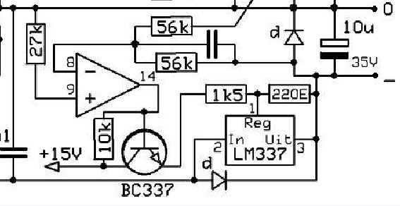

Yes indeed, it looks a bit like my proposal.The LM317 is used directely to regulate the voltage from its ohne 1,25volt reference and the LM337 via an op-amp.
I regulate both sides with an op-amp (comparator= op-amp with open collector out), the reference is 10V on the Vpotm derived from the 7815.
The output from the op-amp goes from approx.-10...+10V for 0...20V out thanks to the 1k5 drop (has a constant current 1.25V/220Ω)
Elektor has two current sensor circuits coupled mechanically (tandem potm).
By inverting one side one can use a single (adj.)treshold voltage.The 100Ω potm gives 0..1V for 0...1A on 1Ω.(A bit better would be the output of another op-amp giving 0-1V)
Too much current pulls the voltage on the Vpotm down until current becomes acceptable.
Mona
Mona

There is something wrong with the schematic
It looks nice symetric but the output of a comparator isn't.The 1k5 from the LM317 is pulled down by the open collecor but the 1k5 on the LM337 side must be pulled UP ! An op-amp pulls both sides but here we need a emitter follower between.
Using real op-amps not comp's is another sollution but then the current limit need diodes like in Elektors schematic, you can't connect two ouputs together like with O.C. outputs.
Mona
I know this thread has been dormant for a long time, but I've been trying to figure out which elektor article this was from, and couldn't identify it.
Can you shed some light on this please?
Which year and month of publication?
