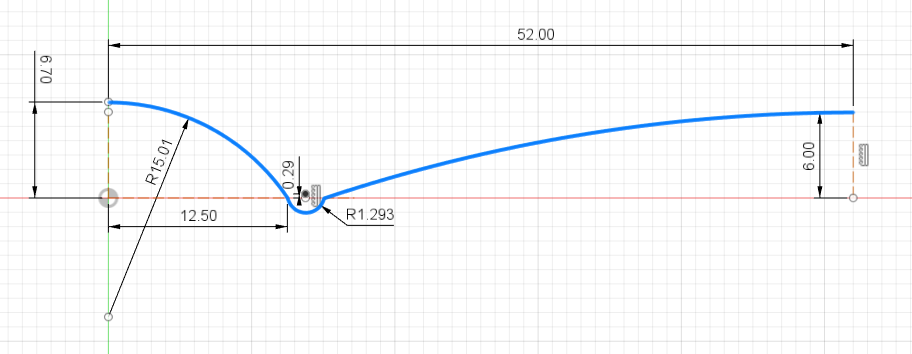

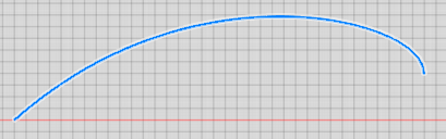

I've simulated many CAD drawn profiles for the T25A in the past and so that is the route I tried next. This should hardly come as news or any kind of discovery as it has been known for a long time that dome tweeters almost always work in a waveguide that uses a section of a circular radius for it's profile. This does not have as dramatic of an effect on the directivity as OS or other proflies can have, but it is that property of not doing too much that allows it to work almost as a universal profile.
It is very simple to draw in a CAD program. I use Fusion and will outline how to use that program to draw it, but the principal could be applied to any other program.

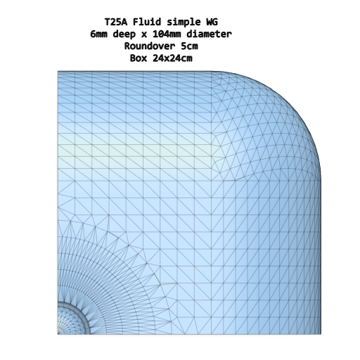

This waveguide is thin at 6mm and relatively small at 104mm in diameter, similar to a standard tweeter faceplate.
I first draw a circle on the XZ plane that represents the throat, in this case it is 29.7mm, using a slightly higher value of 30mm might be preferable depending on the properties of the material being used to print it.
A new sketch is drawn on the XY plane and the previous circle is projected into this sketch. I draw a construction line straight up at the depth of the waveguide in this case 6mm. I then draw another line across at a 90 degree angle the distance of half the overall diameter in this case 52mm. I then draw a 3 point arc between the projected throat, the outer point of the waveguide profile and the last point just needs to be below the top construction line. With practice you can place it so that tangency is already enforced, but if not use the sketch constraints to make the 3 point arc tangent to the top construction line. You can check if this has worked by extending the arc all the way around until it becomes a circle. In this case the 3 point arc as drawn has a radius of 118.01mm.
The centre point of the circle that is the radius can be see by zooming out the sketch, it is highlighted in yellow
The same principal could be used to create a deeper and larger version of the same thing, there will then be a bigger effect on the overall directivity. This may not be a good thing for the T25A, but if the same ratio is kept between depth and outer diameter I would imagine it could be scaled up without creating negative interference. I haven't tested this so I cannot say exactly what will happen.
I have attached the surface profile as a zipped step file in case anyone wants to use it as is to create their own printable model.

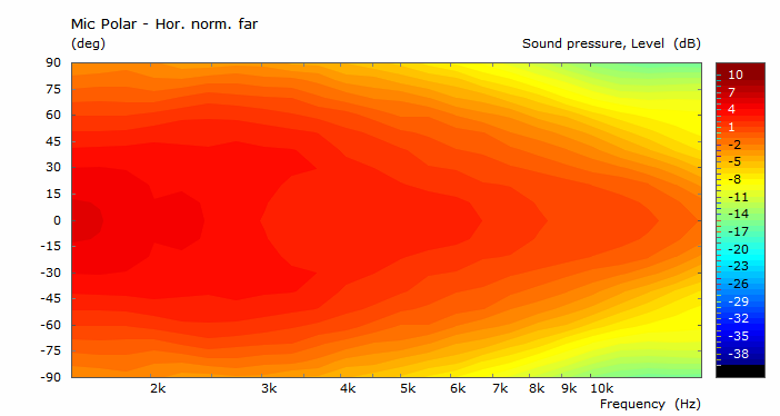

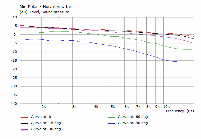

I have attached the simulation outputs based on Jim's baffle. It is more consistent and even than a bare driver and given the size constraints, it fit's on the same diameter as the driver or can be made to. These are non normalized and show 1500 to 15K 0 to 90 degrees in 10 degree steps. The response is pretty much within 1 or 2 dB 0 to 40 degrees and is an even 10 dB down across the board at 90 degrees vs 0.
There is diffraction on axis because this is a BEM model with fully reflective boundaries. All sharp edges and creases on the baffle of which there are a few that are also symmetric show the worst case scenario. A real wooden baffle with smoothed edges and a less symmetric profile would offset this to some extent.
By 15 degrees off axis the response is a pretty smooth downslope

Yes I have the dome and surround modeled for any dome tweeter that I am simulating. It does need to be a reasonably accurate physical match for the actual tweeter and all of the dimensions have an impact on the response that each tweeter will produce.
I have drawings of the Bliesma drivers that I got from the manufacturer. Scan speak and Purifi have CAD models of their drivers that could be used to extract the information. With, time and some non magnetic measuring tools any driver could be physically measured to get close enough dimensions.
Hard domes are required for accurate simulation with only BEM.

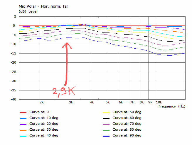

If I understand correctly, with this Akabak BEM, the assumption is that the dome and suspension have a linear behaviour.Hard domes are required for accurate simulation with only BEM.
So the most important thing is the surface geometry...

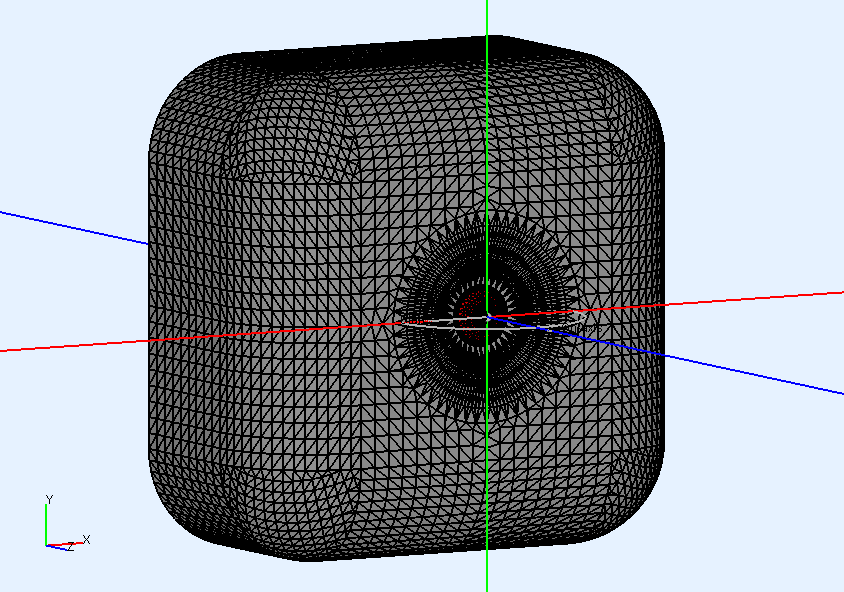

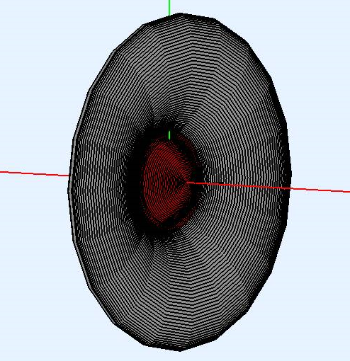

I've launched Akabak last night for the first time and run the waveguide profile with a flat source diaphragm, to test the sofware.
Not very successful. There was mistakes in the observations settings.
Now I must draw the tweeter 3d model, starting with a simple spherical dome and flast suspension.
If the results are closed to yours, I could go futher.
Thomas
Everything is modeled as reflective and infinitely stiff unless damping is applied. The surface geometry is important and getting a good mesh to use in a manual design can take some experience, this is one area where Ath is very good if it works for the design.If I understand correctly, with this Akabak BEM, the assumption is that the dome and suspension have a linear behaviour.
A flat source is fine to simulate a compression driver but a dome tweeter is quite different. Observation settings are easy to change in AKABAK but choosing the correct plane to put them on can be a head scratcher sometimes. Use the spectrum hints to show you where start axis is and the direction the observations are going. I have vertical up to 90 and horizontal right to 90 in this example. If it was to 180 the grey arc would extend to the green lineI've launched Akabak last night for the first time and run the waveguide profile with a flat source diaphragm, to test the sofware.

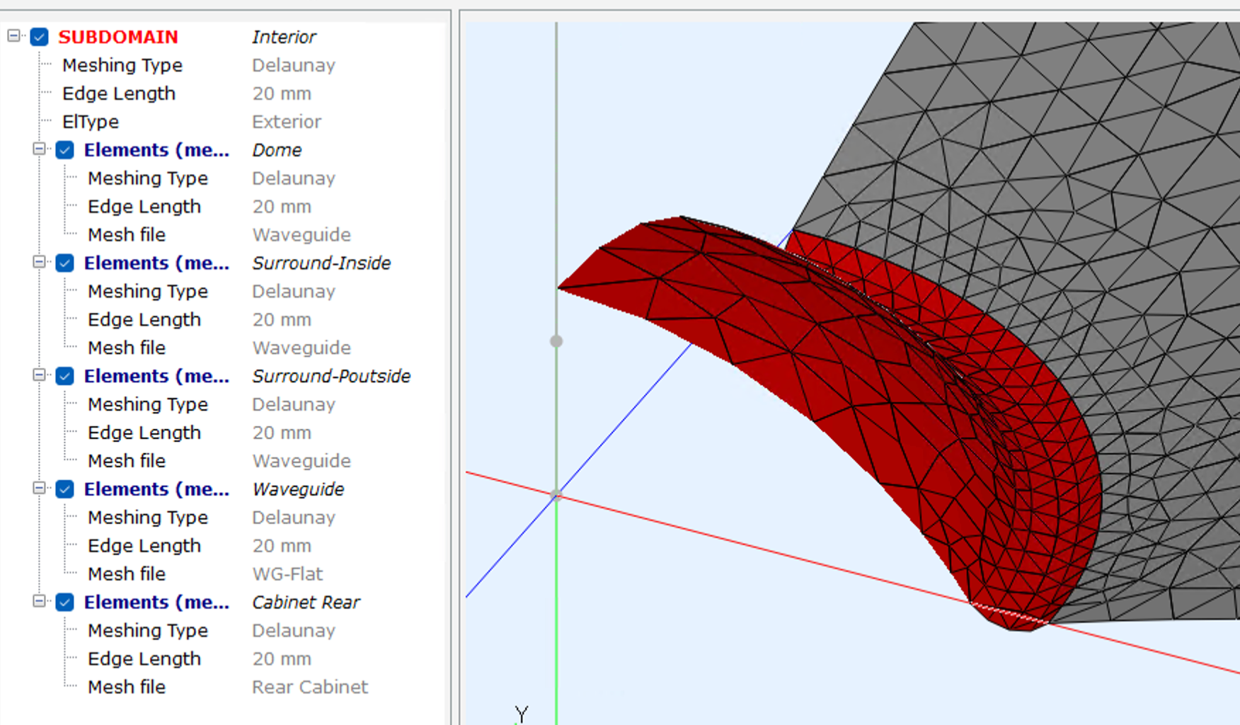

Some hours later learning Akabak with this "Fluid simple waveguide" ...

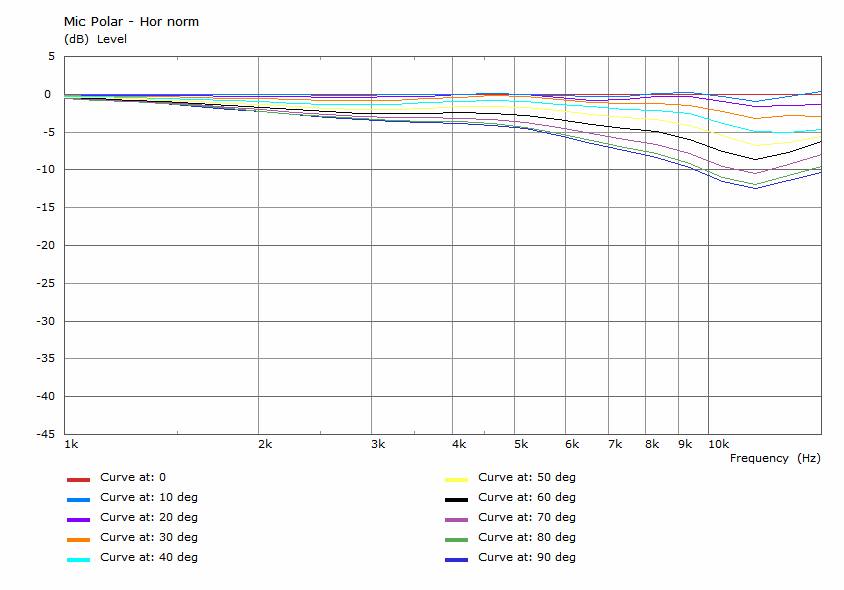

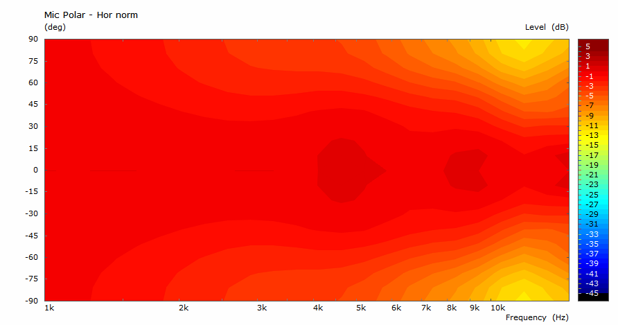

T25A-6
It is based on the T25B, I changed only the dome height, not the surround.
Box model
Simulation Normalized
Horizontal, 1m distance, farfield
Normalized at 0°
Fixed driving, amplification 1 and no weighting
1500 Hz to 15k Hz
Simulation Non normalized
Test non normalized
Fixed driving at 0.2
Weighting Divide by JW

I don' have success to simulate in infinite baffle because the apex of the dome is higher than the waveguide.
I'll could make a big baffle in Fusion maybe 2x the wavelength.
Is it enough ?
That's ok with the WG scale x2 in IB. I'll share later.

These are the settings I use and I do split the surround.
I almost always simulate non normalised and then duplicate the graph in VACS and add normalisation to that.
As far as I know the T25B and A surrounds have the same diameter and shape.
It hasn't created an issue in your simulation but watch out for creating meshes with CAD programs as they produce long thin triangles like in your waveguide. These can be a problem for correct simulation and BEM in general works much better when the traingles are even on all sides.
You also have to consider that with big roundovers on all sides you can sometimes see effects from sound going all the way around and when the simulation ends up sqaure there are two dimensions that can reinforce or cancel, which is unlikely to be true in a real speaker.
The T25B will also respond better to deeper profiles than the T25A if you want to try them out.

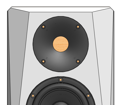

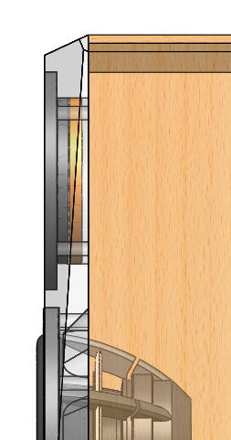

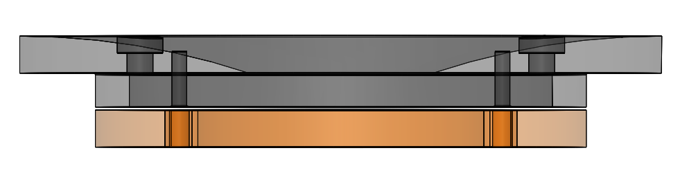

Thinking about to give it a try:
Thanks a lot for the design! 👍 🙂
An SLA print in Nylon would look nice, if you decide to give it a try let me know how it goes 🙂Thinking about to give it a try:

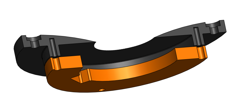

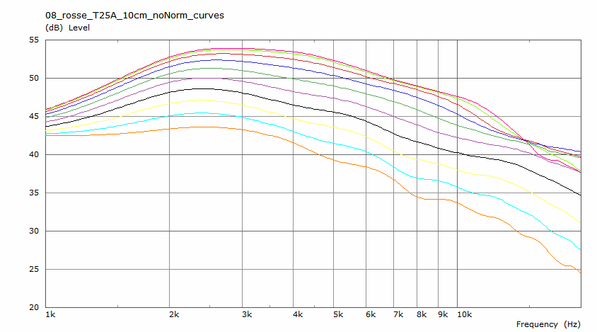

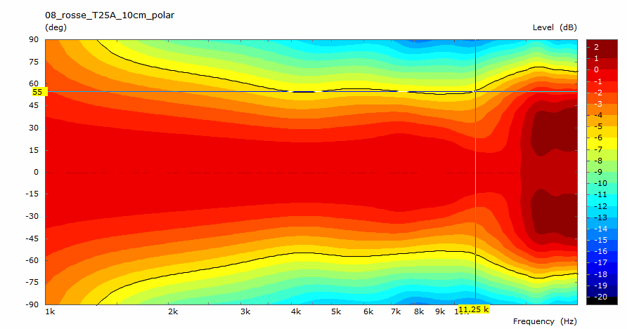

New try...
This a free standing waveguide.
It has been generated with ATH Rosse, thanks to @mabat !
Diameter 10cm, depth 9mm
It may be possible to integrate it in a baffle with some work or rework.
The top looks ugly but the T25A starts to widen after 12K Hz.
IHMO this could add some "air" but simply nothing wrong for the old ears. 🙂
Thomas

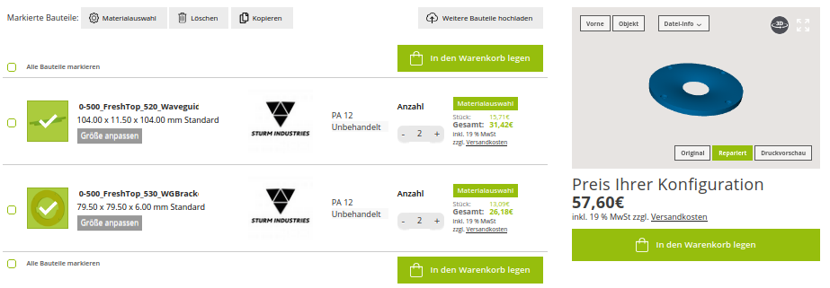

Just ordered the parts few days ago, PA12 material. Will paint it black then, have a small 2k lacquer 150ml spray can left over I will spend on this. 104mm diameter / 6mm depth are ideal to ensure exchangeability with other tweeters from Seas, Scan Speak, SB etc. Circle Diameter is 92mm so I can directly replace a Seas DXT in my current speaker for initial test. Will post measurements but it might take few weeks until the parts arrive and find time to do the sweeps....
This is because the profile is too deep for the nominal width of it, it is the reason why the T25A is so fickle in most existing waveguides.The top looks ugly but the T25A starts to widen after 12K Hz.
Where the profile ends before the termination begins is quite a bit less than 10cm.
Yes the tall dome with too deep profile creates diffraction.
I don't know how much this effect can be heard at those frequencies.
Is the control at the lower FR range worths this trade off ?
