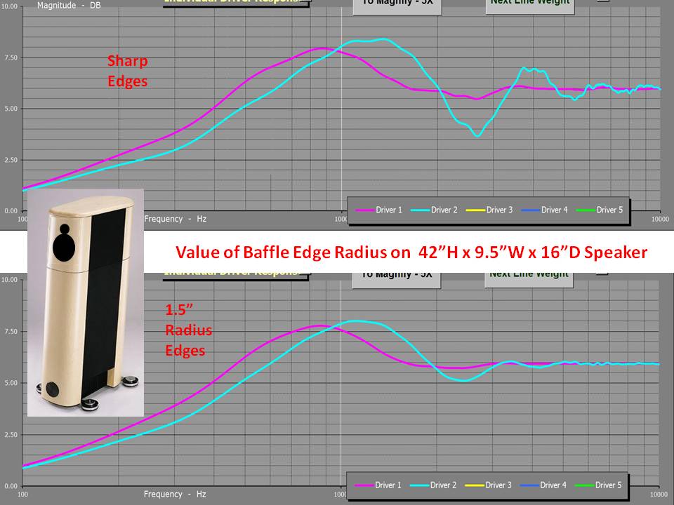

You'll also have to deal with the baffle, where most of your sound is given away at the edges of a narrow cabinet. The frequency where this happens is in the midrange or lower treble where ears are sensitive. There can be response changes around here and plenty of sound to get involved in room reflections.

Some tall-and-narrow 3-way speakers produce FULL RANGE sound by using a pair of side mounted woofers. The Audio Physic speakers are one example of 1" dome + 5" midbass + side-side woofers for counter-force vibration reduction. Sharp cabinet edges generate audible diffraction distortion, and a 1-1.5" radius routed quater round curve is often used, and naturally this increases cabinet width.

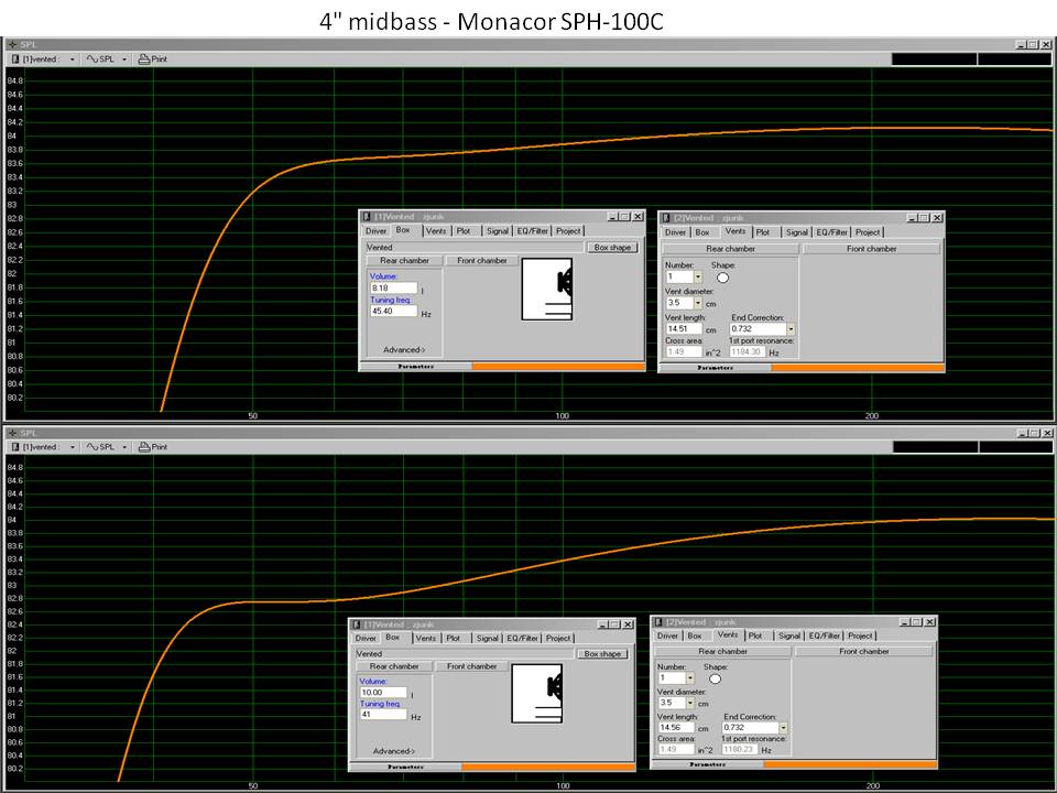

A 10 liter internal volume will get reduced by the volume of the two speakers and some bracing.
The website T/S parameters for the Monacor SPH-100C model a Butterworth alignment with 8.2l volume tuned to 45Hz using a 3.5cm diameter port 14.5cm long. A deeper(>60mm since speaker is 50mm) box would help reduce rear cone reflections and allow adequate room for rear absorption material.
The website T/S parameters for the Monacor SPH-100C model a modest bass shelf alignment with 10l volume tuned to 41Hz using a 3.5cm diameter port 14.5cm long. Room bass gain from walls would add to the bass shelf and likely produce modestly flat SPLs, so this is also a good option.

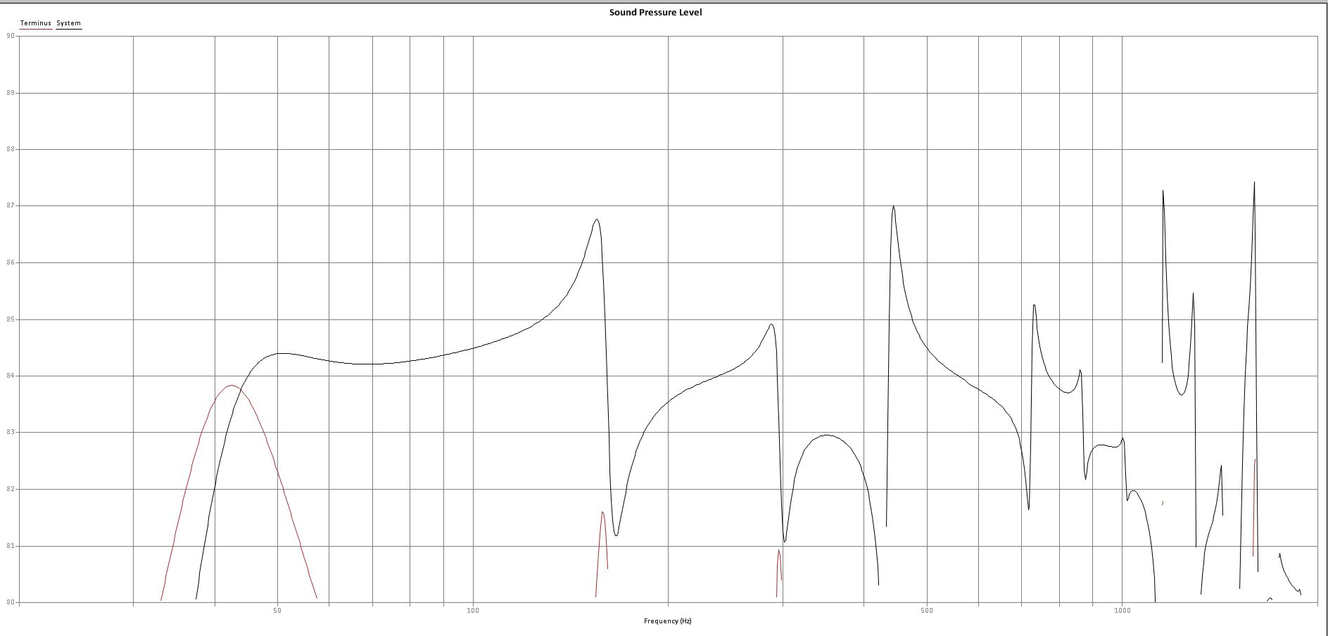

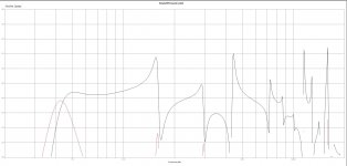

Since the SPH-100C covers up to the 1.5-2Khz tweeter, using a full range Transmission Line Simulator illustrates that the 1200mm X 140mm X 60mm box generates internal resonances, which proper cross bracing and on-wall absorption material can help to reduce. Transmission lines(and MLTL) tune the rear air exit path dimensions and box stuffing to reduce these resonances with good bass-gain and modest internal reflections. A deeper(>60mm since speaker is 50mm) box, with calculated placement of the speaker and port are necessary for a TL(MLTL) design. Folks here can help.
