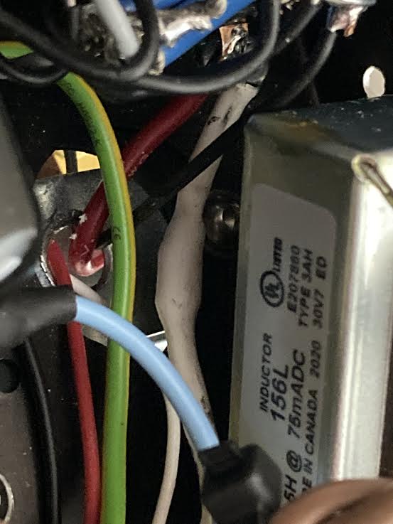

The feedback is very hard to make out on the picture. I see the twisted red and black wires for feeding the filament of the 6J5. But I can't detect a third wire for feedback going to the cathode resistors of a 6J5 (there have to be two resistors because an electrolytic capacitor seems to be bypassing one of them).
You will see a mid point in the two Cathode R for the 6J5 that feed off to the feedback resistor in the heat shrink just before the + Spkr terminal .
Will likely put a piece of small tag strip off one lug of the DC choke so different CFB resistors can be applied .

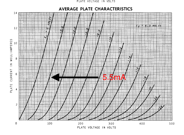

What are the cathode and anode voltages of the 6J5?
Here is the chosen operating point, with Ohms Law you will be able to work out the voltage across the 30K /5 watt Plate R .

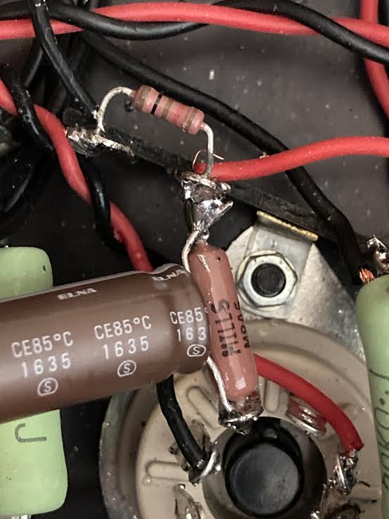

Why grid stoppers with a 30 Watt rating? And why/when would you drive the EL84's into the grid current region? And if so, what difference would 300 Ohm than make?
The 6J5 is probably not so prone to oscillate. But in your amplifier the grid stoppers for the 6J5 are soldered straight onto the tube socket anyway. But the grid stoppers at the tube socktes of the EL84's are not. The EL84 is a pretty steep tube so I advise you (again) to solder those grid stoppers straight to the tube socket. To write that this good practice while not following that practice seems weird to me.

Anything directly in the signal path will influence the sound of an amplifier , hence using the best component possible that is non inductive is very important .
