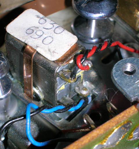

-I´m planning to put one head from another tandberg 15 recorder as a playbackhead and put a swich for which head to listen to.
I think it has seperate circuits becouse of the different frequency responce of the two heads recorder normally have.
The azimuth is not realy the biggist problem (I hope... 🙂 ) though it would be a lo-fi ecco effect.

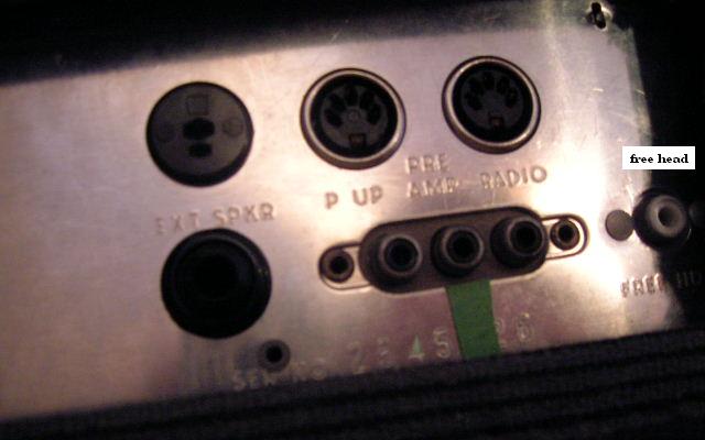

What is the 4 cables for? check picture!

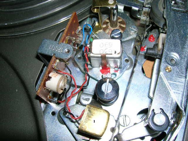

I´m trying to modify my 2 head machine to a 3 head....
just need to know if it´s realy possible and the control functions.
here are the pix:
http://www.oplen.com/tandberg1.jpg
http://www.oplen.com/tandberg2backside.jpg

You can pick up second-hand professional three-headed machines very cheaply nowadays, so unless you want to learn about tape machine design, I'd give modifying the Tandberg a miss. You see, a three-headed machine has a set of record electronics and a set of replay electronics. Now, you could modify a phono stage to be a tape replay amplifier, but it all seems a lot of work...
Most domestic machines have one set of amps, with fairly comlex switching to cater for record / replay requirements.
I don't have Series 15 ccts to hand, but certainly even some of the more 'professional' Tandbergs had shared amps.
If you want to use 'mechanical' methods to vary delay, try a cam between the heads, running on the tape, which will vary loop length. for worthwhile effects, you will also want to feed back the output of the replay head to the record side (with variable gain).

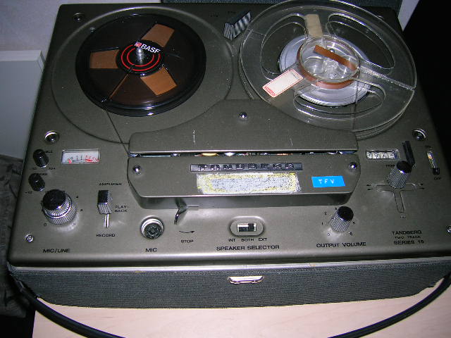

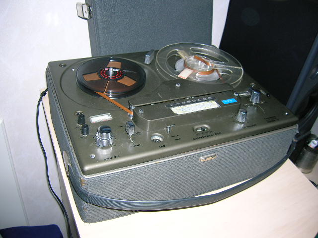

HM.. I see your picture,.. but just for the record- could you post a pic' of the whole unit.....
The Tandberg history link clearly states 3-heads for the model 15...
I cannot recall specifically ever having used a '15, but I did use a lot of the old "stick shift" models.....
They were very much the de facto standard for tape recorders in Norway in the late 60s and early 70s....
Ah!
The standard models had two heads, but some models were available with an extra 'free head'.
This is just as it sounds - a head which isn't connected to anything (except a socket). It was intended for slide sync, and similar applications. I'm not certain, but I'd expect it to operate in the guard band area, ouside the audio recording, so it wouldn't be much help for your application.
