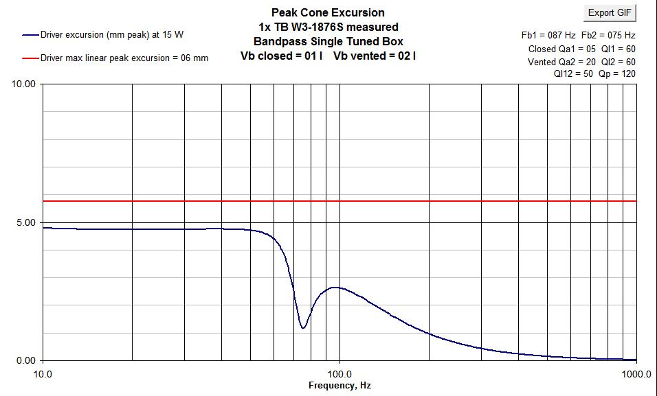

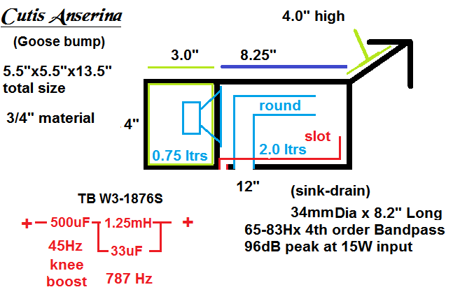

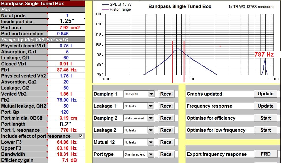

I plan on building this little boomer attached below... 15W for 95dB output.
Otherwise, it's good vented or PR loaded in about 2 ltrs, as long as you have a 30Hz active highpass to keep the Xmax in check.
