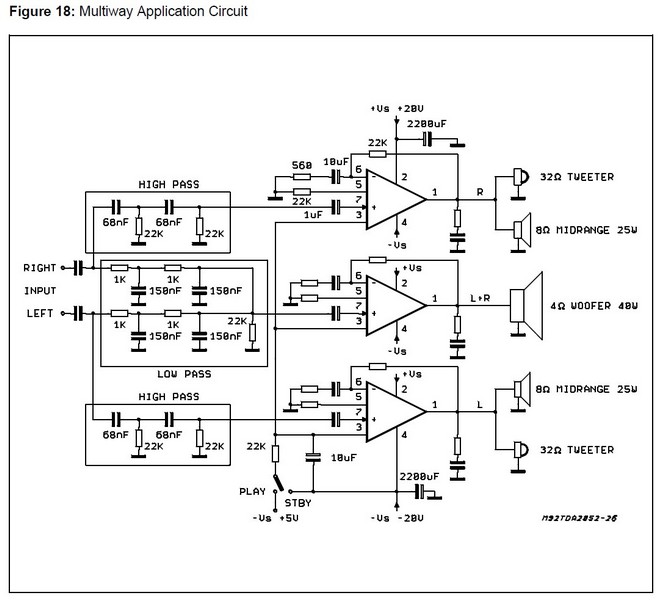

The ST made TDA2052 chips are fed by a heavy 2 x 15 V toroid and so performance is limited to 2 x 20 W. It sounds very good with the mods whatever the datasheets may say. Distortion figures are just very small in differences and AFAIK they're specified at the max. power the chip can deliver. Output current of TDA2052 is 6 A max. and TDA2030 is 3,5 A max. It would be unlogical if the distortion figures would not differ with these largely different currents.
TDA2030 is also from another era... TDA2052 is a modern very good sounding chip and it would be strange if it did not sound and measure better that TDA2030. I was very surprised when I heard the amp after the mods. In fact I still have the amp connected as I like it a lot. better than my other amps I have now. For just a moment I thought of designing a replacement PCB of better quality to fit in the Amp-30. No time for that unfortunately.

I find interesting the "Multiway Application Circuit" with PLLXO's (Figure 18 - page 10/14) in the TDA2052 Datasheet.pdf... certainly the Sub-out of the AMP-30 uses a part of this schématics.
Just a question : when you switched from NE5532's to LME49860's in your mod, had you to change some other parts or just it was totally compatible ?
