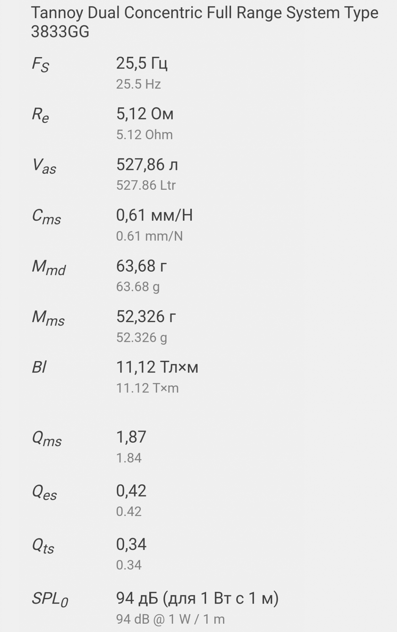

Would you be willing to advise me what portsize to use? Cabinet is +/-145-150LComing a bit late to the 'party' with the usual disclaimers; Vas, Qts' are 'open' from at least ~430-528 L, 0.34 - 0.42 Qts when including these, so using its mean:
sqrt(430*528) = ~476 L mean Vas
sqrt(25.5*27.4) = 26.43 Hz Fs mean
sqrt(5.12*5.5) = 5.31 ohms Re
sqrt(1.87*1.2) = 1.5 Qms
sqrt(0.42*0.537) = 0.475 Qes
0.361 calc'd Qts
0.5 ohm (Rs) = 0.386 Qts'
sqrt(0.34*042) = 0.378 Qts mean Vs 0.361 calc'd!
pioneer's reflex cab ratio = ~476/1.44 = ~331 L net (personal minimum based on Qts').
Below this point, sealed alignment Vb calcs seem more relevant:
265 L
(a) = ~476/265 = ~1.76
Qtc = sqrt(1.76+1)*0.386 = 0.645
Fc = (0.645*26.43)/0.386 = ~44 Hz
BR Fb = 0.645/0.5 = 1.29
26.43/1.29 = 20.5 Hz

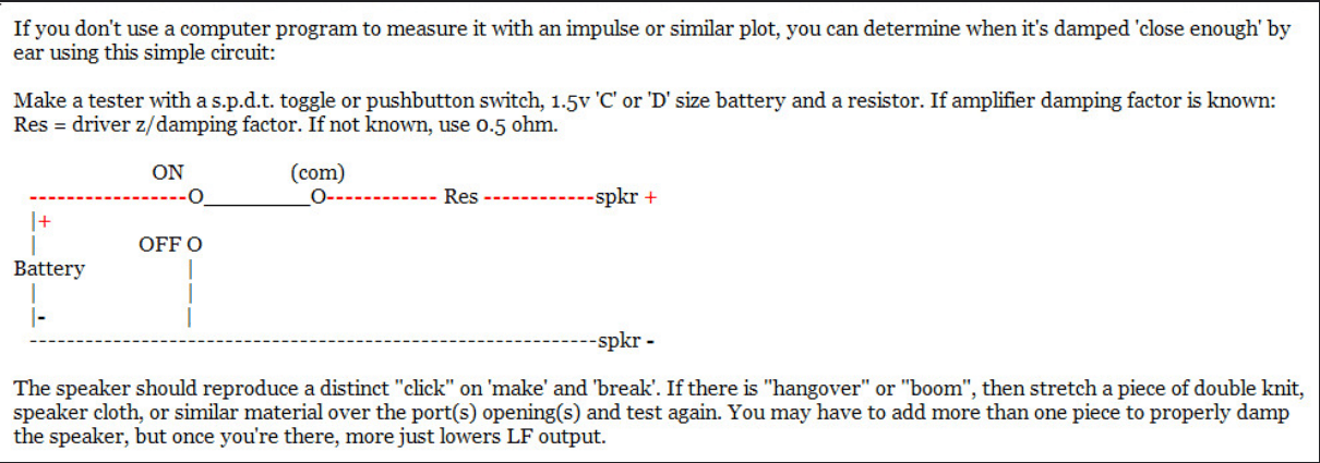

These vented tunings come closest to sealed re group delay, etc., but simmed with Fs tuning isn't much different and superior if driven with a high output impedance amp.
All that said, the 3833 and 3836 are supposed to be identical spec wise, but based on a 339 cm^2 (Sd), low Fs and ridiculously low Qms, the posted 3833 specs are pure 'floobydust' in that the T/S specs' Cms, Mmd, BL are just small fractions according to HR, so sure would be nice to get some measured specs!
I feel very bad about providing the wrong data in my earlier post. And don't understand what the calculations say.

145 L 3836 specs with minimal added series resistance:
(a) = 430/145 = 2.966
Qtc = sqrt(2.966+1)*0.43 = 0.856
Fc = (0.856*27.4)/0.43 = ~54.55 Hz
BR Fc ratio = 0.856/0.5 = 1.712
27.4/1.712 = 16 Hz Fb
Per HR, this tuning is so far below Fs required to flatten its somewhat high sealed Qtc that it's limited to ~ 4 W/40 Hz/2pi (spaced away from any significant wall/corner loading), though tuning it an octave higher (32 Hz) increases it to 14 W/40 Hz with a calc'd ~3 dB/70 Hz peak referenced to its mid band efficiency, so ideally needs a HP filter to protect it.
Assuming this is OK, then a ~ 4" dia. x 3.5" long vent peaks out at ~ 9 m/s @ 14 W and critically damp the vent to 'taste' to get a great compromise between the two tunings or stuff it to ~ mimic the 16 Hz tuning, though obviously with some power handling loss.
