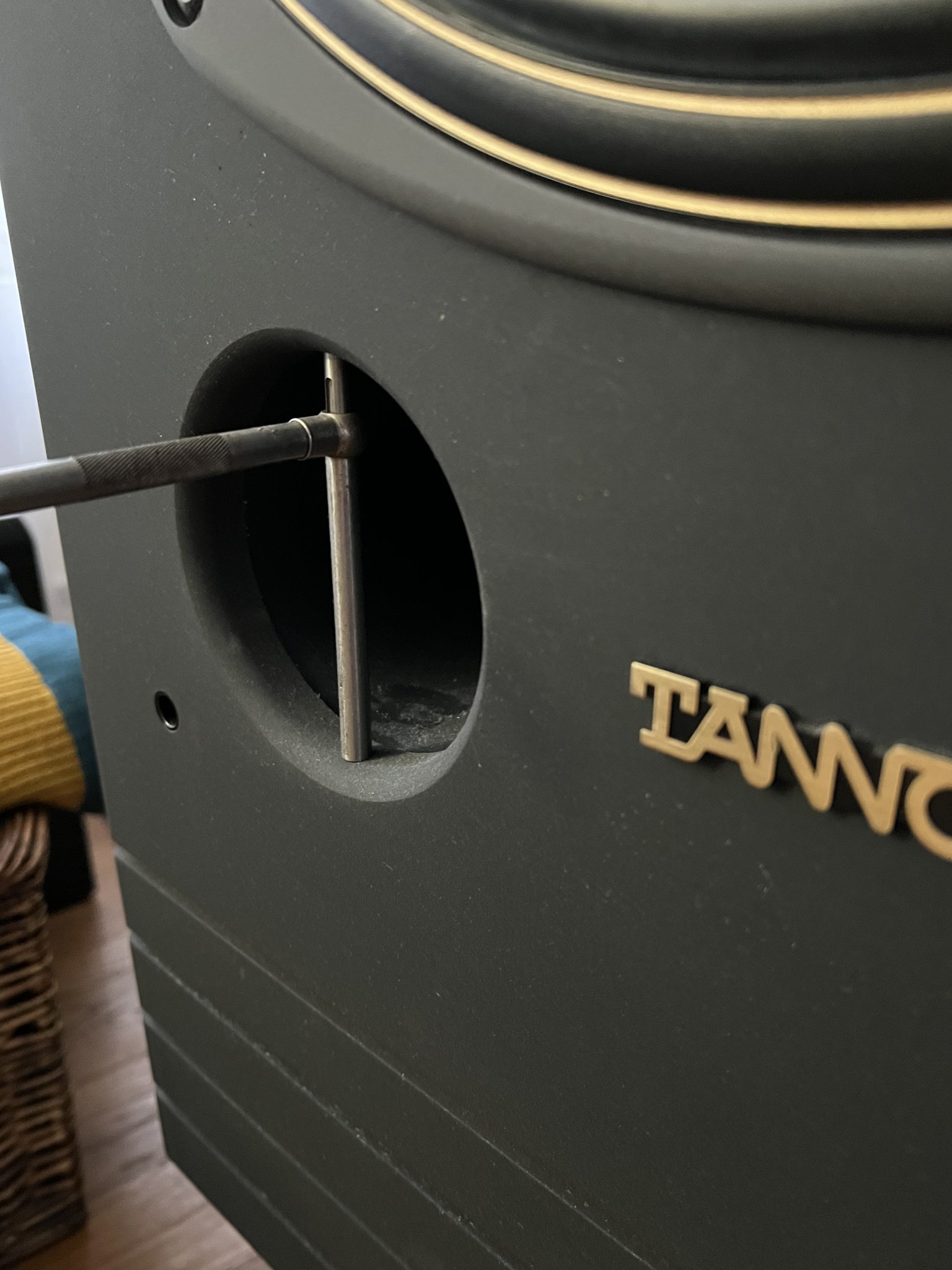

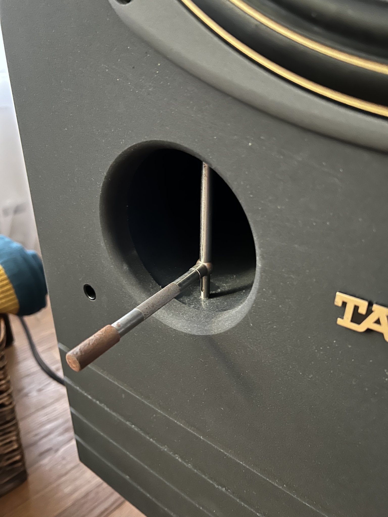

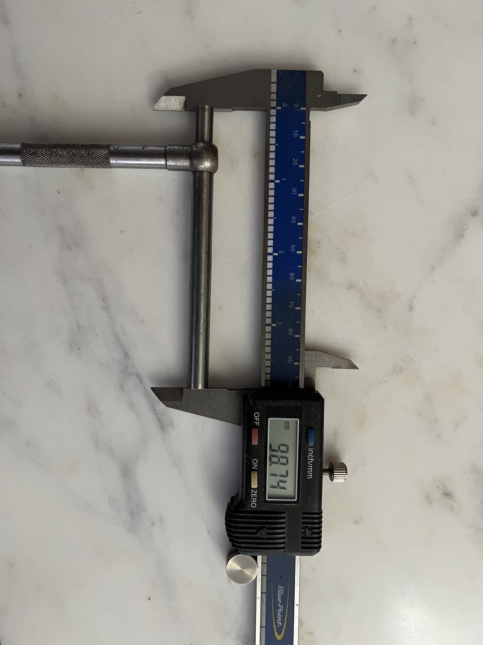

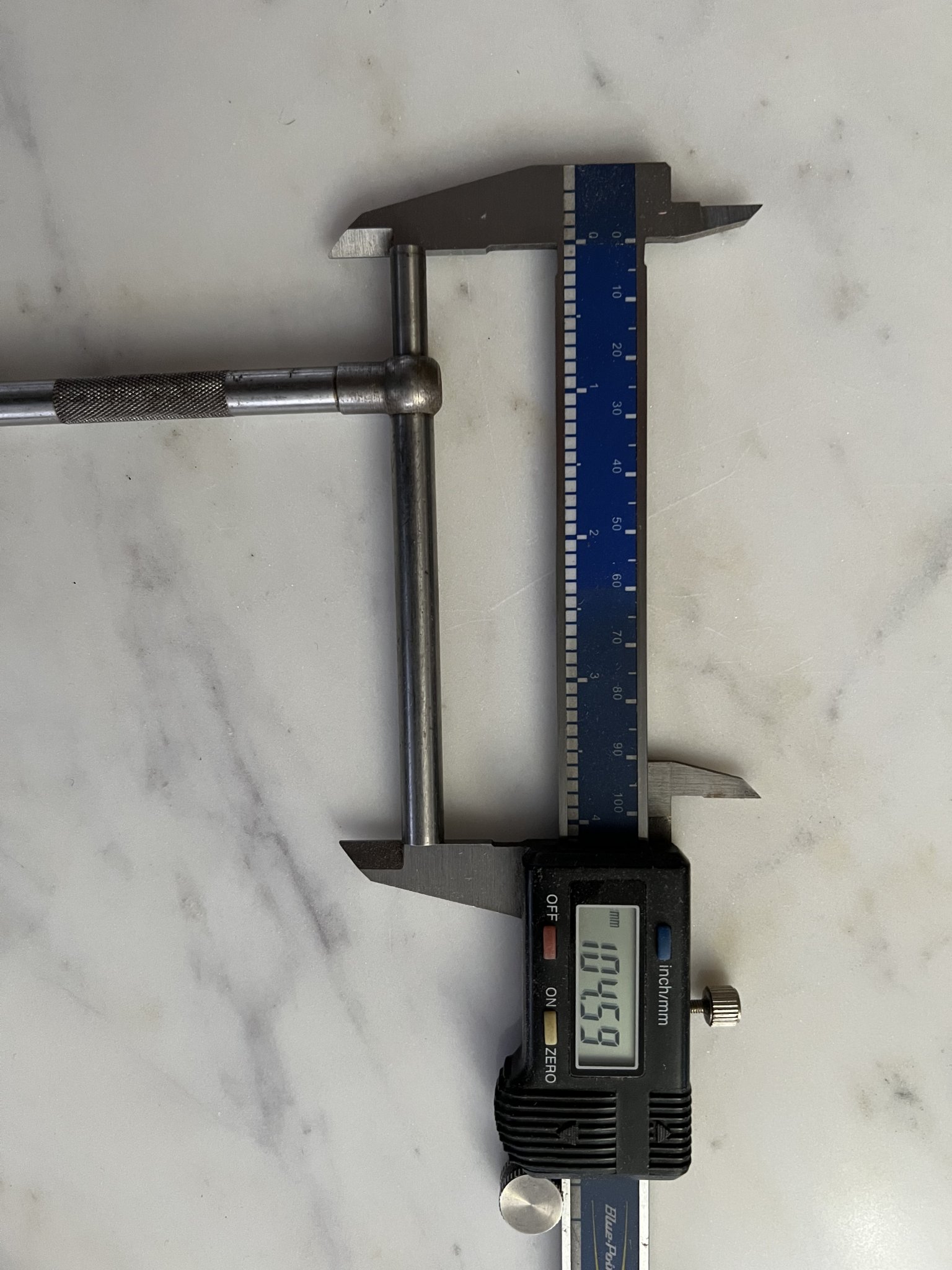

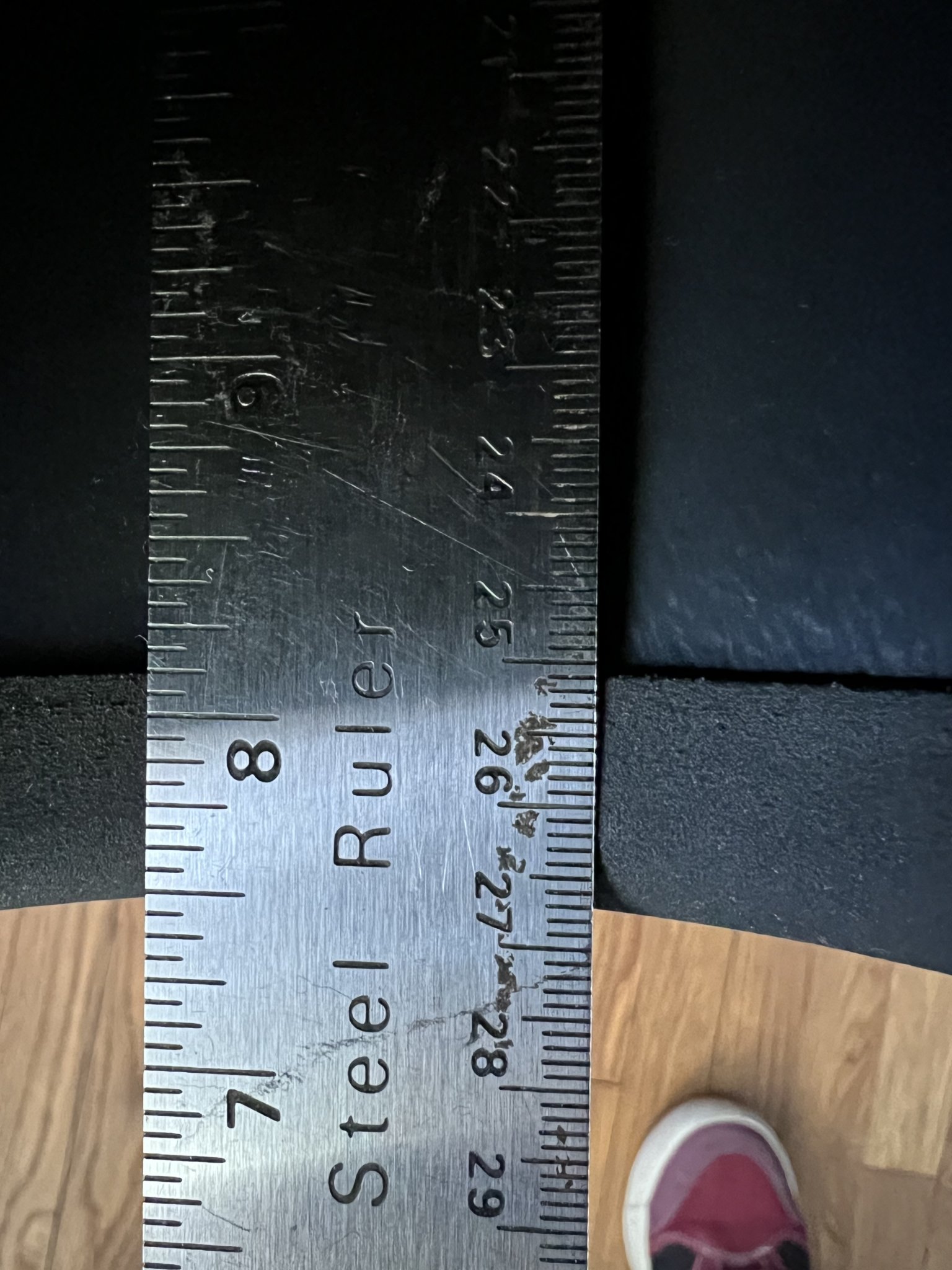

Had time to quickly take a measurement with a bore gauge while I waited for
my daughter to get ready for school.
I get about 104.5 mm internal diameter. Measured both ports in both speakers consistently.
There is a lip at the beginning if the port due to a smaller baffle hole.
The baffle hole bore measured just under 99 mm.
See pics.
P.S. I’m wondering if the internal volume of 100 liters is the volume left after loses from bracing and speaker basket etc….starting volume being 140 liters. Can’t remember if I came across that information somewhere.

Forgot to measure length of ports.
With ruler stuck inside port. Felt for ruler flush with internal end of port tube and took pic.
Looks like about 25 cm if port tube. Another ~18mm of baffle thickness material.
Assuming a thicker front baffle (I think that info is in one of manuals) with a counter sunk hole to mount port tube.
