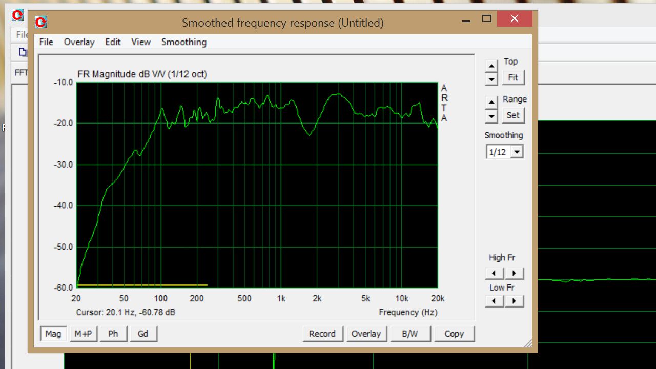

I did some in-room measurements recently while trying to figure out the problem, that showed a mysterious notch in the SPL at about 1.5kHz. Now you mention it, a HF driver wired backwards could well explain that.

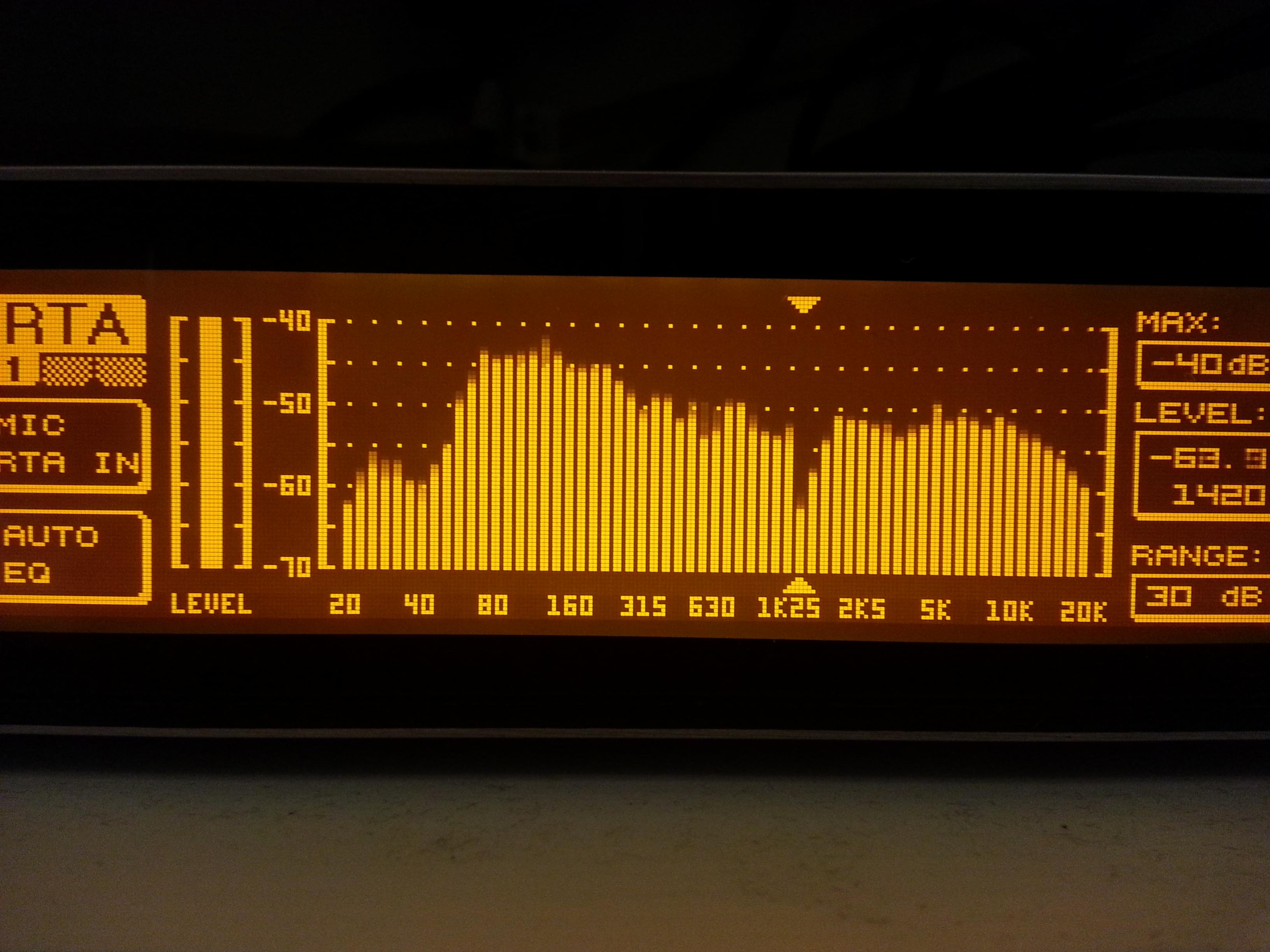

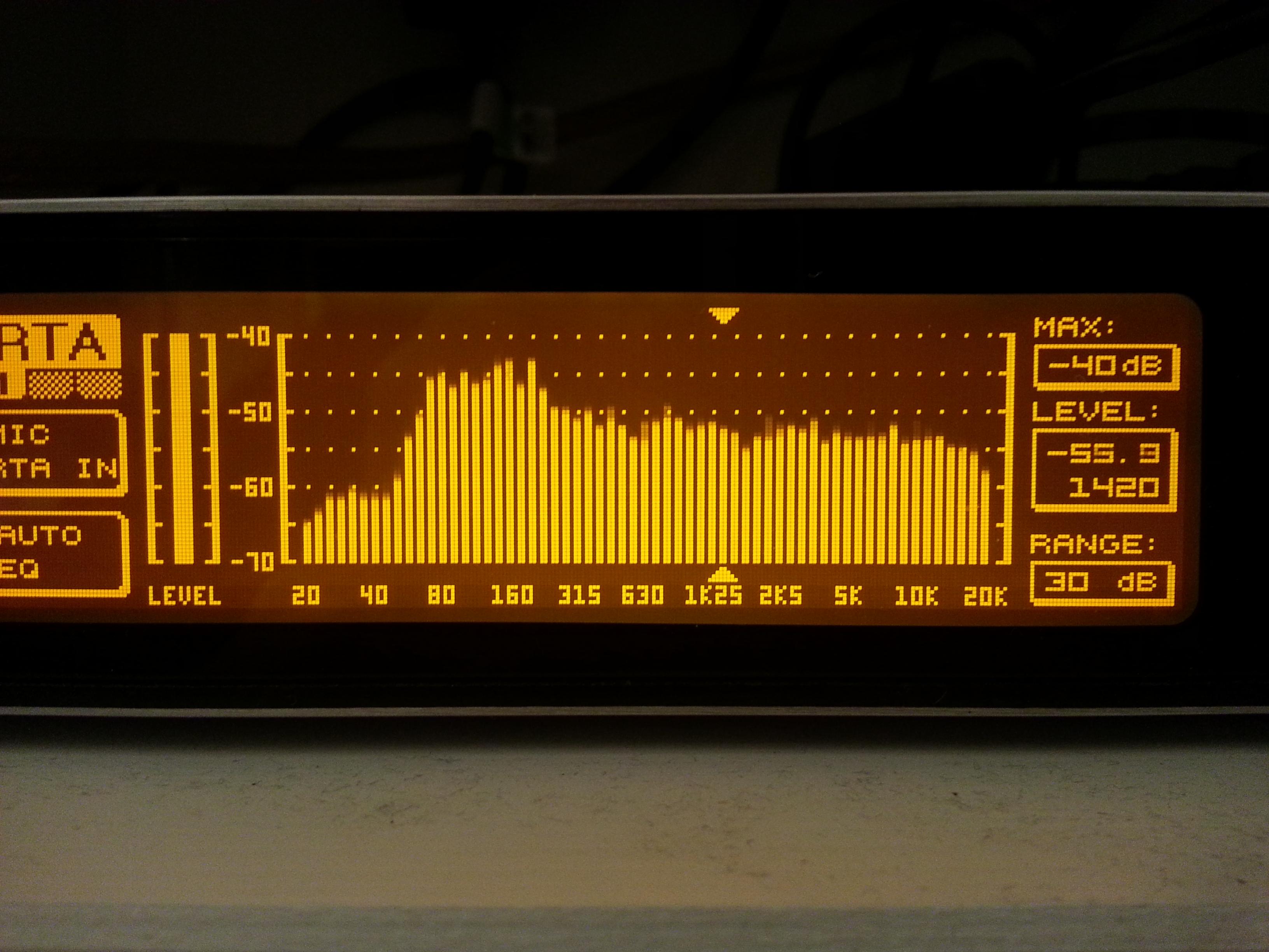

I tried another rough measurement using a mic directly in front of the cone, hooked up to the RTA on my Behringer DEQ. I saw an obvious notch at 1500Hz. According to the manual, the crossover frequency is 1800Hz.
I reversed the wires to the tweeter and repeated the measurement. The notch disappeared and on listening to music, the midrange output seemed a lot better.
Could Tannoy really have wired up the tweeter backwards? 🙁 The spade terminals are different sizes and can't be mixed up. But a deep notch at the crossover frequency is exactly what you would expect from a well designed crossover that happened to have one of the drivers hooked up backwards.
It is possible that they messed something up, but I would be cautious about coming to any conclusions with the microphone placed close to the driver. In this case, for proper driver and xover summation, you really need to have the mic at a distance of roughly twice the diameter of the cone of the mid/bass.
I wouldn't normally stick a mic so close, but the Tannoy is a coaxial design with the tweeter firing through the middle of the woofer pole piece, and is supposed to be time aligned, so I figured the phase should be the same everywhere.
Besides, I previously saw the same notch in an in-room measurement from 12ft away.

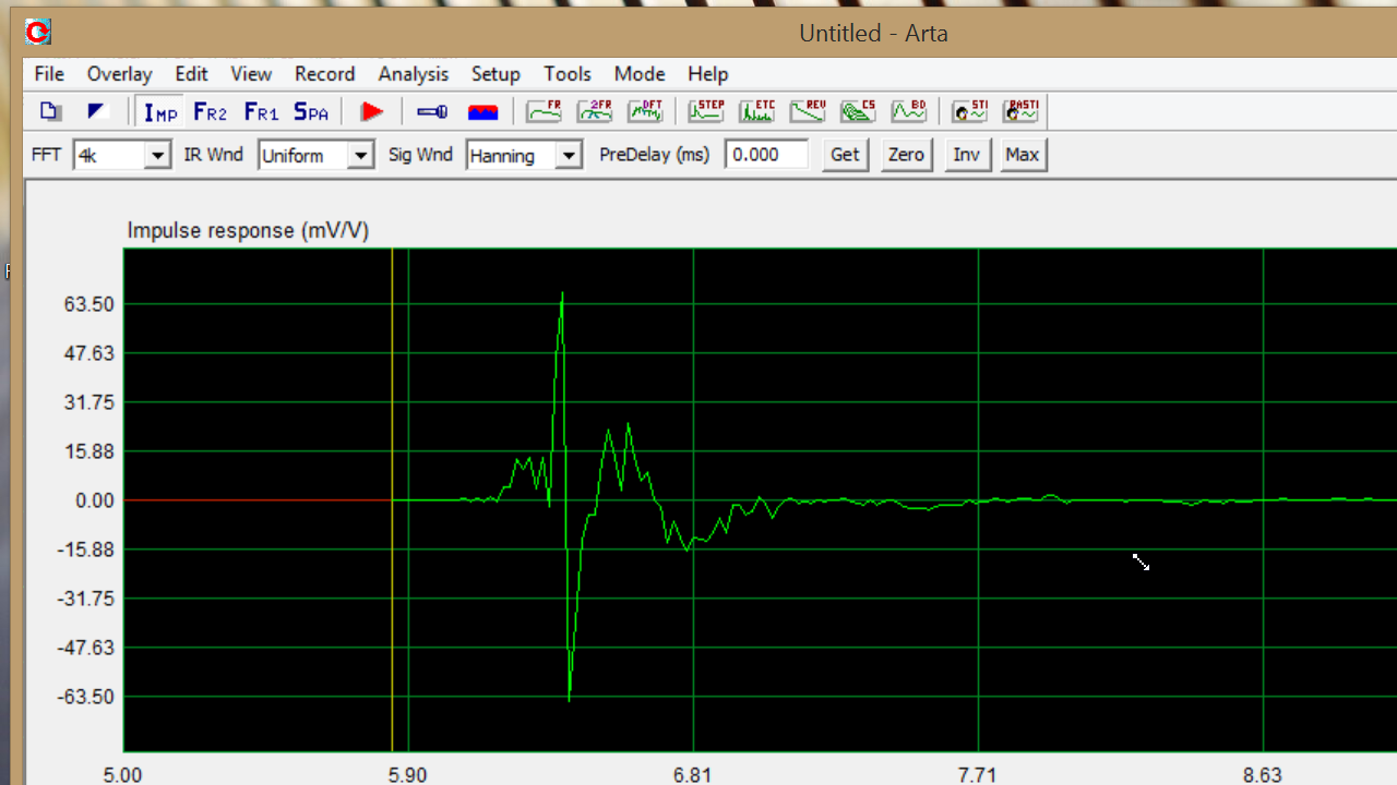

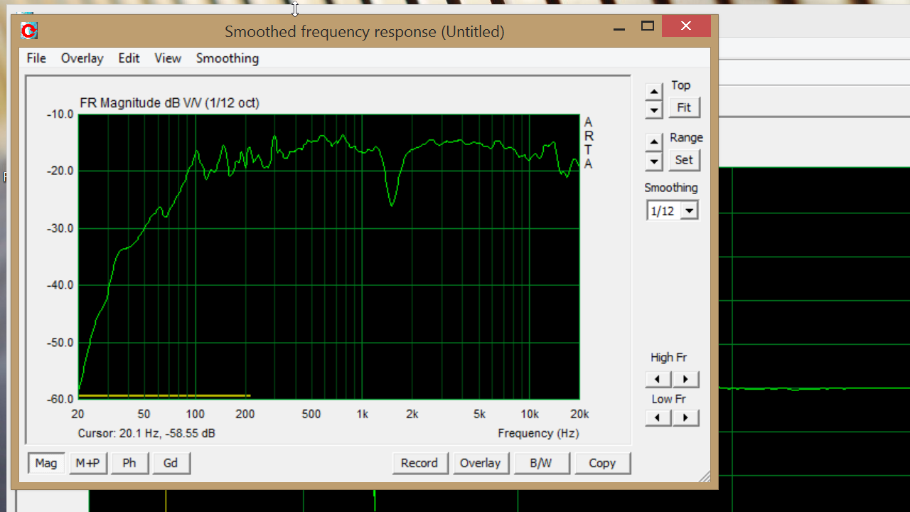

I tried this experiment again according to the suggestions I got above. This time I supported the speaker in midair close to the centre of the room, placed the mic 50cm away on axis, and did some impulse response measurements with ARTA. I haven't done this before, so I hope I set up the gating correctly.
The impulse response with the tweeter in the factory config.
The dual gated frequency response calculated from it. The notch at 1500Hz is clearly visible.

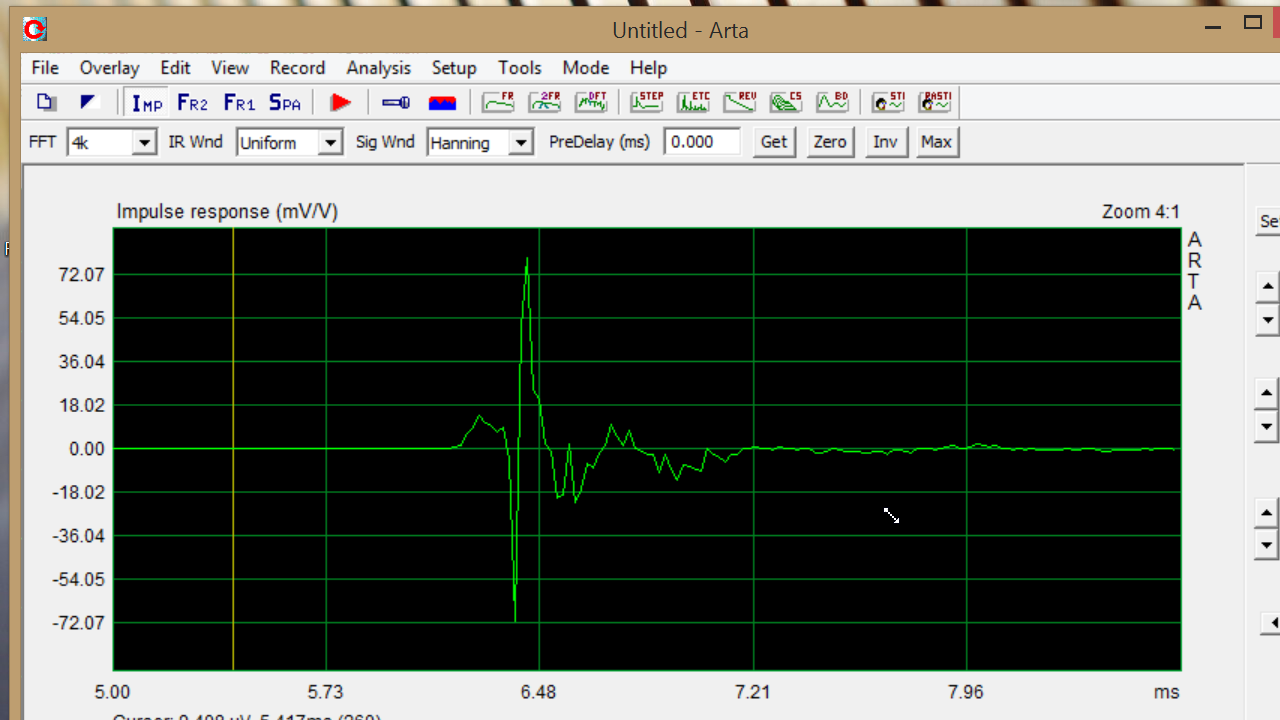

The impulse response with the tweeter reversed. Doesn't really look any better... 😕
According to the frequency response measurement, the dip hasn't gone, it just moved a bit higher in frequency and got broader and shallower.

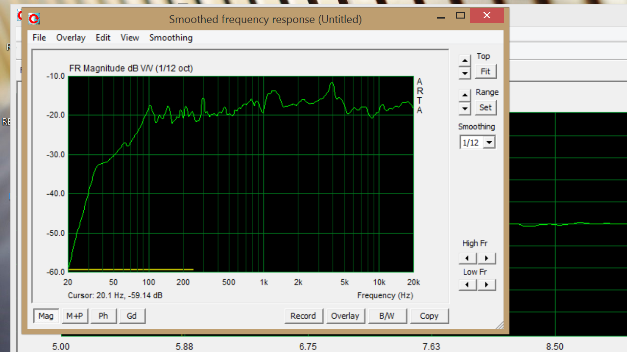

As a sanity check I substituted the Tannoy speaker for a known good Dynaudio BM5.
The calculated frequency response of the BM5. No sign of the dip.

Clearly the design could do with a crossover redesign as something funky is going on there that shouldn't be. I mean this could be related to the unique dual concentric tweeter, but without making individual measurements of the drivers, with the crossovers removed, you won't know.
Interpreting the impulse responses - the first one appears to have the woofers impulse arriving first with the driver connected with positive polarity. Then comes in the tweeters response, indicated by the very quick and sharp impulse. It is connected with reversed polarity as is indicated by the negative going initial peak. After the tweeters response is over you then see the slow negative portion of the woofers longer decay coming in.
In the second impulse response you're basically seeing the same, except that the tweeters peak/dip is now reversed.
Which one is right depends entirely on what order of crossover is used. A second order network has the tweeter connected with a nominally reversed polarity, but because of the phase shift present throughout the crossover region, the drivers sum properly in phase.
There is nothing abnormal looking about either impulse response and it's what you'd actually expect given that the tweeter itself is situated somewhat behind the acoustic centre of the woofer, at the end of its wave guide.
It is possible that the crossover could contain some non polar electrolytics that have degraded over a time and are now out of spec. This could easily result in abnormal behaviour. Tannoy's own measurements for the 800 in the instruction manual show no dips anywhere.

Yup right now I am suspecting some sort of crossover SNAFU at the factory. The frequency response graph in the manual shows a ~2dB dip at the frequency where I have the 12dB dip. They probably used a lot of smoothing, but the dip I see covers a whole 1/3 octave, so I don't see how they could have hidden it.
