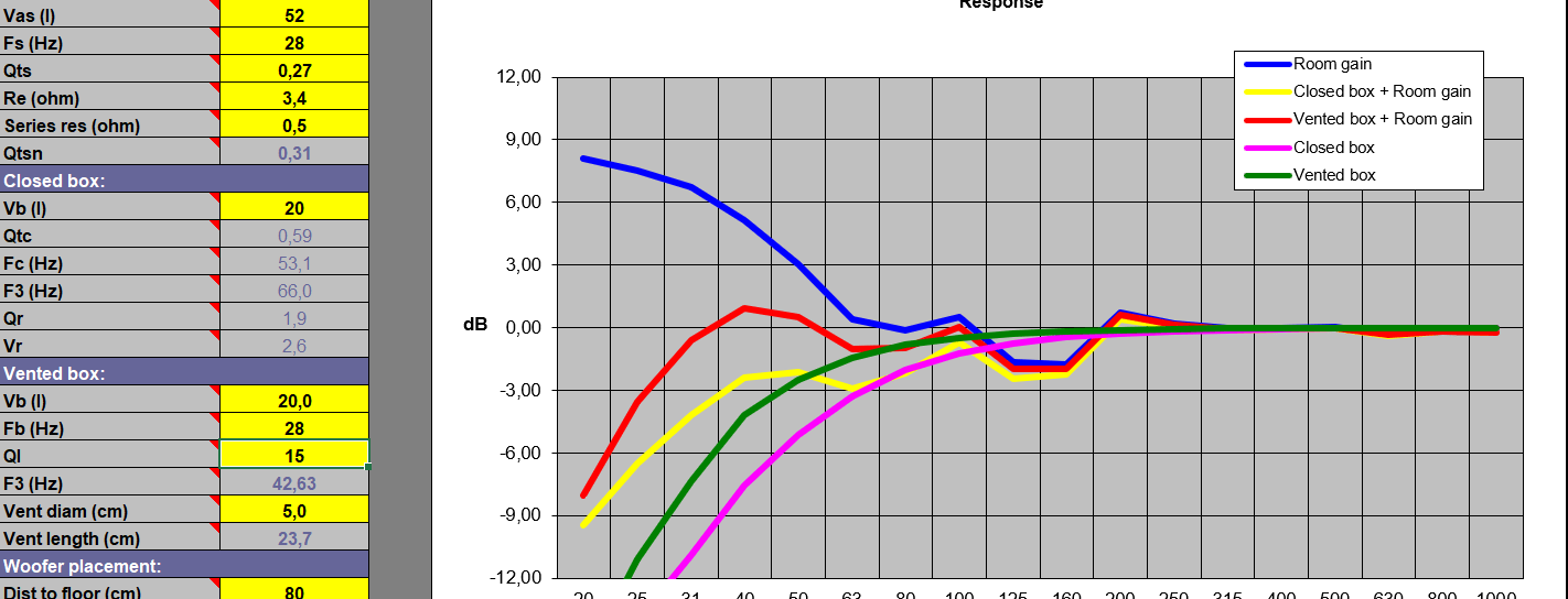

Paul thanks for sharing experience with TL and congratulation on project with Dayton drivers. I have plan to use first electrical order crossover on Satori woofer so Qts will be around 0.31. Regarding ML TL you think it is better to put Satori with low Qts. Something like Tabaq design or accidental MLTL box.

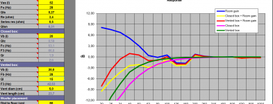

You attached calculation and SPL graph is with out room gain. Maybe 2m (it is 2.77m when put tapered ratio 5:1) physical's length is way to go with net volume around 20 liter. See attached file with room gain, fb=28
What does the XO have to do with the Q?
A Q of 0.31 (for a driver in a box) is very low, and the term only applies to a sealed box.

When you put coil on woofer (low pass) it will increase Qts, coil have cca 0,3 ohmWhat does the XO have to do with the Q?

Yes, room gain is not accounted for, but may not amount to much, but baffle step losses aren't accounted for either which will offset room gain most likely. Keep in mind that most, if not all, modeling software for however the box may be configured, is "ideal".Paul thanks for sharing experience with TL and congratulation on project with Dayton drivers. I have plan to use first electrical order crossover on Satori woofer so Qts will be around 0.31. Regarding ML TL you think it is better to put Satori with low Qts. Something like Tabaq design or accidental MLTL box.
TLs, bass reflex and ported boxes all are inherently 4th-order designs, although their roll-offs below the knee in the bass response curves don't necessarily have to be 4th-order, and can be made to have a 3rd-order or a bit less depending on the design. Whatever the box design is, you have to pay attention to both driver excursion and port or terminus air flow velocity and make the necessary changes and compromises to achieve your desired goals if possible. I always determine how much input power is required to cause the driver excursion to reach Xmax+15%, then note what the peak air velocity is. If that velocity is not more than 17 m/s and the driver is generating adequate SPL, then the design is good to go. If not, I'll make changes to the design. I've never had any of my personal tapered or mass-loaded TLs exhibit huffing and puffing.Pkitt assisted me in designing a 12:1 TL for a seas W22EX. Unfortunately a wrong cut with my router damped my enthusiasm for the project, but before ruining one of my boxes the listening test seemed to verify the calculations with a high quality "deep, dry quality" bass.
