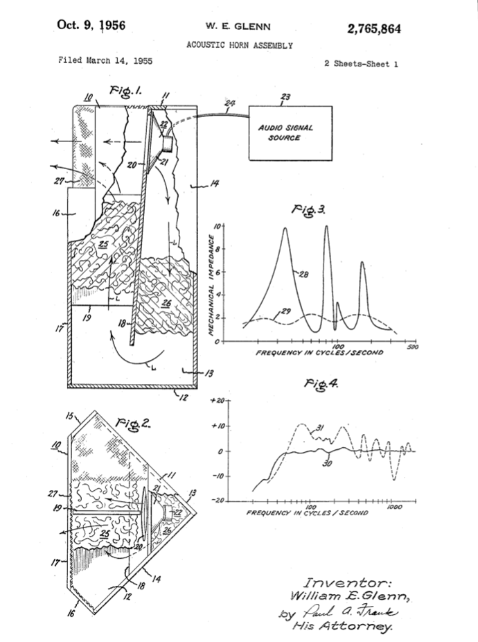

I don't see it as infringing on anything anyway. The layout of the tapped horn has been used since at least the 1950s. Danley's contribution was to figure out how to predict the frequency response (which could have been done anytime in the last 20 years by someone with Akabak) and actually use the concept in a modern design.

Danley's addition was the non parallel walls, IE horn.
There's prior-art of that as well. It's been posted a few times here. I think JAG is correct in his analysis of what TD did. I'd go even further and say that that TD found a way to significantly extend the passband of a 1/4 wave resonator by judicial position of the driver in the path to basically "fill the gaps". It's not uncommon to see TD's THs quoted with a response that extends from below 35 Hz to above 200 Hz. Compare that to the Anarchy's FR. I refer to designs like the latter as "compromised THs", as there's no similar focus on extending bandwidth, likely to keep box size down.

William Glen had already done that in 1956, his "Acoustic Horn Assembly is what DSL later called a "Tapped Horn". Glen's horn used stuffing in the horn path as an acoustic low pass so the driver could be used "full range" without the usual TH peaks and dips in the upper octaves.
Art
