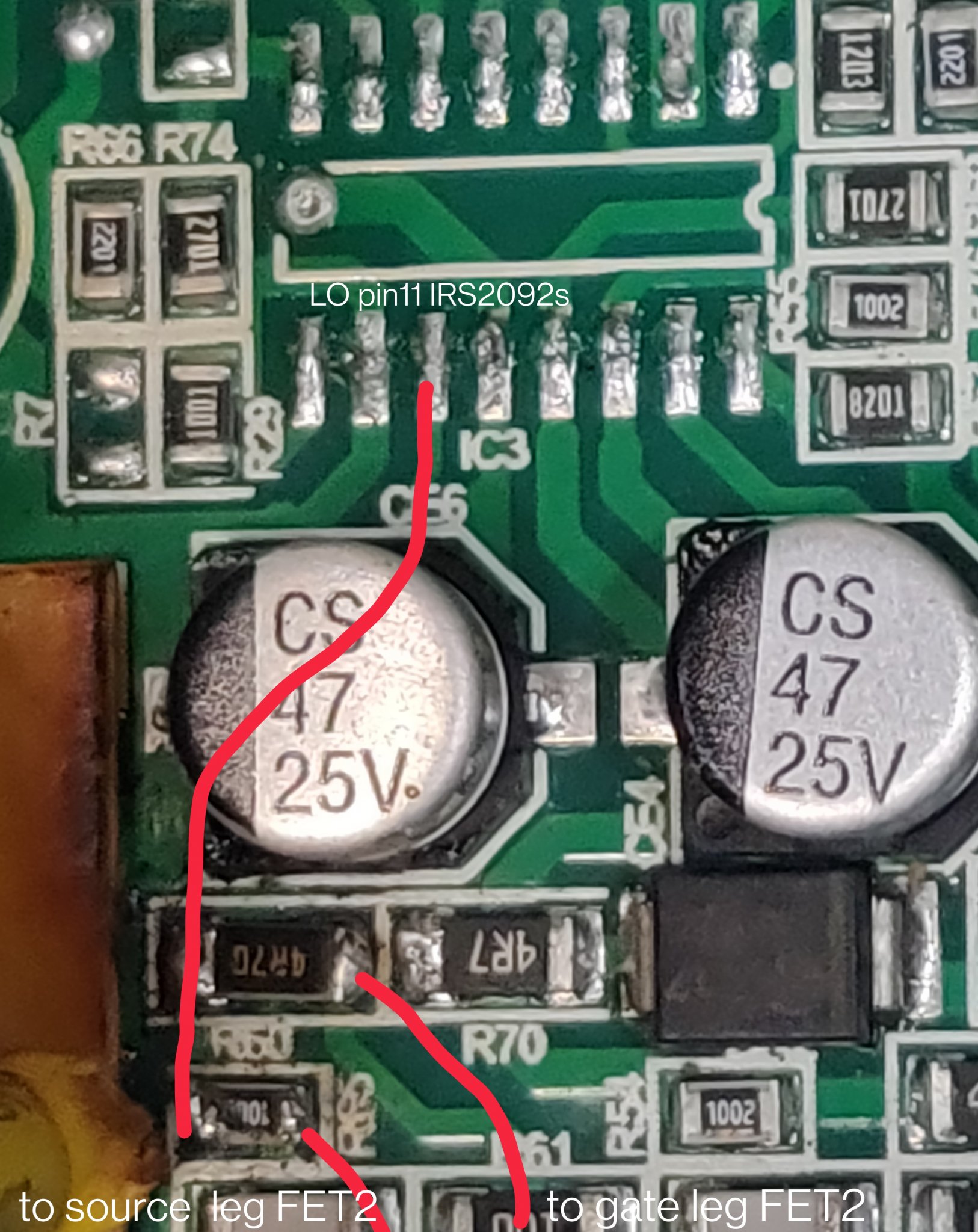

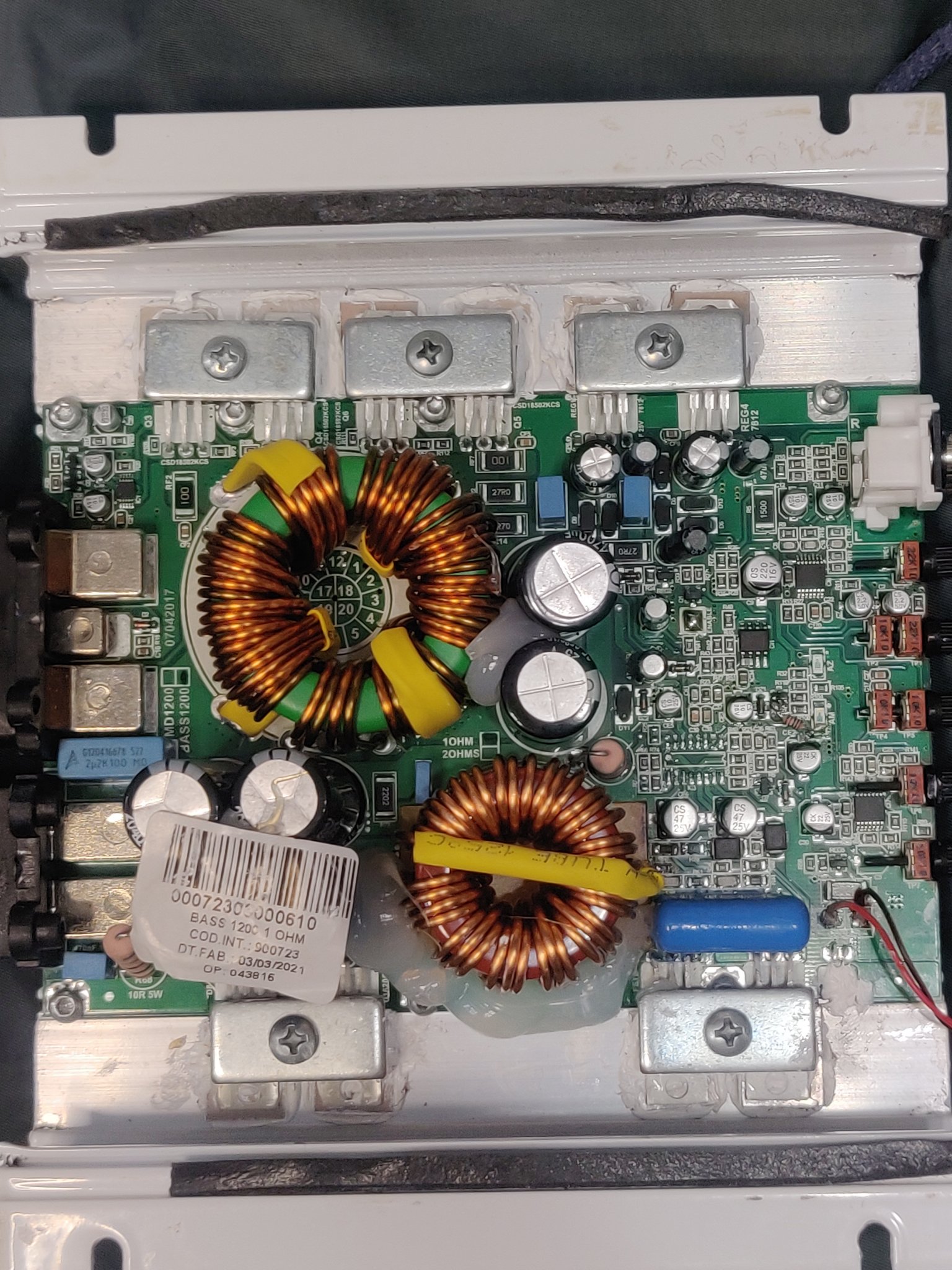

Good Day. I am currently repairing a Taramps Bass1200 that came in powering up but with no audio. It was not in protect mode but there was 4.3v across the speaker terminals.
When checked, both outputs (IRFB4115) were testing as good but the 4R7 resistor at R60 was burnt open. I replaced that and then the amplifier would start and shut down repeatedly. The IRS2092S is likely damaged as it reads 192ohms between COM and LO out of the board. I have a brand new replacement but I want to make sure there isn't an errant voltage present that will damage it as soon as I put it in as these are hard to find. Below are the voltages on the pads for the IRS2092:

One side of R60 is directly connected to the gate leg (leg1) of output FET2 (IRFB4115) and the other end of R60 is directly connected to pin11 (LO) of IRS2092s. The end connected to pin11 is connected to R65 (10k resistor) and then output FET2 (IRFB4115) source leg (leg3).

Resistance across the high side output is 6.8k and across the low side output, 10k. I removed the outputs and checked them and they checked good in comparison to a known good output I had. The outputs were not damaged in this amp, just R60 was open and there was no output, and likely a damaged IRS2092s.
The resistors don't generally burn for no reason.
As far as I know, the only things that could cause the resistor to open is a defective G-S Zener or a defective output transistor... and, maybe as a long-shot, a stray strand of wire that got into the amp.
There were wire strands inside the amp. I suspect that was the cause of the damage as I experienced similar failures with Timpano and Stetsom amplifiers.

Installed the new IC and the amplifier has clean output when tested on the bench. Will test it in a vehicle tomorrow but it appears to be repaired. I am more confident that the supplier's ICs are good so I may buy a few depending on his stock. Thanks for the assist.
