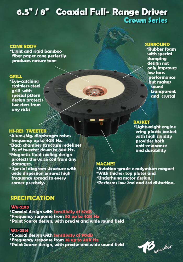

Tang Band has a new line of coax drivers for point source. From 3" to 8" drivers.
The 6.5 and 8" driver sport a funky surround... and even have a designer grill over the tweeter.

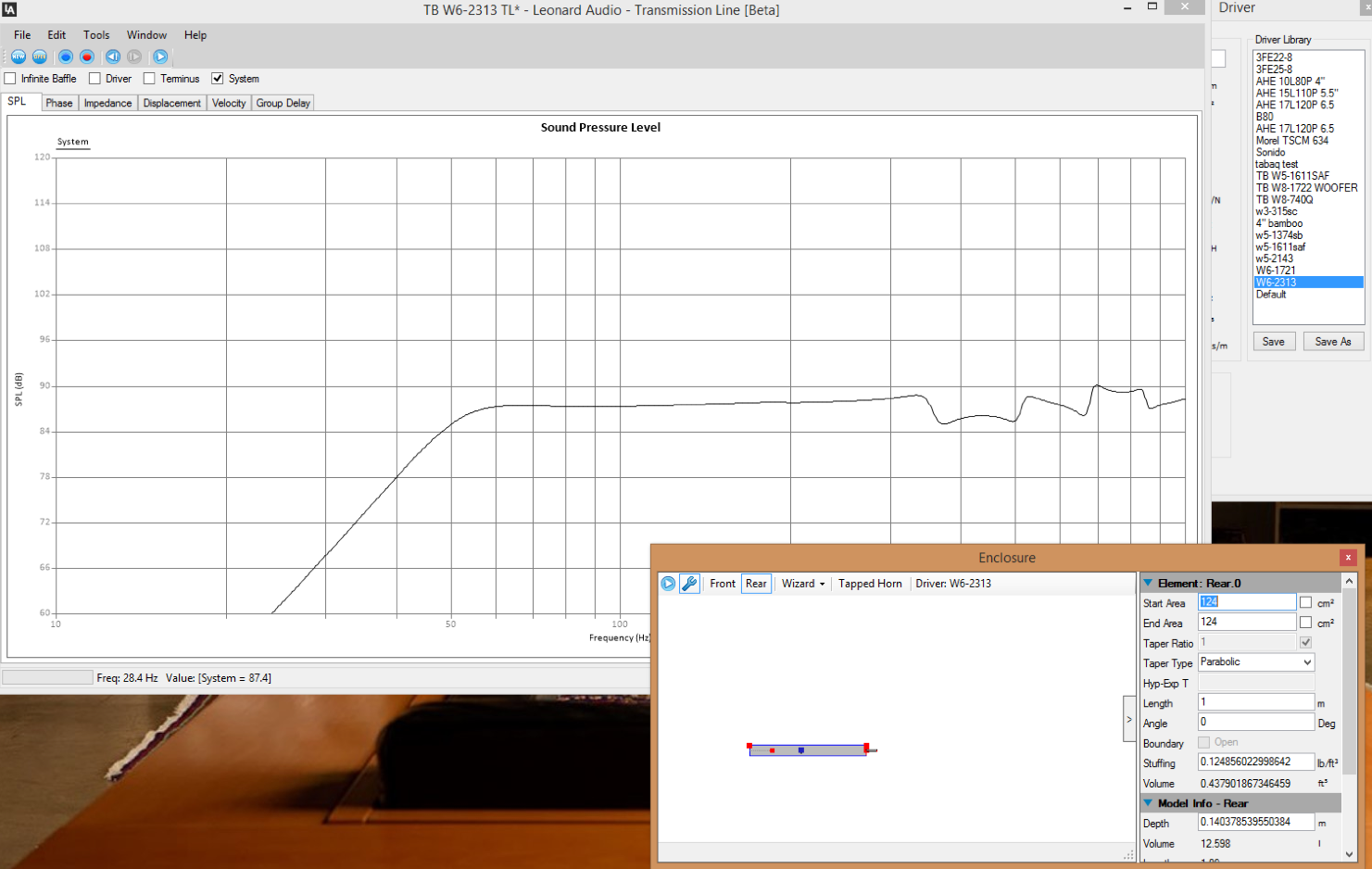

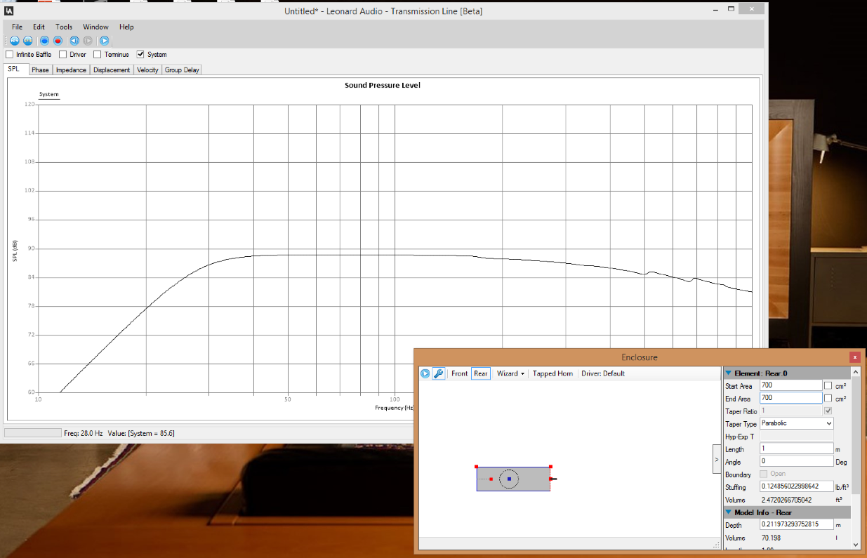

For fun, I plugged the 6.5" into TL sim, and it came up with great possibilities!
A narrower and longer version works well, but even something a little "stubby" looks great. Only 1m tall, 700cm2, and a small vent.
F3 at about 28Hz!
If the tweeter sounds good, this could be a killer mini tower!

Really interesting, and reasonably priced (186 € at bpa)! The cone breakup of the woofer looks really controlled as well. Can't really play above 100 dB, but that's alright for most people.
Just putting the W6 in a 20 l vented box tuned to 45 Hz gives a F3 of about 40 Hz.

Interesting indeed - any ballpark on distribution dates / pricing? As the info linked above may be very preliminary, I note that while the photos clearly show XO components on the smaller two, the absence of mention of specific recommended crossover frequency on the 6.5 or 8" - other than the "to perform from 800 up to 40KHz - leave those two open to huge amount of experimentation.
I'm thinking these will be either a raging success, or memorably underwhelming ?

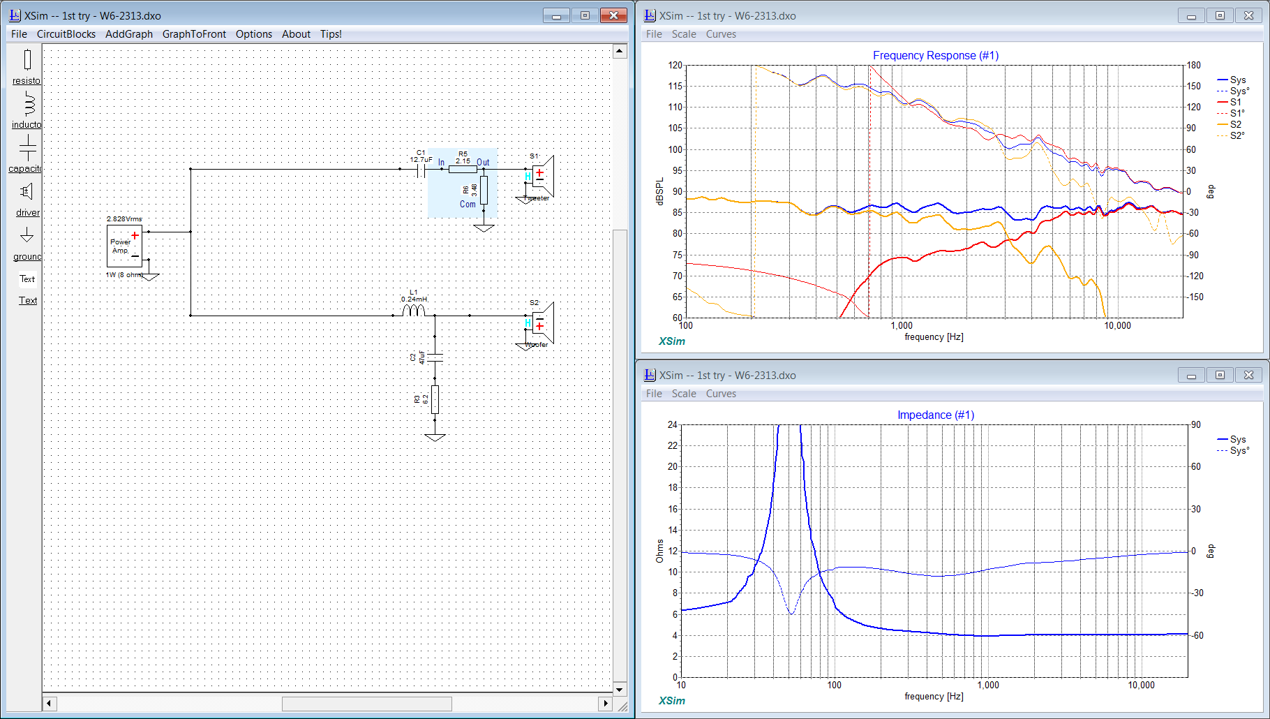

What the hell, I ordered the W6.
I traced the curves and extrapolated to 20 Hz (for tweeter), anyone feel like giving the XO a shot? I'm new to passive XO:s, what XO-point should I aim for? 2 kHz? I'm guessing that the coaxial part enables a higher XO than for a usual 2-way, but the polars should decide I suppose.

There's a suggested enclosure and crossover posted on the Tang Band website for the W6:
SUG2-25 - 6.5" 2 Way Coaxial Bookshelf Enclosure Suggestion - TB SPEAKER CO., LTD.
Looks like a Kef LS50. Interesting curved port tube....
Hmmm, I'm not typically a fan of coaxial drivers but I have to admit the 8" version looks to have a lot of potential. The coax has to be crossed over at about 2kHz because the pattern from the 8" cone will start to narrow there. Would need to see the HD/IMD profile of the tweeter to know for sure. To that I would add a woofer to create a 3-way system, crossing maybe around 350Hz to a sealed 10" in a tall cabinet as narrow as possible, with the coax as high as possible in the baffle and the woofer just below that. The reasoning for adding the woofer is that you do not want the cone of the coax to move because it is the waveguide for the tweeter, so it should not be operated to low frequencies. A 10" woofer can deliver relatively good bass in a large floorstander without having to resort to a "subwoofer" driver and will keep the baffle narrow, which helps with imaging.
