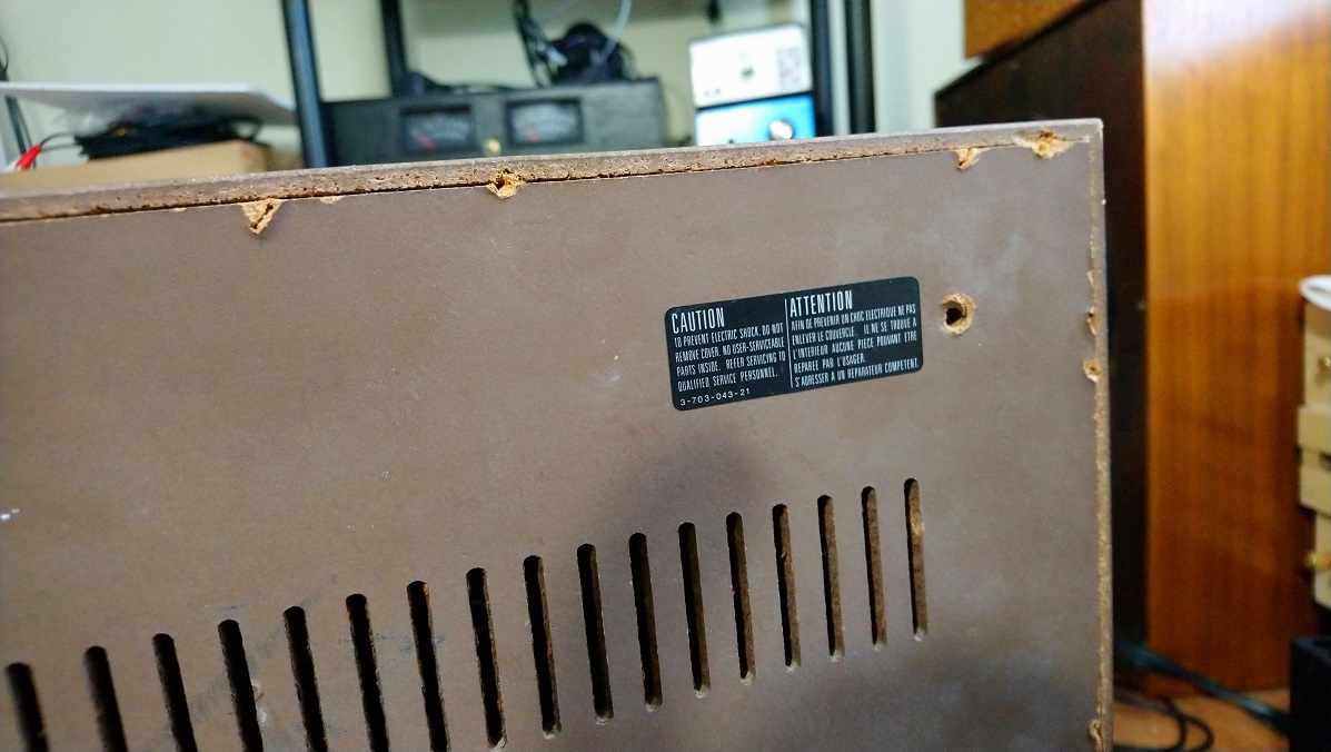

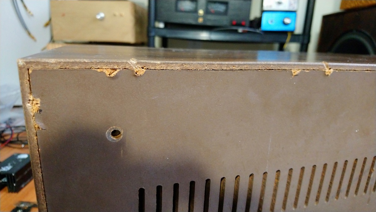

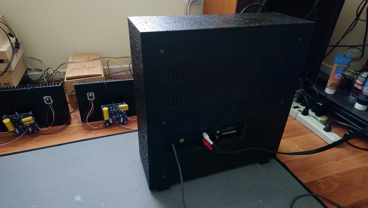

I have weird problem. I am restoring an old sony reel to reel. I can remove the front, and work on belts and mechanical stuff, but i need to open the back and work on electronics too.

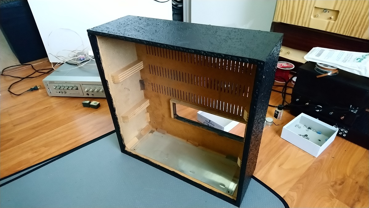

Problem is, i can't get the back cover off. This is embarrasing, but it seems like noone has ever removed the cover. I took the screws of, but there seems to be cover nailed to the wooden frame together. It looks like u shaped nails. Does not seem like easy way in.
Anybody has any experience with this? I thought removing back cover would be normal part of service.

I have experience with TC-377 and TC-645, but neither of them had the back cover stapled to the wooden frame. The cover is usually fixed by the screws that hold the rubber feet. I think someone has serviced it and believed that would be the last service ever.I have weird problem. I am restoring an old sony reel to reel. I can remove the front, and work on belts and mechanical stuff, but i need to open the back and work on electronics too.

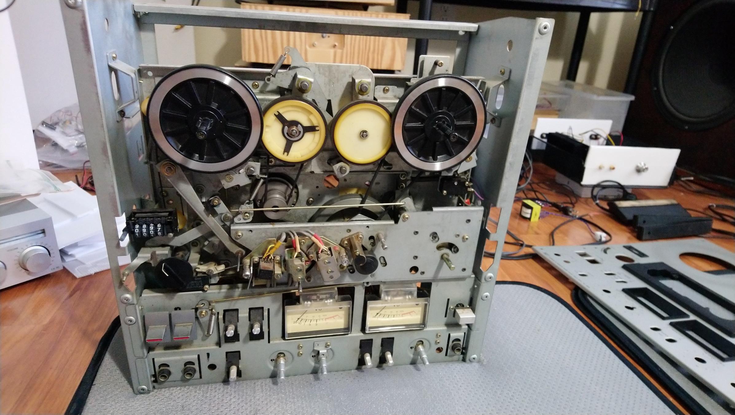

Here is a copy of the disassembly instructions. Hope it helps.
Thanks, that definitely helps.
In the mean time i downloaded full service manual.
It looks from the picture, if i understand correctly, one needs to remove the front cover completely, the back screws, leg screws, bunch of other screws on inside sides, and remove all the guts out. That seems only way to aproach boards with electronic.
Oh well, i gotta do it. I need to replace all signal caps and deoxit bunch of contacts.
I ordered complete belts kit too...
Wish me luck. Definitely not the frendliest beast to work on. Especialy some belts to be replaced...one need to take whole heads assembly out. I have seen videos for 377, look similar in construction.

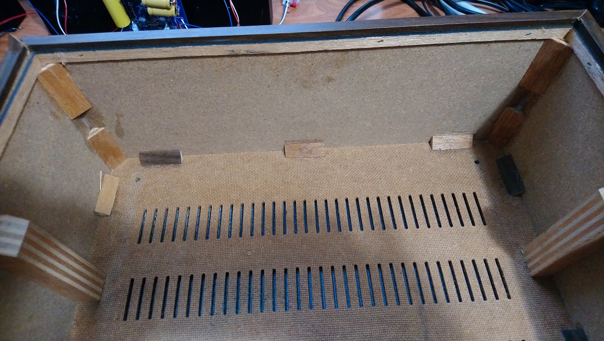

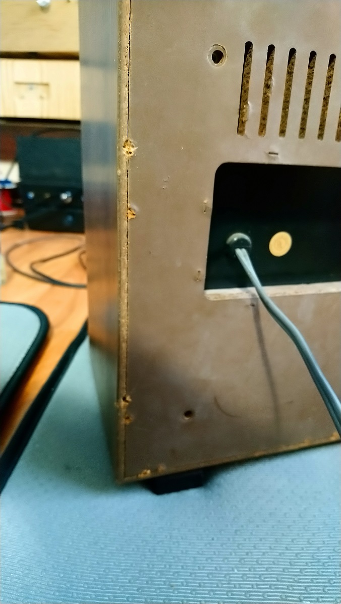

Ok, I am in!

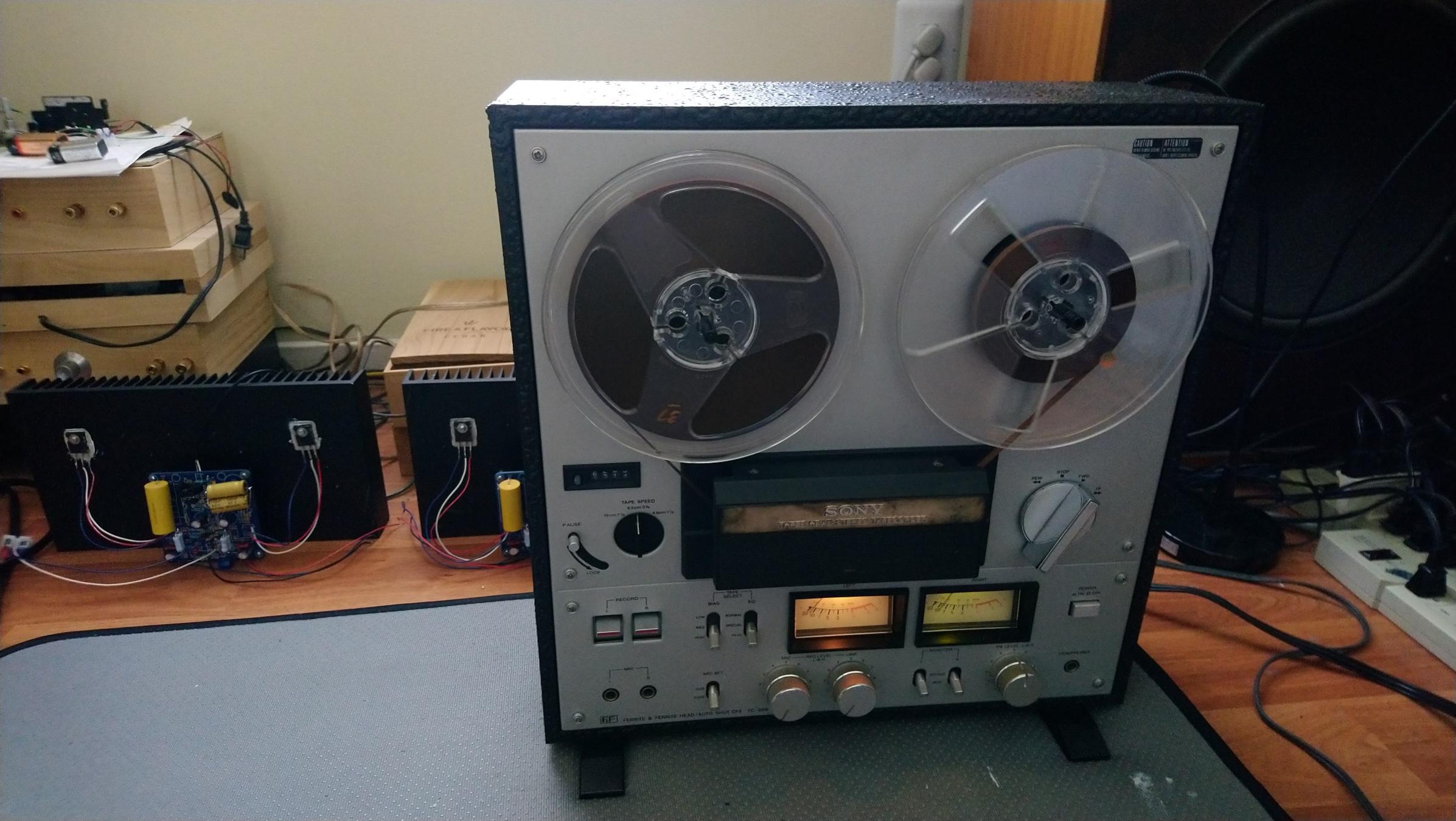

Well, as expected, I was right, the back cover is not removable, those nails were original by sony (which i painstakingly removed in hope to get back cover off). Anyway, here are some progress pictures. Just for laughs.

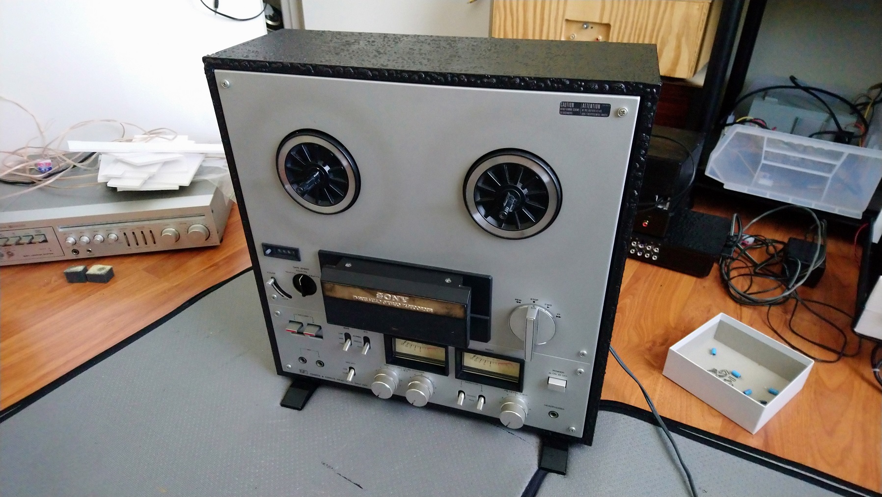

I installed temporary belts and it is playing, sounds cleaner then before recaping. There is slight channel disbalance, not big.

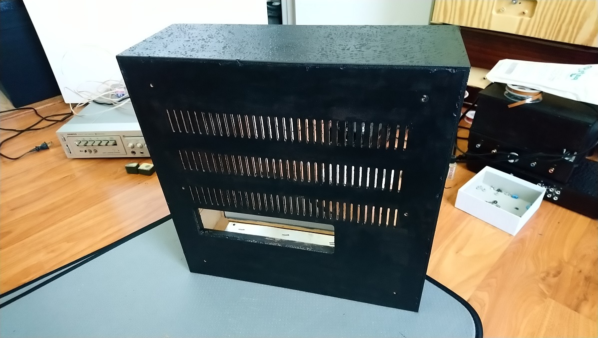

Painting the wooden frame now. I do not like the look of fake wood, it will be my signature bubly black.
Still long way to go, but slowly getting there.
some more progress...
one VU meter light, right, was not working, light bulb gone, so I put two yellow leds in series with normal diode, since it powered by 6 volts ac. Well, they do not look exactly alike, but I will eventually do the same thing to the left channel. Once I receive the belts.
Channel imbalance is improving, I guess it just needs to be played.
