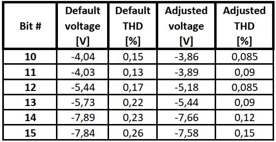

We are interested in the bit transitions of the upper 7 or 6 bits (more on it later), that is:
0111 1111 1111 1111 -> 1000 0000 0000 0000 (MSB, bit #15)
0011 1111 1111 1111 -> 0100 0000 0000 0000 (bit #14)
0001 1111 1111 1111 -> 0010 0000 0000 0000 (bit #13)
0000 1111 1111 1111 -> 0001 0000 0000 0000 (bit #12)
0000 0111 1111 1111 -> 0000 1000 0000 0000 (bit #11)
0000 0011 1111 1111 -> 0000 0100 0000 0000 (bit #10)
0000 0001 1111 1111 -> 0000 0010 0000 0000 (bit #9) - we will not use any correction here
Now we just need to measure the THD around each bit transition, and inject a correction current in the DEM pins for reducing the THD.

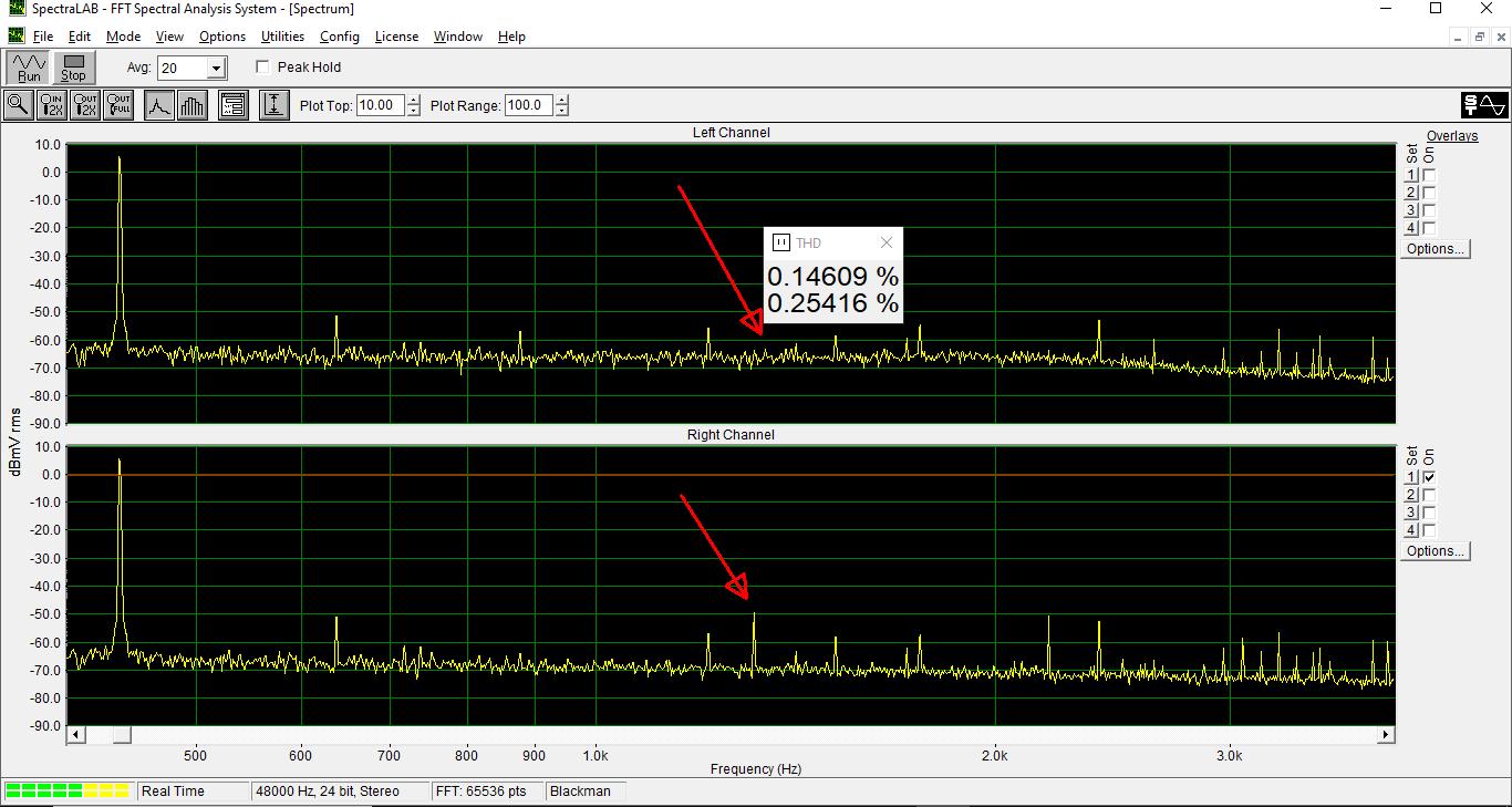

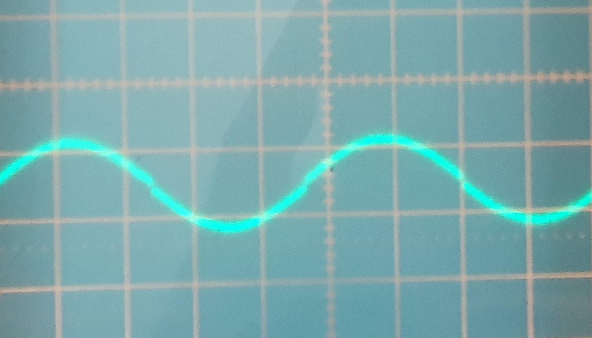

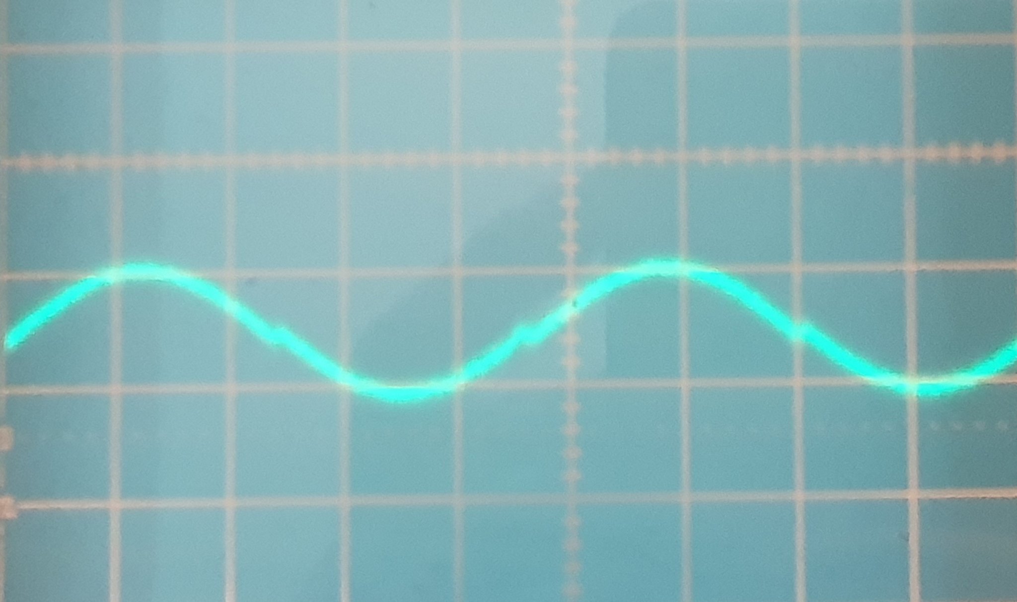

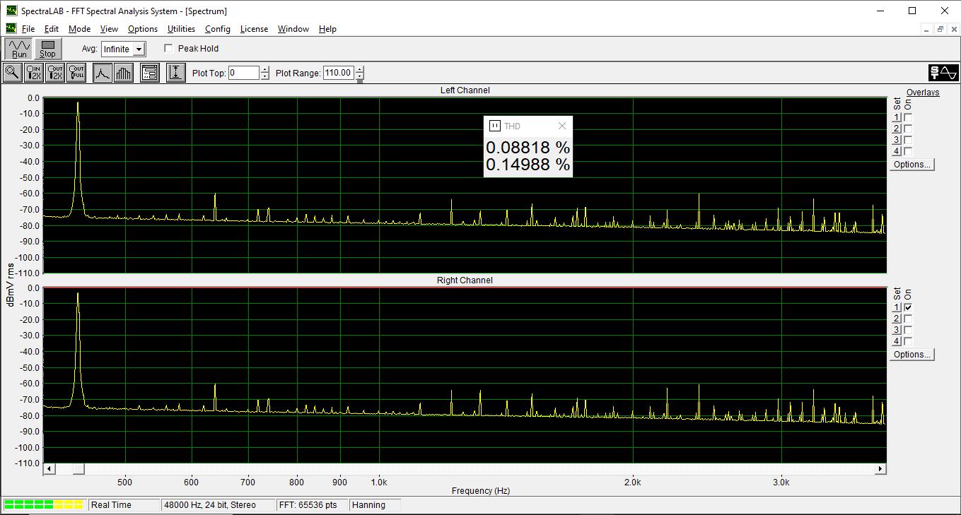

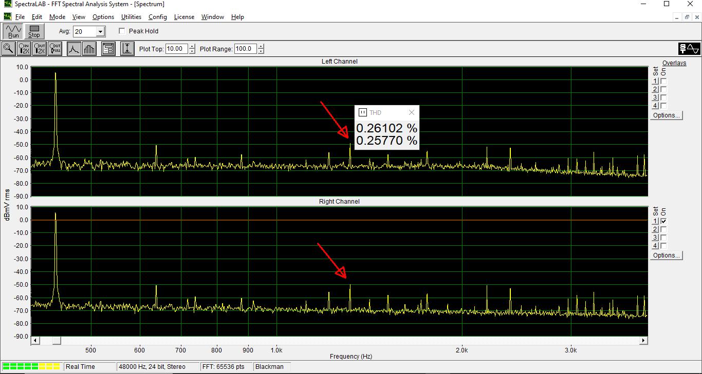

Left channel (top) adjusted for minimum THD, compared to unadjusted. Right channel (bottom) unadjusted in both graphs. Input signal: 400 Hz 6 bits, that is -60 dB sine, referred to peak 16 bits. Analog output is 3 mV peak. Scale is uncalibrated. H3 marked with arrow.
can you hear the difference when playing a material you know very well ? Wonder if I could hear it as I am post and half 50 y.o. -50 dB for H3 seems low enough if I am not wrong ? It affects bits precision, rigth ?
You also use ad828 as I/V which has very low noise till 2k Hz IIRC. But not so fast (slew rate and sttling time).
What I wonder is that peak we see around 630 hz, what is it ? H2 at 800 hz is flat too ! Is the peak just before H3 the next harmonic of that 630 hz peak ?
Look forward to read more about your tests. Thanks for that.

Anyway. Where do you probe, please ? At AGND or DGND pin (same result ?) and on the DEMS decoupling pins ? That's cool, I'd like to have a spectrum analyser... too much expensive for my pocket, although I saw some handled casing ones at 150 euros but the bandwidth and bits resolution is too much low for that !

Pin 5 & 14 ; according the layout pcb that links both is you have result may differ I imagine if you put the gnd probe on either. But I do not know for real.
Well I could have guessed with a 400 hz fundamental tone, I haven't readed carrefully enough. Then the result given by the operationna amplifier l could influence I surmise as you are in analog domain measurement at outpt. But can we hear it is another story maybe.
