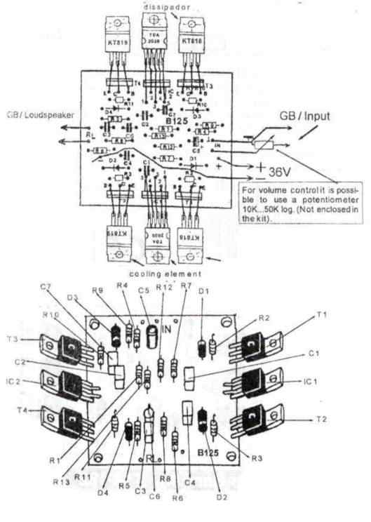

Hello everyone. I want to build an amp to drive a 20" 4ohm 150w max subwoofer in a car. I'm planing to use boostor project to boost supply voltage from 12v to +-22v. I'm looking for an ic amp to deliver 70w-100w from said supply.

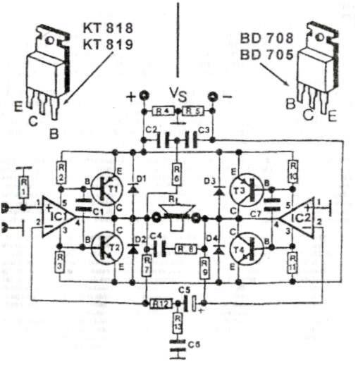

I've found the schematic below using TDA2050's in a bridge configuration claiming to output over 70w which is enough for me but TDA2050 is obsolete and i'm concerned fakes won't be able to handle +-22v supply voltage. Even if its a TDA2040 rebranded as 2050 it should fry according to datasheets.
What experience do you have on fake 2050 chips? Is it worth the shot? I'm open to new ic suggestions. Or maybe should i go with transistor amps? Any idea or recommendation is welcome. Thanks for reading.
That schematic will work into 8 ohms, but a 4 ohm speaker will overload the amplifier chips.

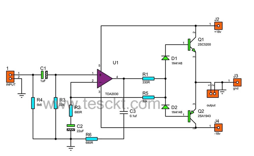

Also what do you think about something like this, do you think it would work?

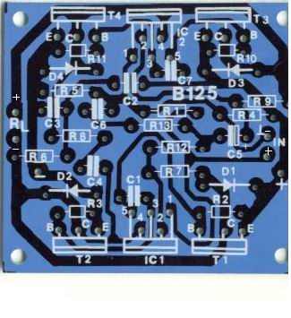

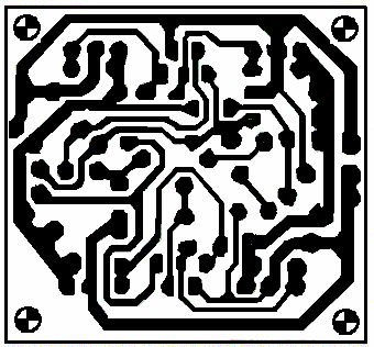

200 Watts Power Amplifier With TDA2030 pinout and connection diagram - Schematic Circuits Elektropage - The Electronic Source

For the schematic you show there seems to be a major flaw at the input of IC2 ("+"-input to ground, "-"-input to positive supply rail).
Actually the thing is full of drafting mistakes. I am pretty sure the booster transistors would need some connection to the load as well.
I can only guess that the schematic may have been redrawn by someone who either didn't have a clue how it was supposed to work or didn't care at all, or even deliberately obfuscated.
That's the kind of quality you get on random free schematic websites.

Yes, sorry about that, i noticed something wrong with that color schematic after posting but forgot to mention. Original circuit is in the other link and seems ok to me afaik, what do you think about that one?
Here it is:
