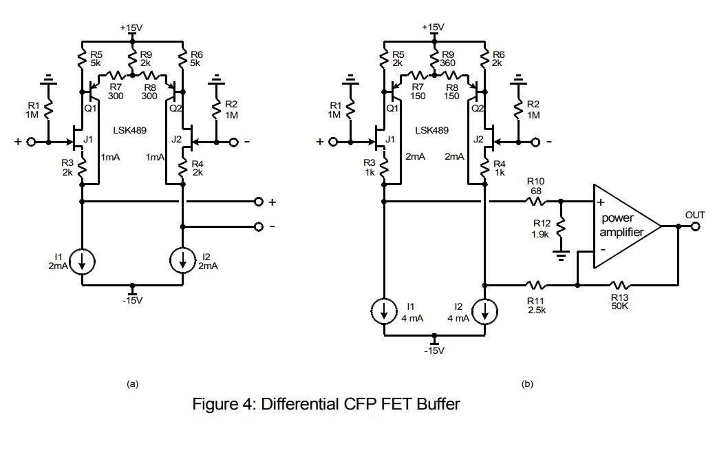

The TDA7293 series are underrated gems in the DIY world. This chipamp, with its modular structure, clip detector, mute-stby functions, low noise and low distortion, produced with DMOS technology, actually has the potential to compete perfectly with National/TI's LM3886. On the other hand, it is common practice to use chipamps with a buffer due to low source impedance demands and relatively high input bias currents. Likewise, with composite feedback applications, both the noise and distortion efficiency of chipamps can increase significantly. In our implementation, two matched N-channel JFETs, together with the PNP transistor, operate as a complementary feedback pair as a high-impedance, high-CMRR differential input buffer for the TDA7293. The JFE2140 / LSK489 dual JFET combination used provides significant improvement in THD and noise compared to the use of the chipamp alone, thanks to its extremely low noise. The composite feedback rate is 26dB (20x). In this way, ~1.25v RMS input signal is sufficient for full power. On the other hand, thanks to the DC servo circuit established with TI's low-noise, low-offset opamp OPA227, the DC offset remains below 1mv.
Our inspiration for our design was Bob Cordell's LSK489 application notes and JFE2145 datasheet.

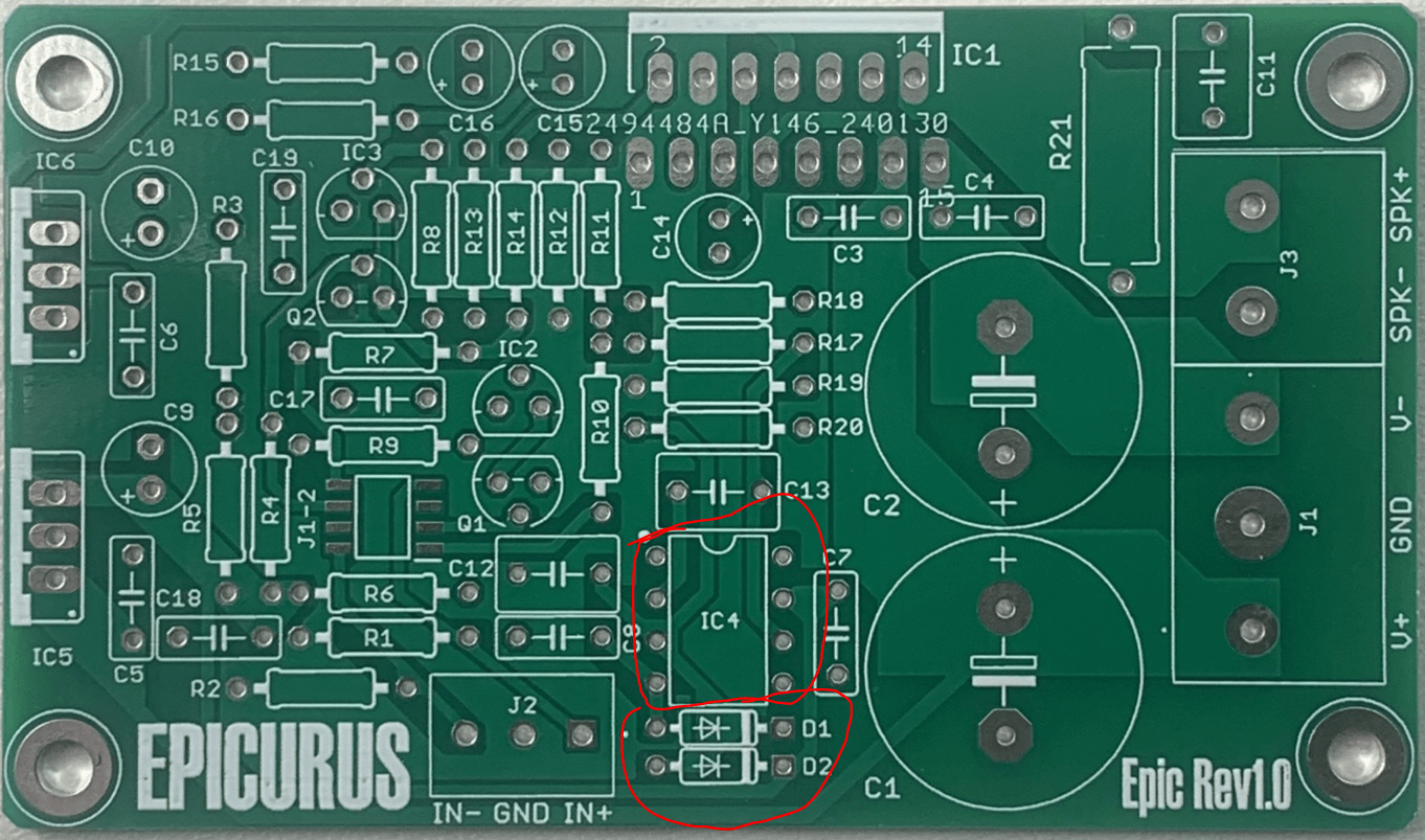

I am pretty sure I know what all components do... except the IC4... and D1, D2..?? Can you give us a hint??
One of the contributing factors to the overall relaxing presentation of your amp is the low-noise voltage regs, which is a great distinguishing factor compared to other IC/chip amps.
