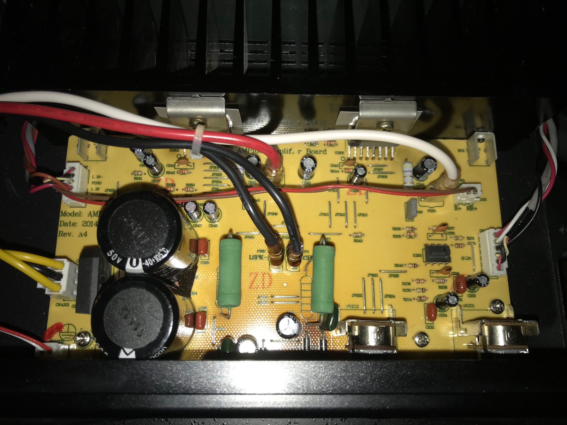

1) There are two large 220r 5W (I think) resistors that get very HOT!!! The +VCC one gets up to 140-dgrees F hot (R201 - left one), where the -VCC one only gets to 120-degrees F (R202-right one). I know these are "burning" off voltage to get down to ~15vDC for the relay, op-amps and led. But it that amount a heat normal? Seems very hot, can't touch them after 1-2 minutes of being on for more than an instant or you will get burned.

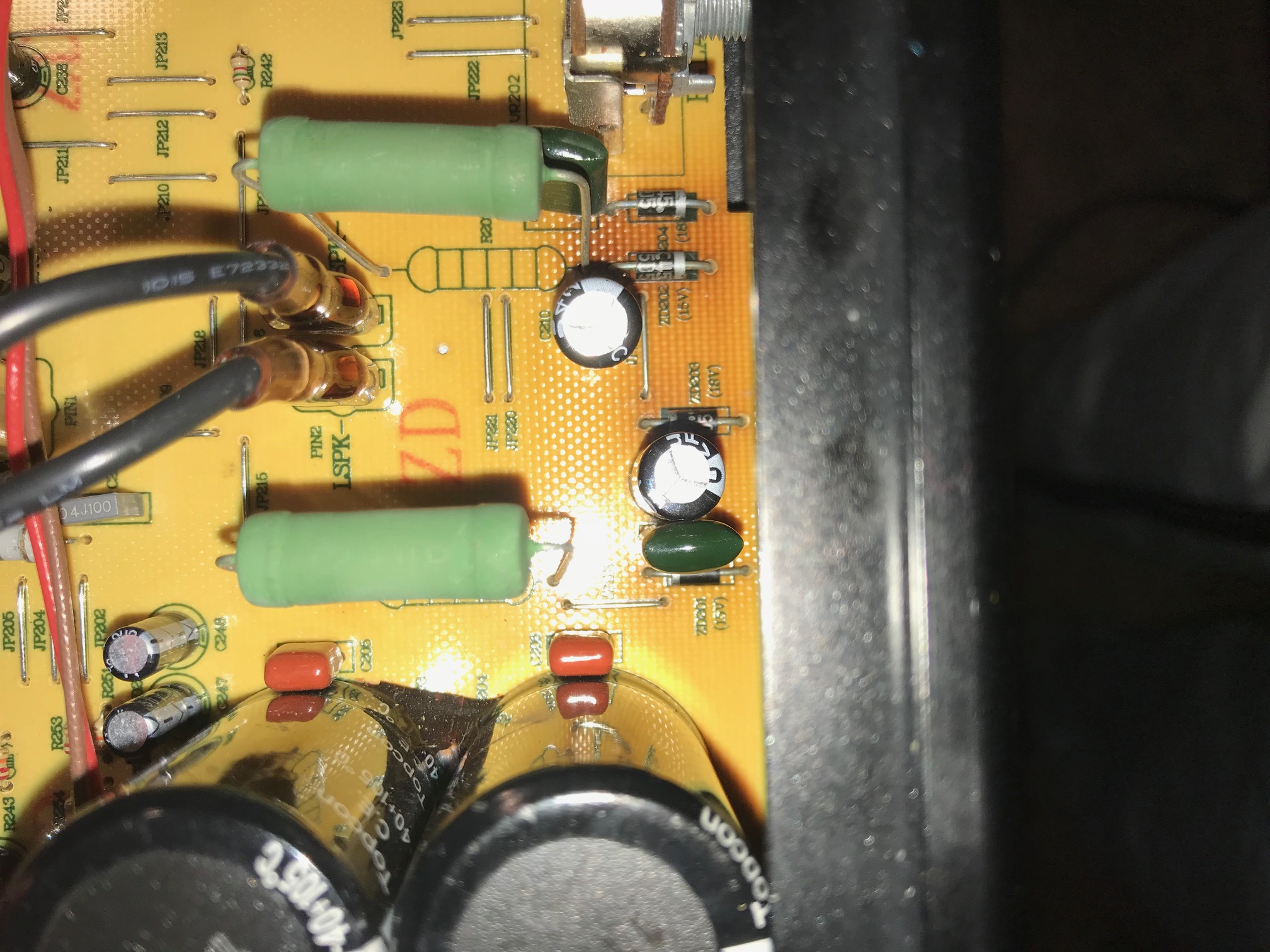

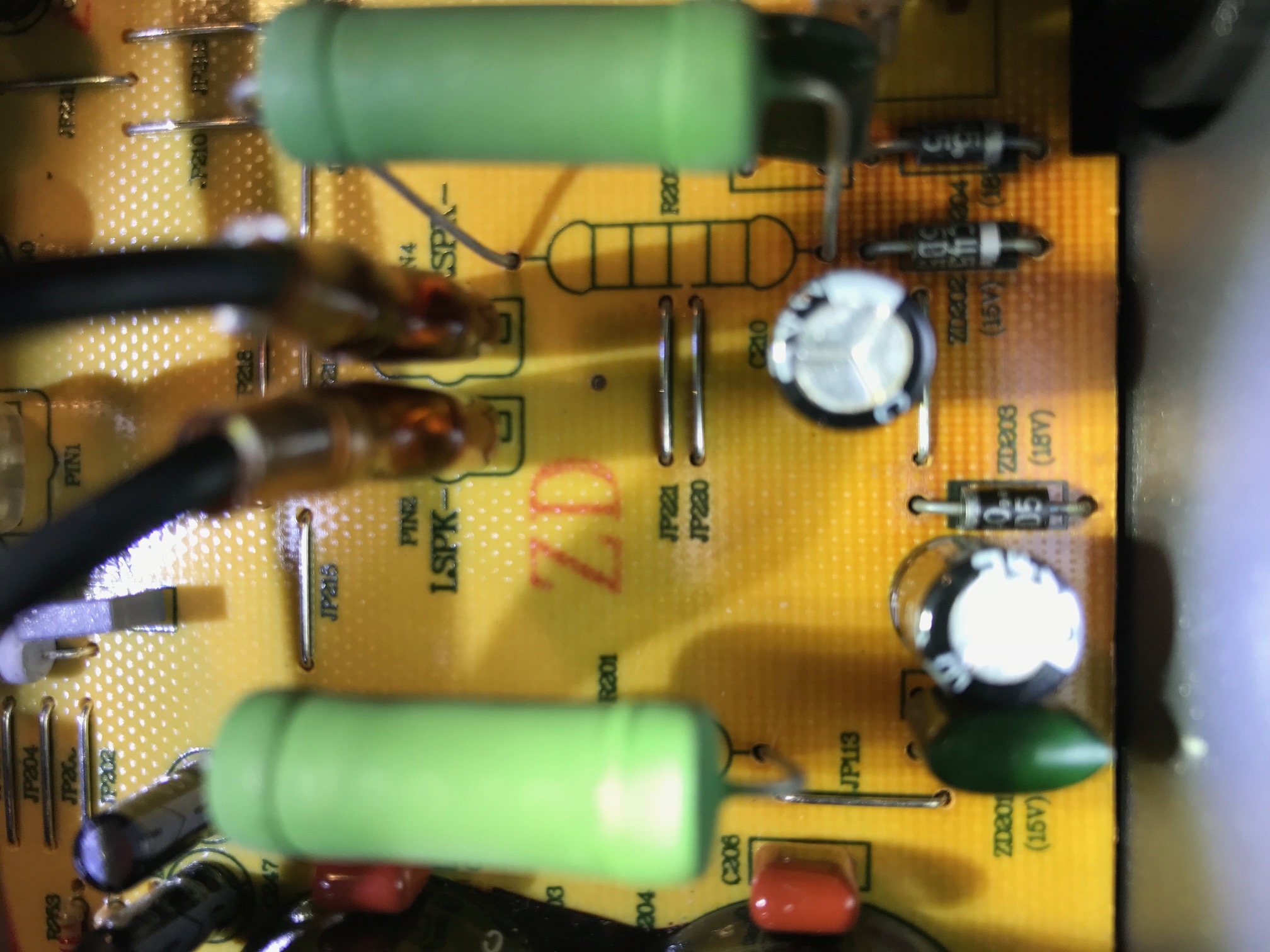

2) There are 4-zener diodes (2 marked 18V and 2 marked 15V - see pics) but all 4 are 15V zeners. Also appear to be 5W versions. The 2 on the positve side +VCC (ZD201 & ZD203) run at that same 130-140-degree F, where the -VCC ones run about 100-degrees (ZD202 & ZD204) after the same amount of time. The two caps between the zeners also measure hotter on the Positive side.

Designer used 5W parts because he *expects* them to dissipate close to that, certainly above 2 or 3W in normal operation.
Just did a little Math:
Don´t know your power rails but if they are +/-40V , each resistor is dissipating (40-15)squared/220: 2.8W ... right what I assumed.
If rails are higher they´ll dissipate more.
And any small part dissipating 3W or more will run HOT.

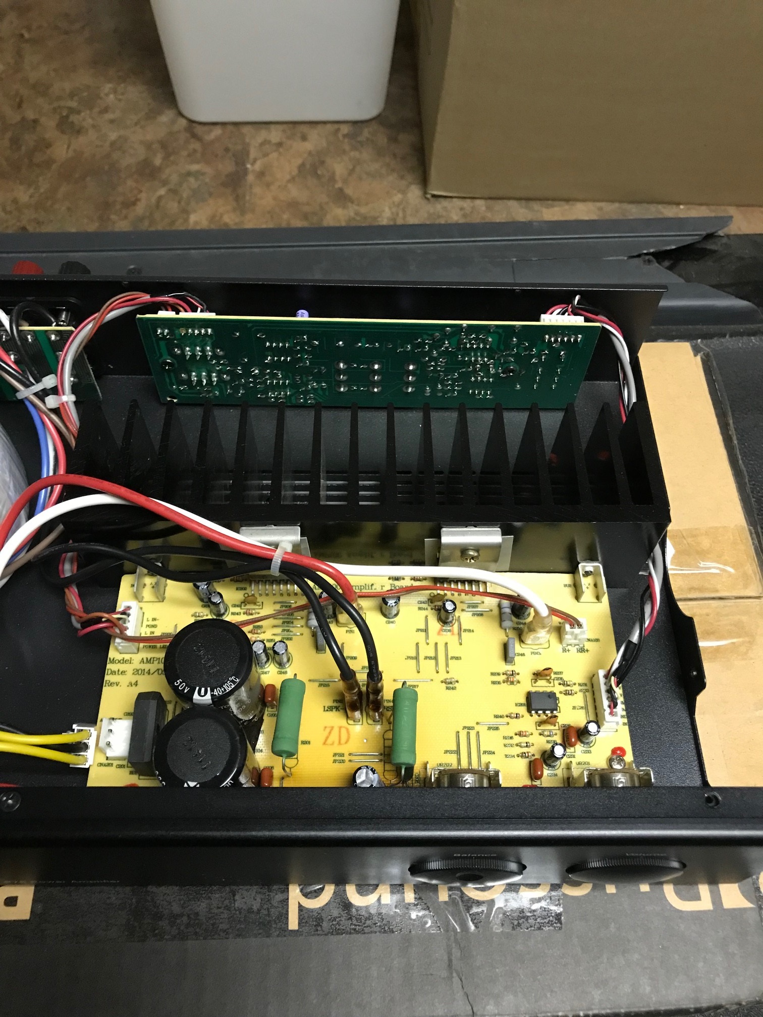

I don't think the 7294 problem wont be anything to with the hot resistors unless the y are very close to the 7294's.
Can you show a picture of the heatsink arrangement.
If the 7294's are burning up then it could be the heatsinks is too small.
The 7294 is fussy about layout and the feedback resistor needs to have as short a path as possible.
Also you musn't have too low a gain on the 7294, I think 22 is the minimum or the 7294 will become unstable and oscillate and burn up. Its worth looking for oscillation on the outputs.

Tried to post some better pictures, in case someone else needs them. You can't quite see all four of the zener diodes (very bottom edge of PCB, below the Green 5W resistor).
I also took some more "industry standard" temperature readings.
Ambient - 65F (18C)
Resistor Temps - +VCC 143F (60C), -VCC 130 (54C)
Rise of Ambient - 80F (27C), 65F (18C)
Similar for the 5W zener diodes, but they are charring the board, because they were not installed with any space between them and the board. Might be able to help that by installing new ones, but leaving them 2 mm off the board.
If I place an order - might just get 2 7W resistors to lower those temps a little too.
