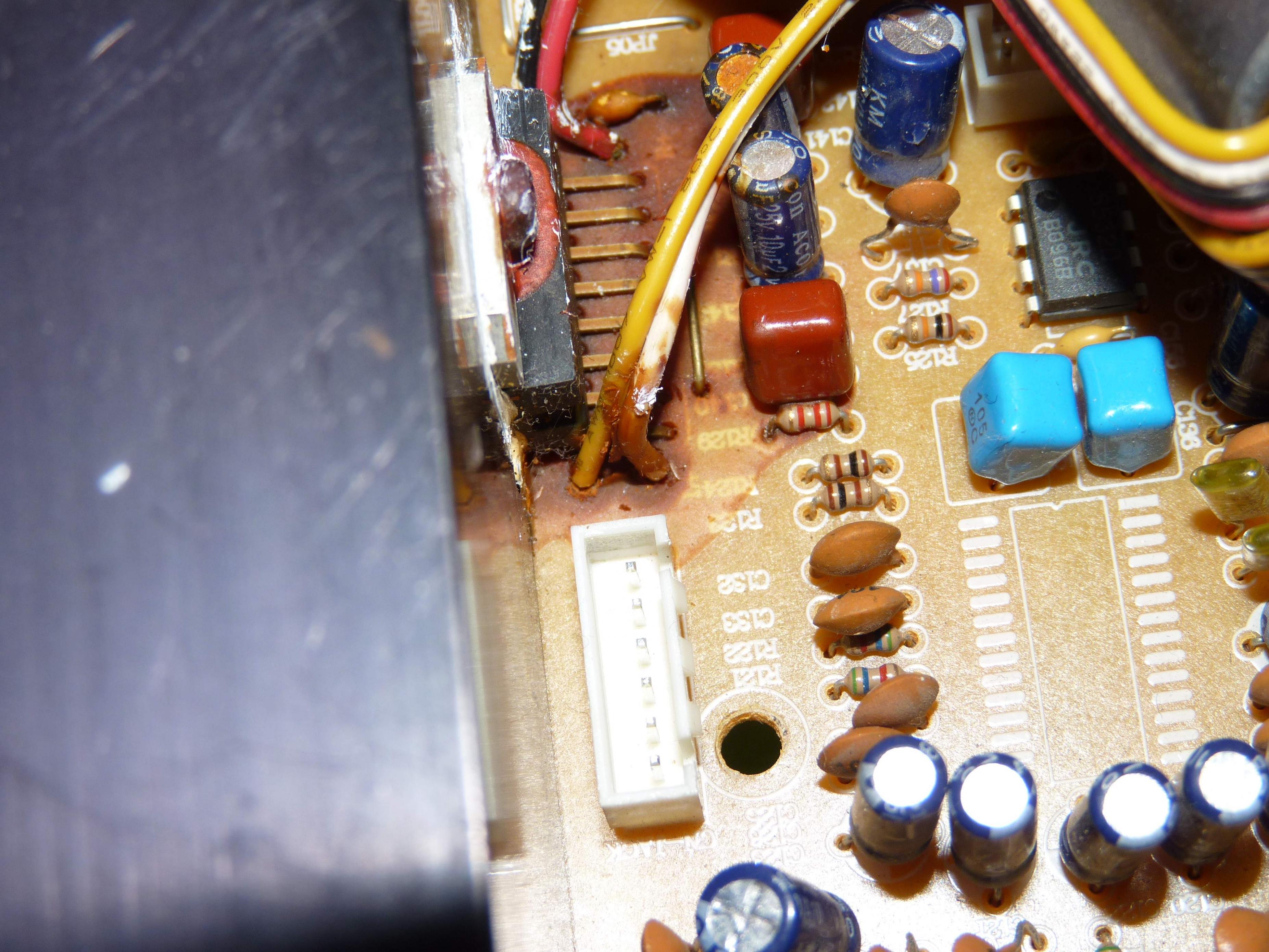

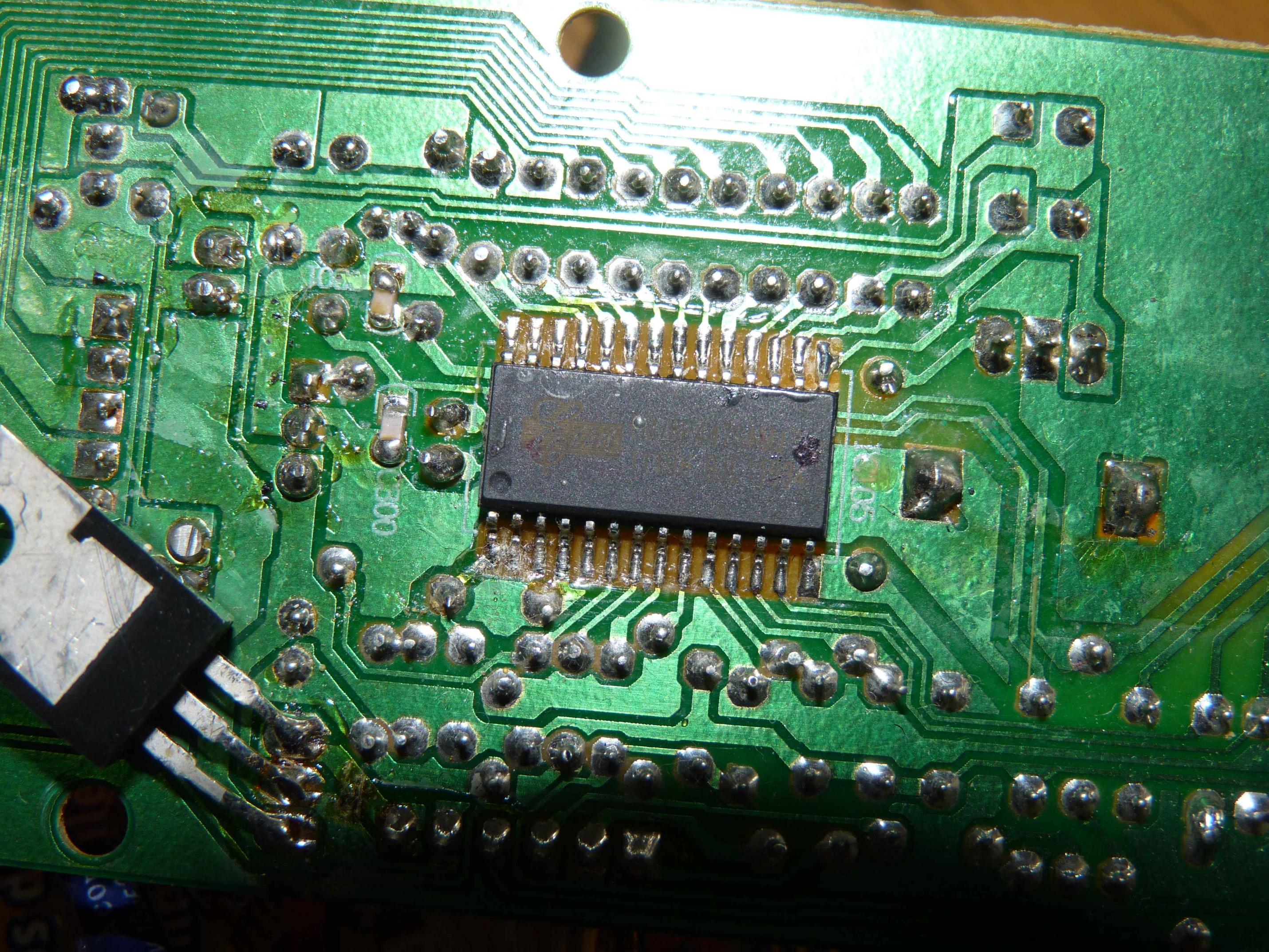

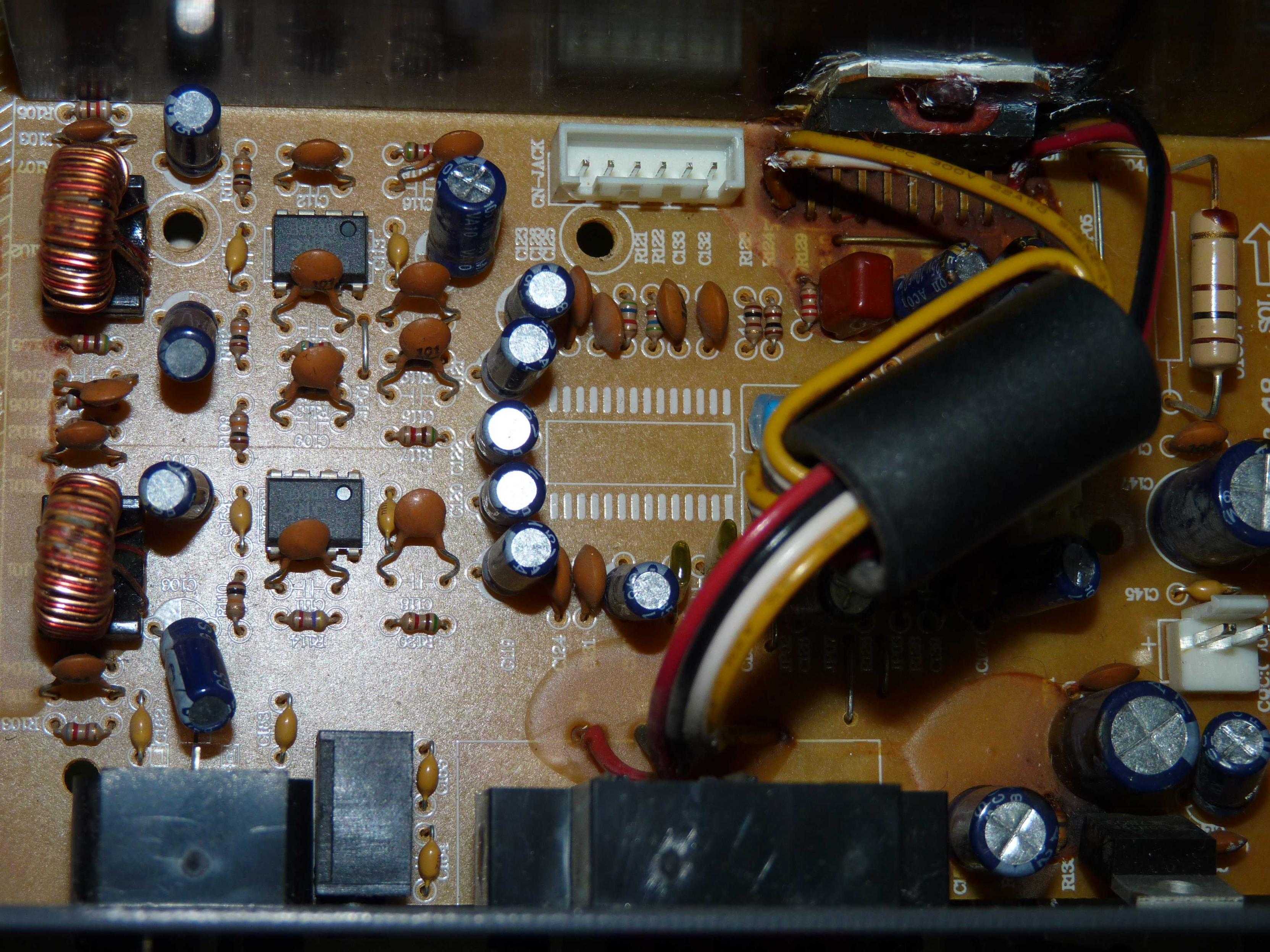

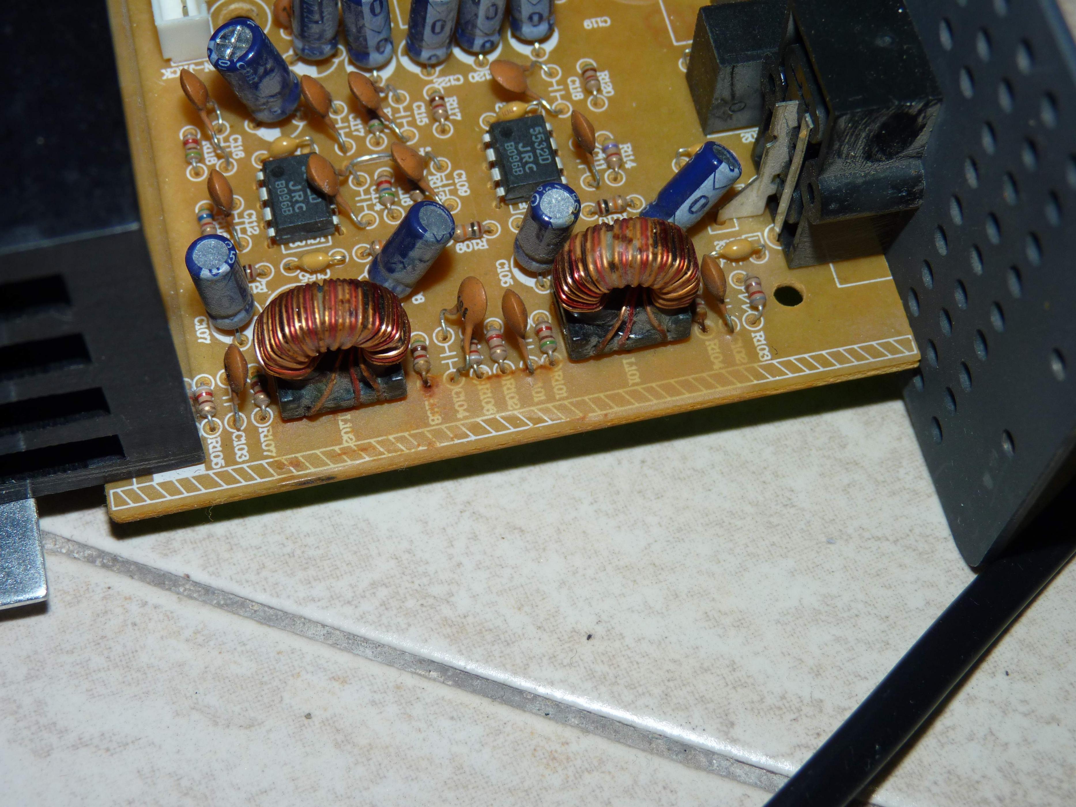

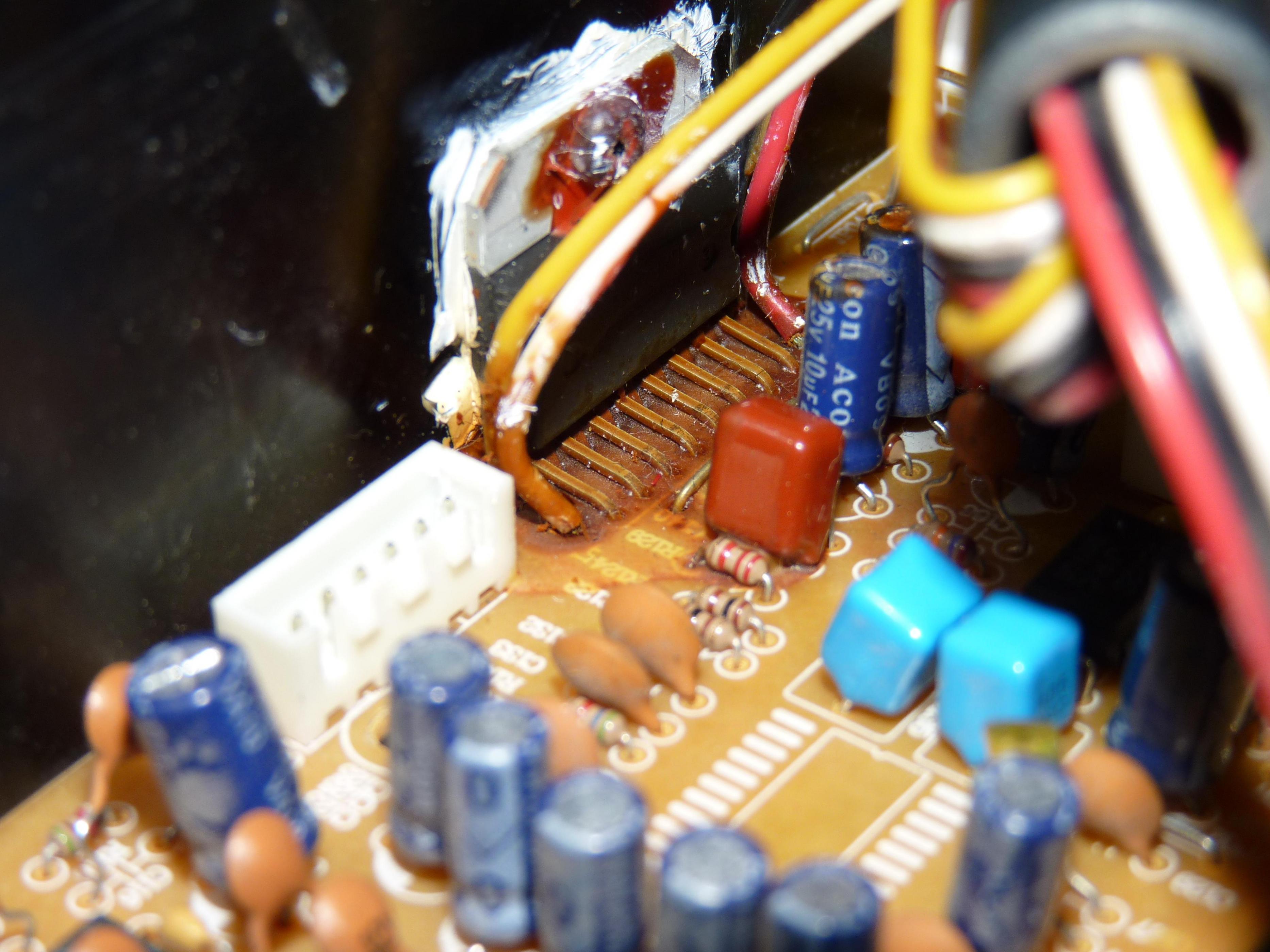

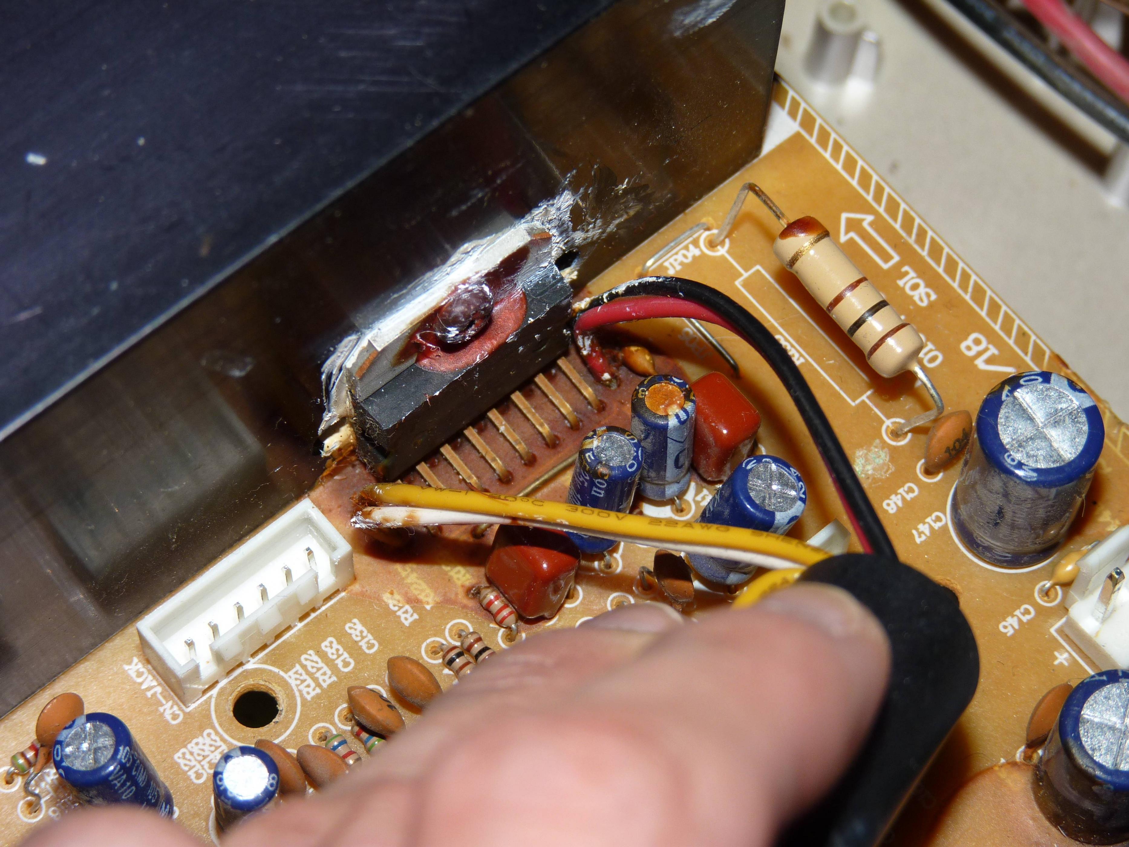

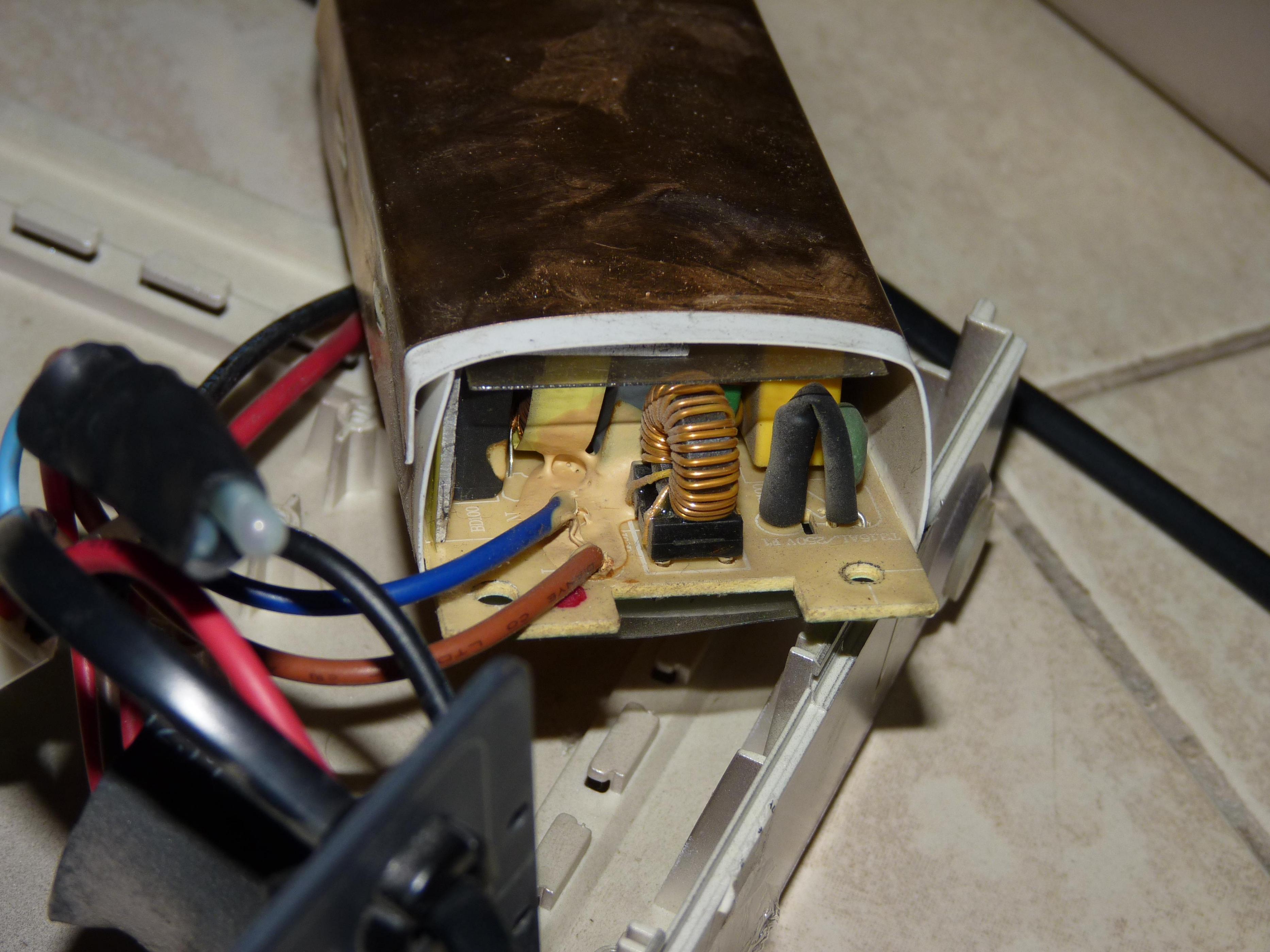

First some clarification: I'm not a technician (but I can solder and even made my own circuits time ago) and where I live sending amplifiers to fix cost so much money, and headaches, that you end up with the dilemma of doing that or just buying a working used one, if not a new one.

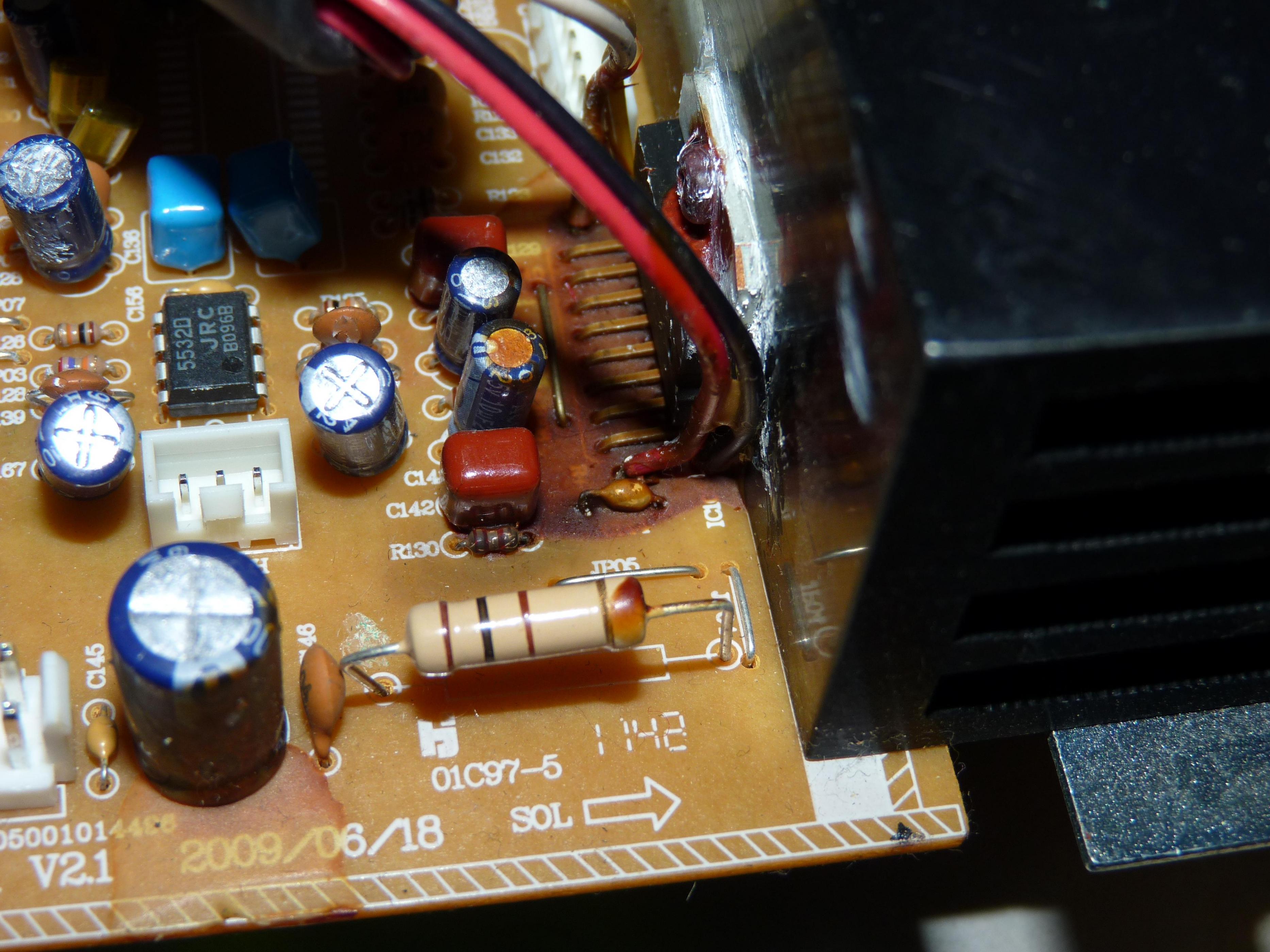

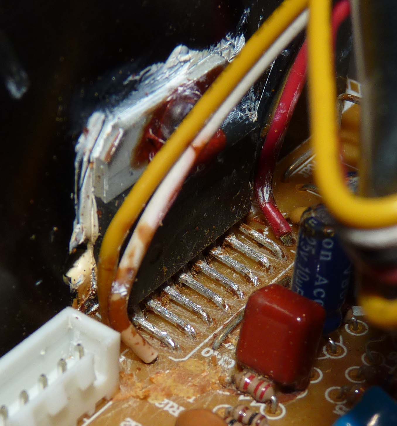

So, both me and my brother have Edifier C200, some very nice sounding "hi-fi" computer speakers. His, stopped working. Slowly dying, in the suddenly cut the sound more and more frequently fashion, until it didn't output any sound. He opened the amplifier unit and found a dead cockroach, not stuck but lying around, but still there's the possibility it short circuited the unit until it stopped working (?). You'll see the photos...
So, as inflation started moving again I went and bought a TDA7379 for replacement before the price rises.
First some pictures. I had to severely lower the quality of some. Notice the brown coloration or brown substance around the amplifier chip and other components. Look at the close up of the amplifier chip legs. There's a capacitor of unknow value (and type, to me) near the chip, that looks damaged (my digital tester doesn't measure capacitors, sadly).
Sorry for the order.
So, what do you think? Does the chip look damaged?

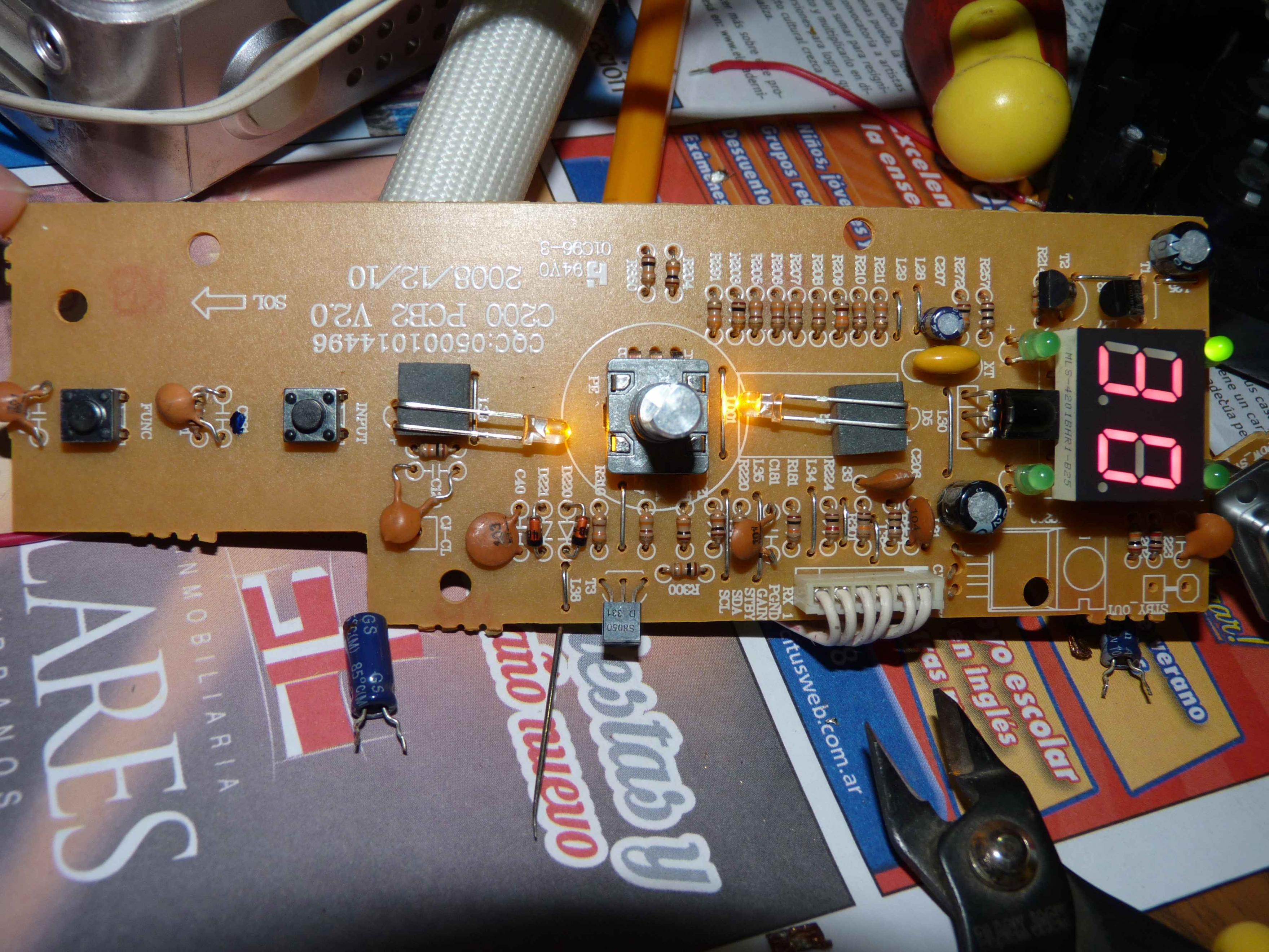

By the way, this model has an anti distortion dsp chip somewhere (maybe in the front digital panel) that can cause problems too.
Sorry for my english and thanks in advance!

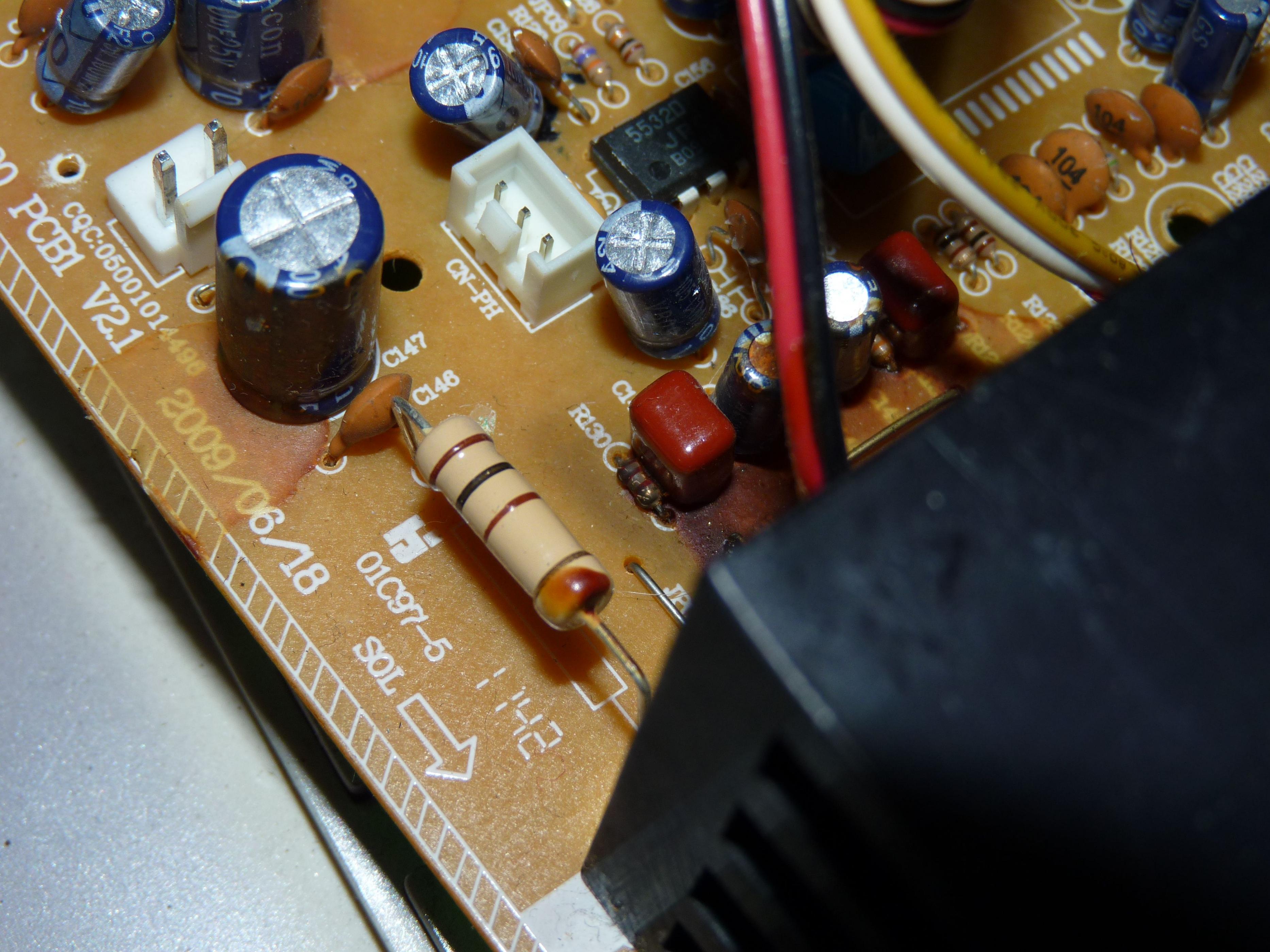

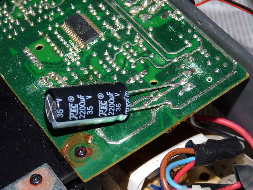

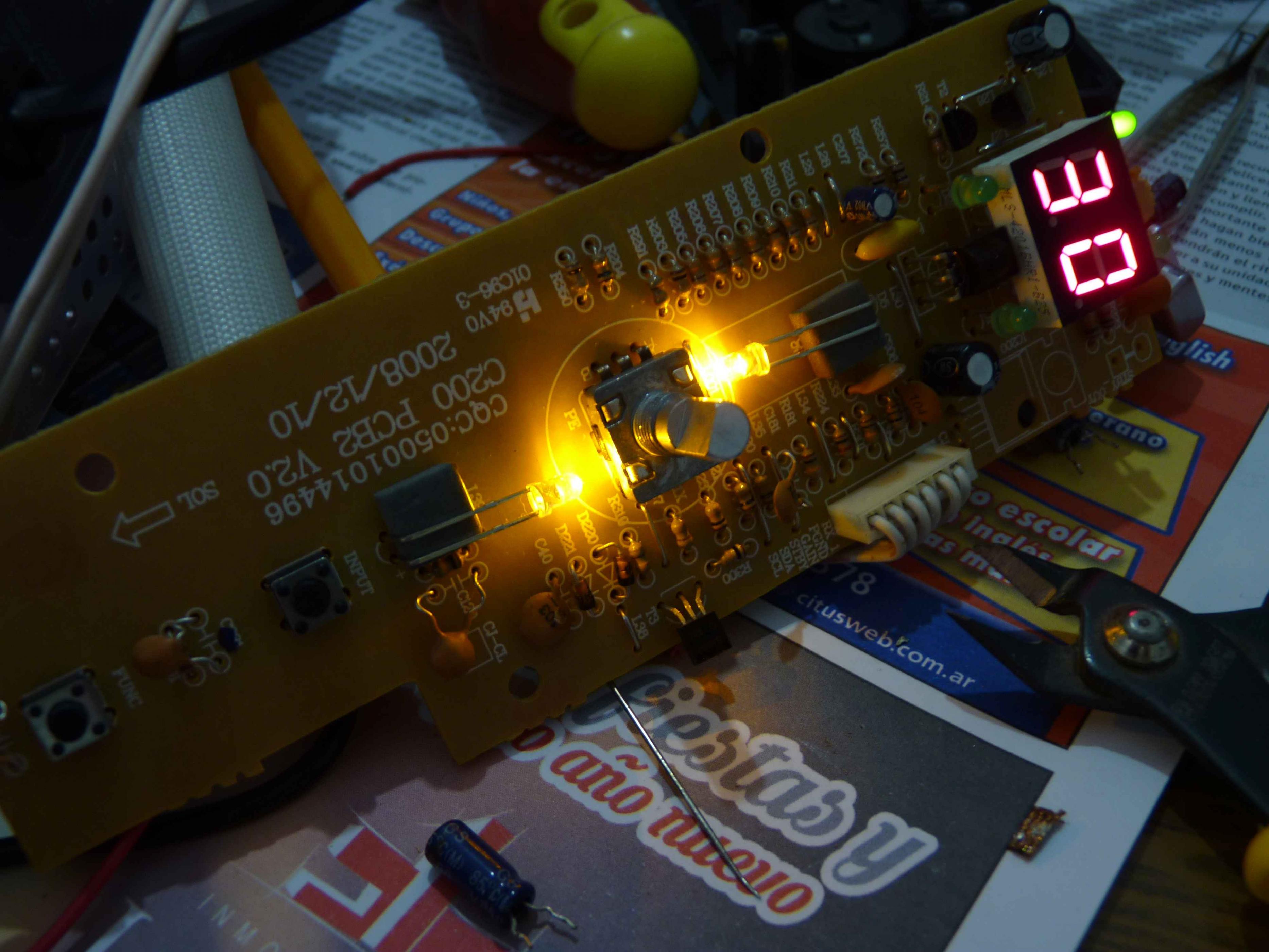

So I just moved cables, dissasembly the digital pcb in the front (not in the pictures) and touched those components that looked burned to see if the legs were fine and it ocurred me to see if it turns on. So I connected everything and it turns on...Ok...what will it do now if I try to use it...And it works!!! Hahaha! No idea what happened of course but is working...with an important caveat! I recorded through my phone with Whatsapp a message to my brother with the amp still connected to it and the audio came with a ground sound added to it. Then I connected to my C200 and it didn't do it. And one very important thing I forgot to mention before: when we first tested this amp in my house it destroyed my sound card, but we also used his kind of destroyed cable.
So what could cause this bad ground effect in the phone!? I wanted to test the amp so if it works I could return it to my brother but now I'm scared it will destroy my actual equipment if I do!
Advise please!!
Advise please!!

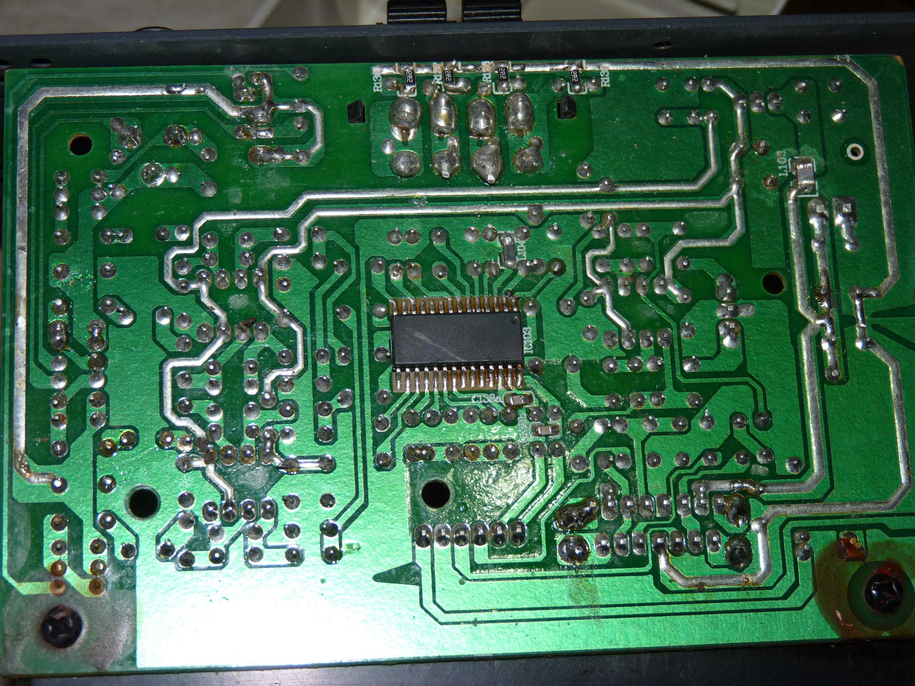

Well, cleaned the area around and below the TDA7379 past saturday but then I reassembled it and again stopped working. Opened it again and it worked and stopped while I flexed the board... searched for broken paths, cold soldering....nothing. Re-checked capacitors, all seem fine. Now only works with a very low volume and without bass. At first started sounding like that and distorted and then without distortion, as if all bass died. Tried the headphones output, that is driven by a 5532 and works fine (so the DSP TDA7303 that's used to modify bass and treble and maybe something else is fine). Repaired some cables...nothing. Today changed the two 10uF 25v and one 12k 1/8w resistor in front of the TDA7379...nothing!!
And by the way it doesn't respond to flexing and tapping anymore!
Is it the 7379 dead? What else could it be?

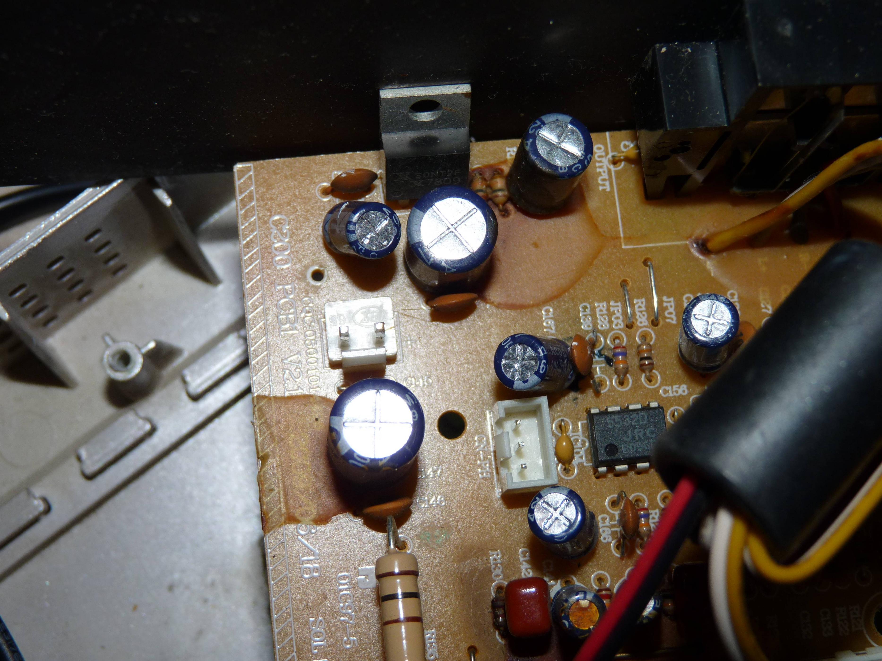

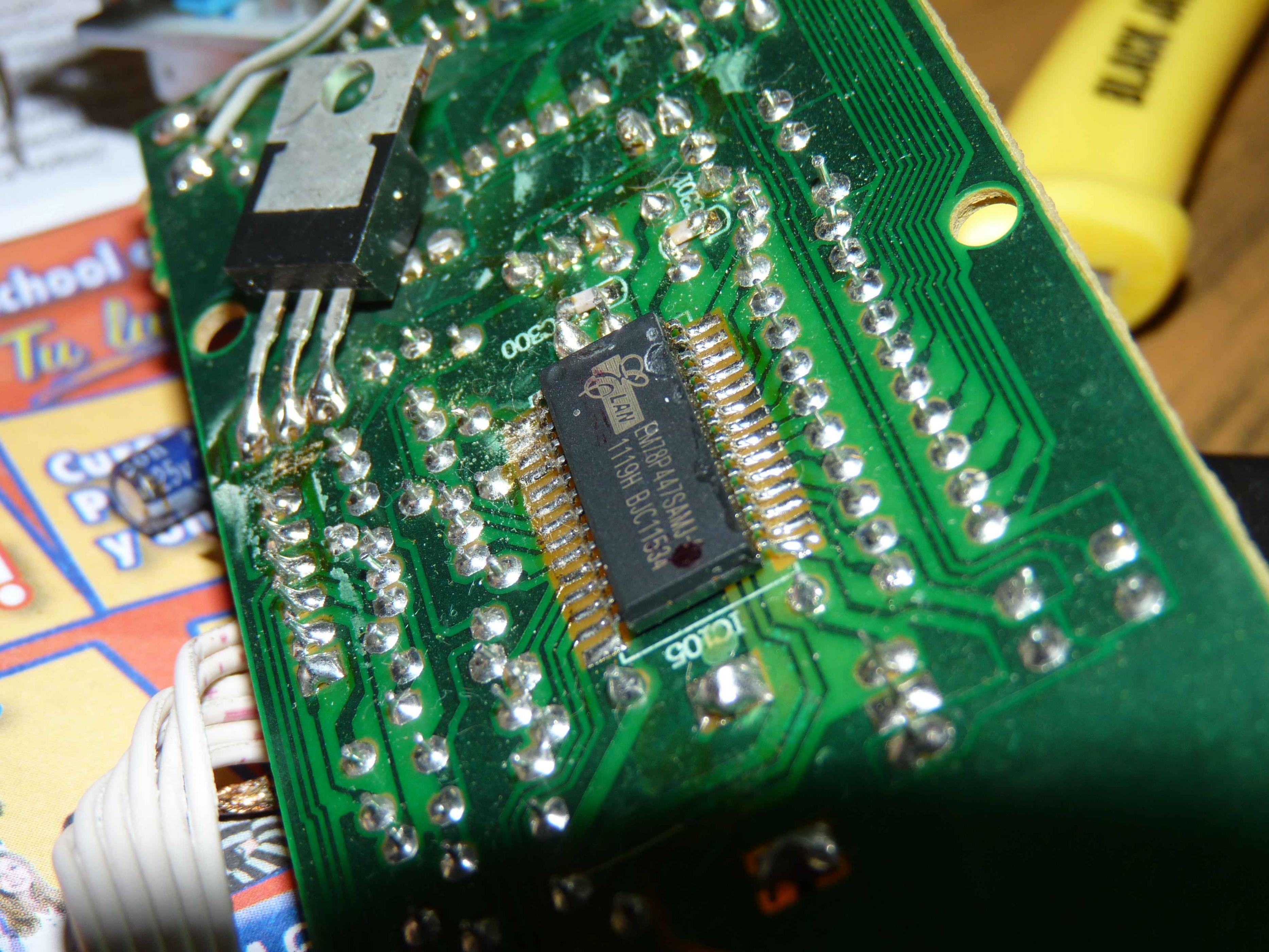

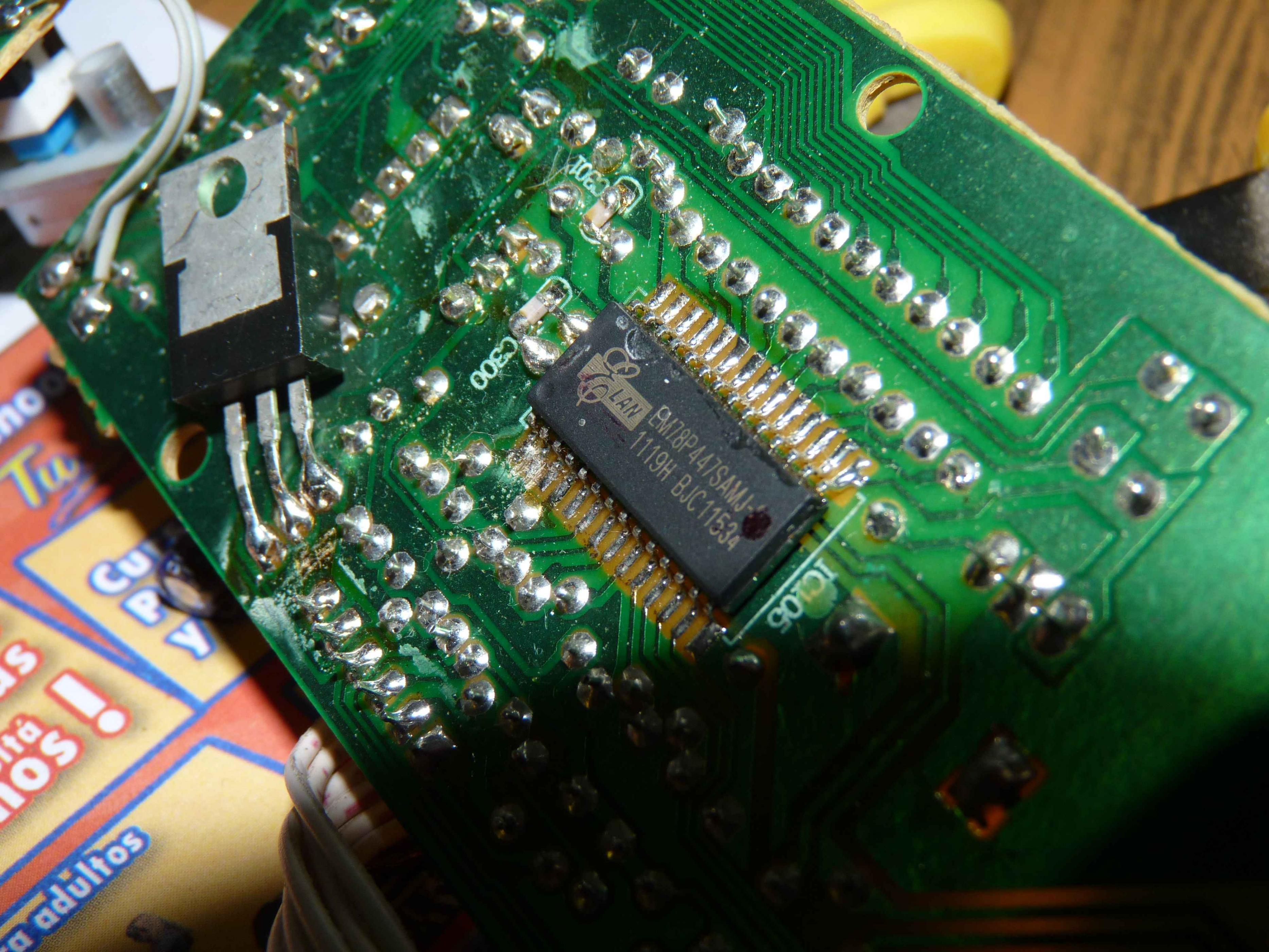

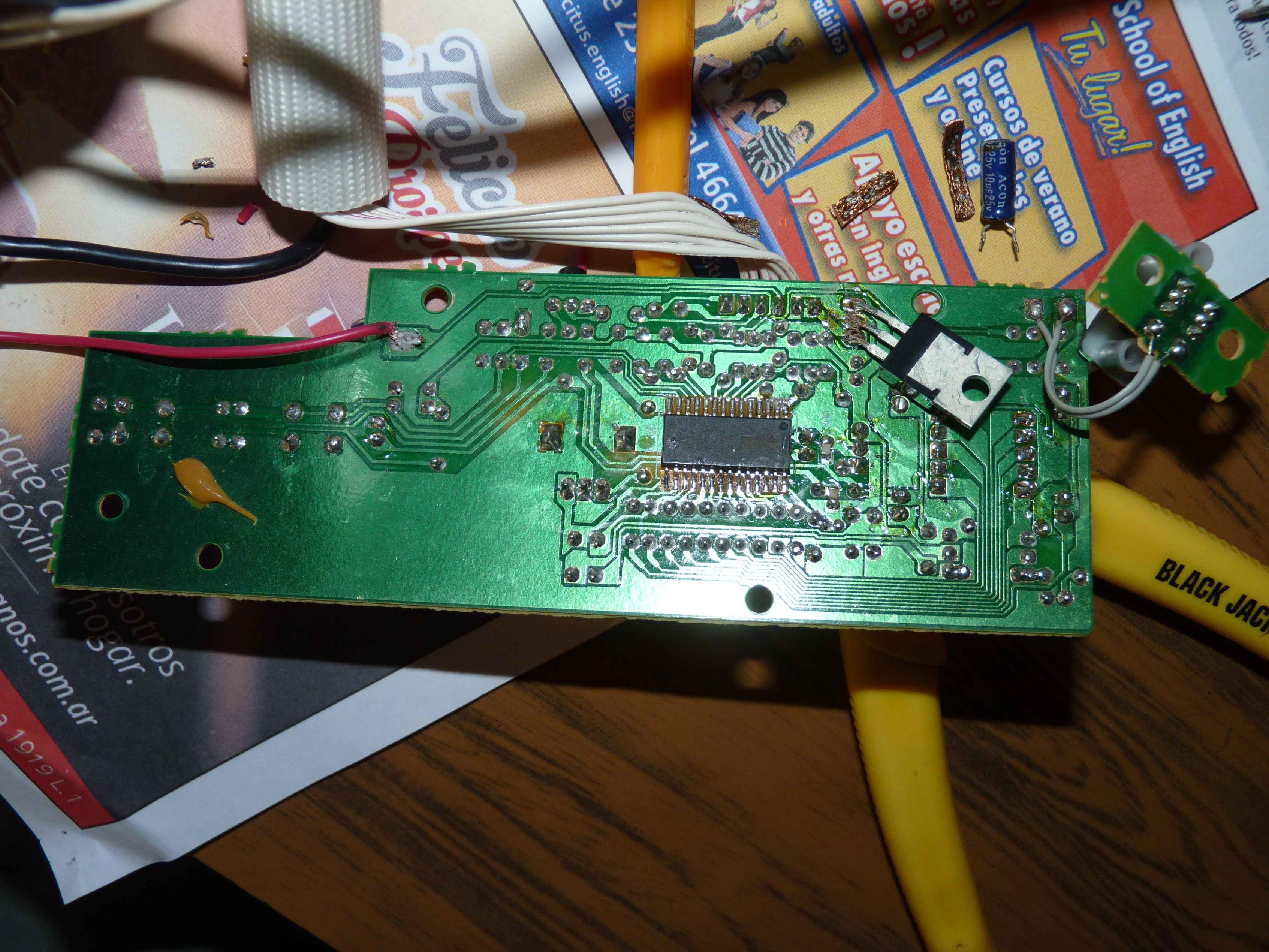

Add some photos of the "cleaning" (scratching) and of the front panel PCB. This is the datasheet of that microcontroller https://www.datasheets360.com/pdf/-1067356977218892900

If flexing the pcb makes it fail then its either a bad soldered joint or a broken track or dodgy connector somewhere.
I had an amplifier pcb mess around and it turned out to be a hair line crack in a pcb trace. It was very hard to see.
On another amplifier it worked when I twisted the pcb and I had simply missed soldering a joint.

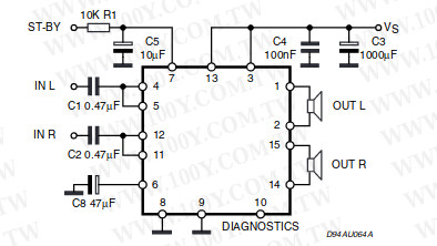

The fact that the headphones output is working means the signal chain upto that point is good. The TDA7379 is a fairly robust IC with extensive protections and simple circuitry, I am assuming its setup as a dual bridge amplifier, so before we assume the IC is defective could you do the following.
1. Check the output pins directly connect to the speaker (pin 1 and 2 to speaker 1), (pin 15 and 14 to speaker 2), you can do this step with the power off even.
2. Put power on and Check if the power supply to the IC is good using your mutimeter. Pin 13 and 3 should be the system positive voltage, while pin 8 and 9 should be ground potential (0 volts).
3. Check that the standby pin (Pin 7) voltage is greater than 1.5v
The brown residue is around the IC, which makes me suspicious if the IC could have encountered extreme heat which discoloured the board around it, or else a electrolytic capacitor nearby spilt its contents. The intermittent fault condition could be due to damaged PCB tracks or a faulty electrolytic capacitor.
Please do let us know the results of the tests. If everything else fails then replacing the TDA7379 might be considered as a last resort.

Yes I know but I spent a lot of time already searching for something and tested with the multimeter for bad connections and nothing! And not only that, but it stopped doing that, so something broke completely...Now it only has a faint trebly output...
Thanks for this!
I already thought of doing this and glad you told me how because I was in doubt on how to.
By the way I already tested the IC power the other day and it was ~15 volts in 3 and 13 (the amp is rated at 25watts per channel so I think that's good judging by the datasheet).
Yes I thought the same, but after all the rest...I don't know anymore. I am really thinking on that microcontroller as it seems to be not working properly.
I also already replaced the 2 nearest capacitors and a resistor but no changes. And they all look fine, only stained with the brown thing.
Ok I'm going to do now what you said.
Pin 7: 2.68 V
Pin 3 and 13: 15.2 V
And about the output pins I tested with the power on as I didn't see the point of doing it with the power off, so maybe I am totally misunderstanding the test type, and the result is the same as with the normal exit points: faint trebly sound.
Also tested the voltage of the outputs and it is 1=7.3v, 14=7.7v and 2 and 15=8v. This with music source on and off which wasn phone disconnected and phone connected with music on.
Pin 7: 2.68 V
The voltage to the pins seem to be ok so far. The V+ is correct and the bridged output's are near half the voltage. Could you verify that pins 8 and 9 are zero volts, ie connected to the ground.
what happens when you touch pins 4 and 5 (one channel), and pins 12 and 11 (other channel), they are the inputs to the each amplifier and you should get a hum from the speakers if the IC is amplifying ok.

I forgot to test 8 and 9!!
Ok I made several readings at diffrerent times, connecting and disconnecting the amp from the grid. At first it jumps, but then:
8=0.06-0.07mV using the PS as ground
And 9 goes from 4.4 to 4.5 mV (I put the multimeter in "2000m" and gives me 004-005, and in "200m" 04.4-04.5) But depending where I touch the ground: if I touch it from the amplifier's power supply it gives me that reading, but if I use pin 8 it gives me 03.8mV, which of course makes sense since pin 8 is 0.07mV (?).
Also in between the reading is 04.2mV
Just above is a 1000uF 25v electrolytic capacitor that is all stained, surely in perfect conditions like the rest, and a ceramic one (couldn't see the value). But I don't have a capacitor that value lying around right now. I have a 2200uF 35v but I don't think it will fit there and of course I'm not sure it will be good, but as I'm almost sure it's a smoothing capacitor...
Also there's the big 11/2 or 1W resistor 100 Ohms.
Picture of all this:
![P1200722blep.jpg P1200722blep.jpg](https://www.diyaudio.com/community/data/attachments/682/682180-71fa3c26ddadc8439808f0102ea0943d.jpg)
Then pins 4, 5, 11 and 12 gives me hum...a trebly one haha.
What gets me is how it responded to bending the board and now it doesn't (I could guess something broke completely but I can't find where, I tested! I will test more anyway) and how it went from a faint sound and distorted if I increased the bass (through the amplifier's tone control) and now it doesn't since I touched some TDA7303 pin (the chip below) (now I remember I did that, idiot me again), but as I said with the headphones it's working okay, and I guess is the same DPS for both outputs...!
