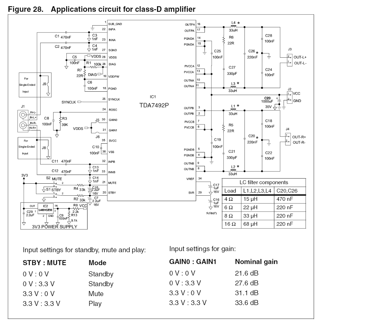

Having been a big TPA3316D2 user and fan for over 2 years now, I am just starting to use the very low-cost TDA7492 amp boards available from China. I recently bought a pair from Aliexpress for about $8 ea shipping included. They arrived in a few weeks and I have since set them up, and even started modifying them in a way similar to the TPA3116D2 with regards to power rail caps and snubbers. I think this amp deserves its own thread to keep the 3116 thread on topic...

Here is how I added 330pF and 10R snubbers to the input side of the inductors, basically same location where the "bootstrap" snubbers would go on the 3116. Note that the TDA7492 does not have external bootstap caps.

Here is the datasheet suggested schematic:
Here are the datasheet pinouts:

Just curious, is there any special reason that you used 10R for the snubber instead of 22R? Thanks!
The snubber used on the input of the inductor for the TPA3116 was 330pF and 10R. I just used same one because that was what I had on hand. I don't even know if it is right for the 7492. It does seem to have similar values for the inductor and output capacitor values.
Do you see 22R used somewhere? Oh I see what you are saying as there is a 330pF and 22R connecting the two inductor inputs together. I don't know if that is a snubber as it doesn't go to ground - just between the positive and negative legs.

If the chip's running hot, I'd firstly look at the output inductors - perhaps they're too lossy at the switching frequency. Certainly they look rather small ones.....
Yes. You are right. This part is absent in the TPS3116 schematic. In the TPA3116, there are pins from the chip (BSNX) that are specifically for connecting to a snubber, that I do not see in the TPA chip. Anyway, comparing the schematics side by side, it seems that the out filter sections of the two chips are different. I need to look up the TI paper on Class D amp output filter design to get more details.
