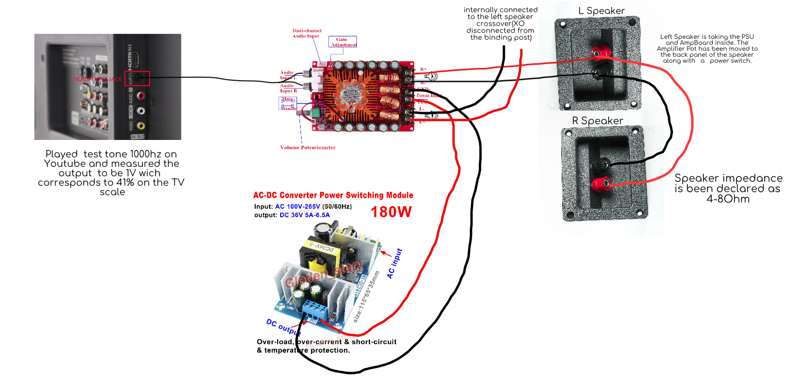

I am trying to build a garden low-cost active speakers so I ordered amplifier board TDA7498e(burned the first), power supply 36v 5A, and Mohr SL10 Speakers connected as the diagram shows below:
So far so good. The thing I don't understand is why the above-mentioned board plays much weaker than a vintage Pioneer SA 508 amp which is rated at 25w per channel at 4Ohms.

As Mark says, the sound level you get primarily depends on the gain. The gain in the power amplifier but also in the pre-amplifier and the output level of the source.
A small warning: I have a red TDA7498E board (the same as you show) I have been using with a 31V supply. Recently I got a 36V/7A supply and tried the two together. It played well for a couple of minutes and then the amplifier became silent. No smoke, no noise just became quiet. My conclusion is not to use that board at 36V though it should be able to handle 36V. If you can, adjust the voltage a bit down.
For your circuit diagram I have a few concerns unless you have used jumpers for the board to be in PBTL-mode (mono).
On one channel you have two 4-8 Ohm speakers in parallel which means a resulting speaker impedance down to 2 Ohm. 2 Ohm speakers is only for PBTL-coupling.
The other channel is unloaded which is OK for PBTL-mode but NOT for stereo mode.

Hi FauxFrench,
My drawing is a bit confusing. I will try to explain the connections I have done.
The amp is inside of the left speaker and the left channel of the amp is going straight to the "crossover"(only 1 capacitor and inductor highpass filter) of the Left speaker which is been desoldered from the terminal plate so I am only using that plate as an extension of the right channel to the right speaker. So eventually you get left channel ->left speaker, right channel -> right speaker
As far as the input signal of the Tv preamplifier, what I've done is play a 1Khz tone on youtube and adjusted the volume until multimeter shows 1V which corresponds to 41% volume on the TV scale.

Please note that someone had tested the speakers and they go as low as 3.3-3.5 Ohm most of the time.

OK, left amplifier channel is to the left speaker and right amplifier channel is to the right speaker? For a class D amplifier, the speaker serves to dampen the output filter resonance and should be permanently connected. Speakers on all outputs!

I have 24V and 36V power supplies similar to the one you show.
I have looked at them with the hope to tell you how to reduce the output voltage to around 32V. Unfortunately, the type of the controller IC has been grind off. However, for one of the ICs (in a 24V supply) they forgot to grind it off. It is a ON-Semiconductor "1200P60" low-power fly-back controller. As the IC is low-power and the board output considerably higher, power transistors have been added to handle higher currents. Without a circuit diagram I cannot tell you how to adjust the output voltage. In principle the board should handle 36V. I just have a bad experience.
2. Or use different amp board (witch) with power supply. Please note that someone had tested the speakers and they go as low as 3.3-3.5 Ohm most of the time.
The amplifier as such is fine. 3-3.5 Ohm is rather low and I will suggest you a 24V power supply instead. Cheap and standard. For the same TDA7498E board.

additionally to FF statement i want to add that the decoupling caps 12x 470µ/50V are fake...in this thread i was sure that the size is not correct ot have this voltage/or capacity.....https://www.diyaudio.com/forums/class-d/265387-ebay-cheap-tda7498-boards-41.html#post5288369
so it would be better to keep the voltage lower than 35V

Thanks for your input chermann, it is much appreciated. Since I will be switching PSU to 24V I would think the fake capacitor would be in the safe zone you recommended "lower than 35V"

A comment on "fake" electrolytic capacitors. I am a bad example to other as I buy cheap capacitors from where I am warned. I have only once seen 25V rated capacitors blow-off at 24V with moderate ripple. Only allowing up to 75% of the rated voltage, I have never seen any other capacitors self-destroy. I actually build a capacitance tester for testing all my bigger decoupling capacitors (quite a lot - old, new "fake", reused items, quality brand items etc.). All capacitors were within +/-25% of the stated capacitance, most far closer. All passed a half-voltage leakage test, almost all a full voltage test. A few (possibly fake) I considered should be rated 10%-20% below the actual voltage rating though the original specs are very wide for leakage current. The eldest capacitor was a 2x13000uF picked-out from a 50 year old Marantz 1050D. It passed all tests.
Your 470uF/50V Sanyo capacitors (2x6) will do fine even at 40V. Is there no downsides from "fake" capacitors? Yes - probably on long term life (reliability) and ESR. Thus, less (indirect) performance but no "destroying the gear".

I chose my TDA7498E board for test of the new 36V power supply because I did not want to use my reworked TPA3255 board. The power supply had been tested with a power resistor for a start but I needed to check how it would work in practice with an amplifier. For some minutes where it played really well without noise or humm, it was a success. Then, the amplifier board stopped and I had to carry-on with the TPA3255 board anyway (also worked well).
I tested (Ohm-meter) the TDA7498E board for short-circuits in the chip output/power and all seem fine. Then, I removed the heatsink and realized that quite some components were hidden underneath. The TDA7498E chip is very small and most of us will not like to change it. A 272 based circuit (probably input buffer), an XL4001 based circuit (voltage regulator) and some more. Something may have stopped working here though the board should operate at 36V. One day I will have to draw-up the schematic to be able to find the defect and I will post the schematic on this forum.
Like you, I am aware that playing around with such cheap electronics will leave faults. For Eastern electronics there are designers, producers and traders but the communication between the three groups may be very sparse. As we know, Chris found out (among other) that the voltage regulator on the TPA3255 board is a 40V version though the seller promises 50V supply. Lack of communication. Could a similar communication mistake have happened for the TDA7498E board? At least yours work at 36V. I will check mine one day.
The 36V power supply I tested is a 220W “big brother” (or sister?) of the 180W board shown. A somewhat bigger transformer, an epoxy-coated control-module but else clearly from the same family. It apparently works well even with 10000uF at the output.
The 45V for the TDA7498E is "Absolute Maximum Ratings" (operational/non-operational?). Recommended operational voltage is maximum 39V. Anyway, you are right that there is a voltage margin.
The 24V supply I suggested for 3-3.5 Ohm speakers is due to peak currents of about 8 amp. The datasheet promises current limits of 11A (typ.) but the TDA7498E is known to be at risk when taken to the limit. Therefore, I suggested to use a 24V standard supply.
